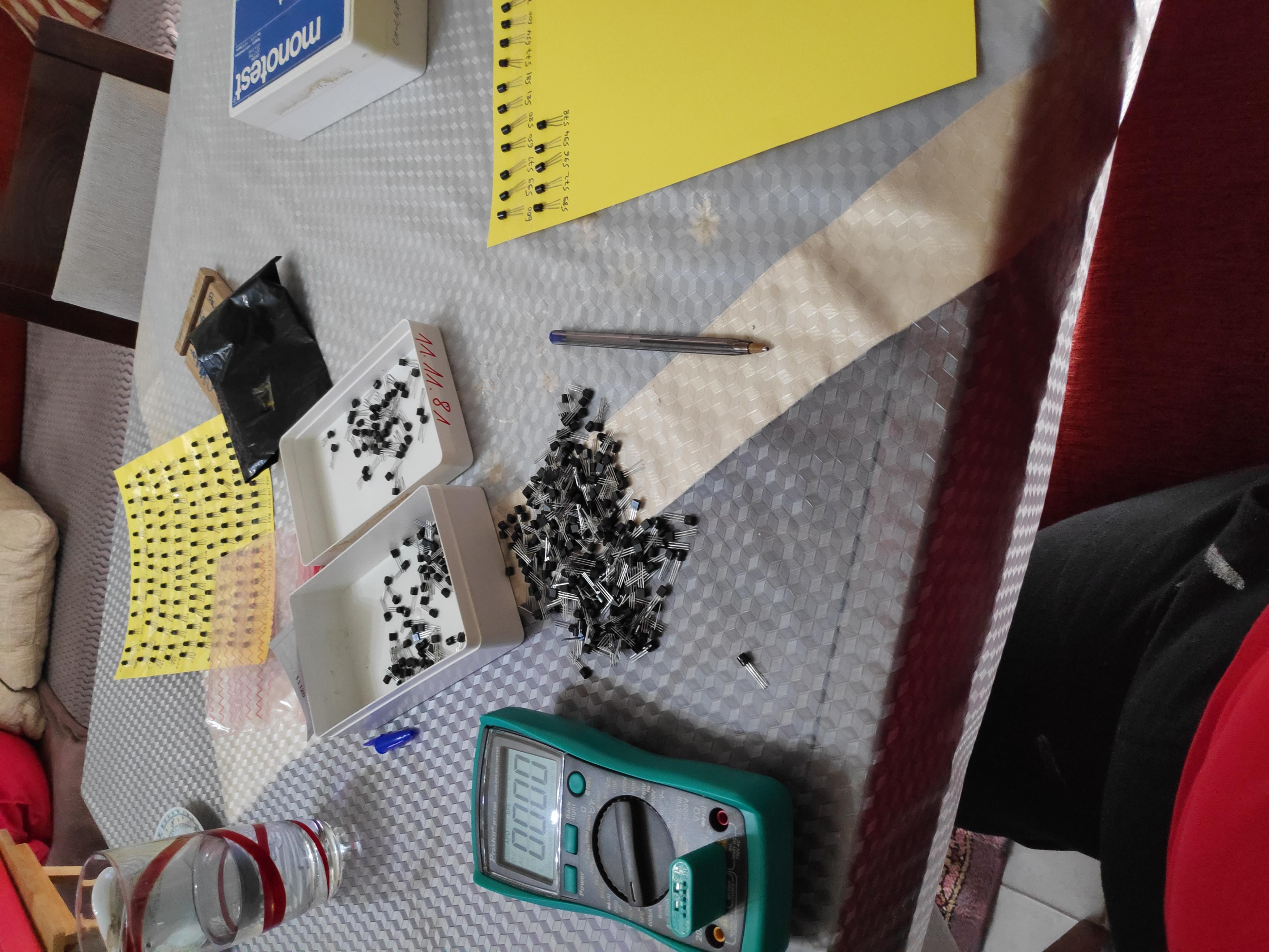

Oh yeah please go ahead, I just went as per the manual which I think says check the hFe value and use the highest on some position which I do not remember exactly 🙂
Oracle1
You do not have enough BCs....😉
Manual section 8.5.2.1:
Place higher HFE transistors in Q1 and Q2 position;
Match Q1 with Q2 (<= 30%)
Match Q3 with Q4 (<=50%);
Feel free to do better match but the match is optional anyway...
