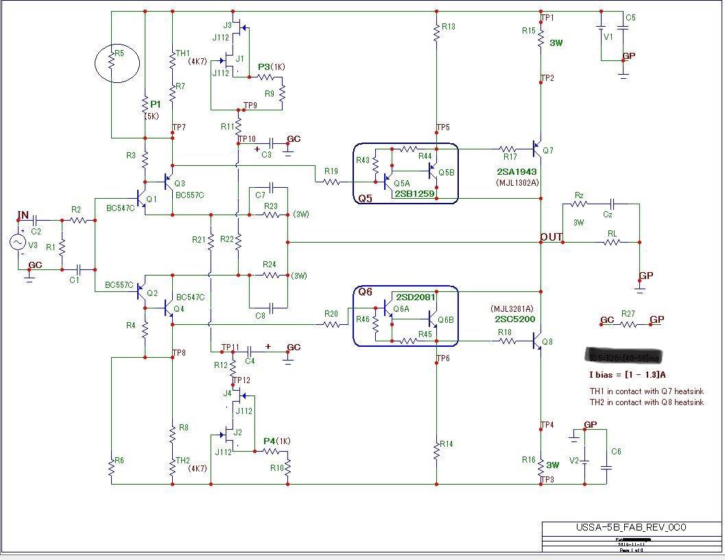

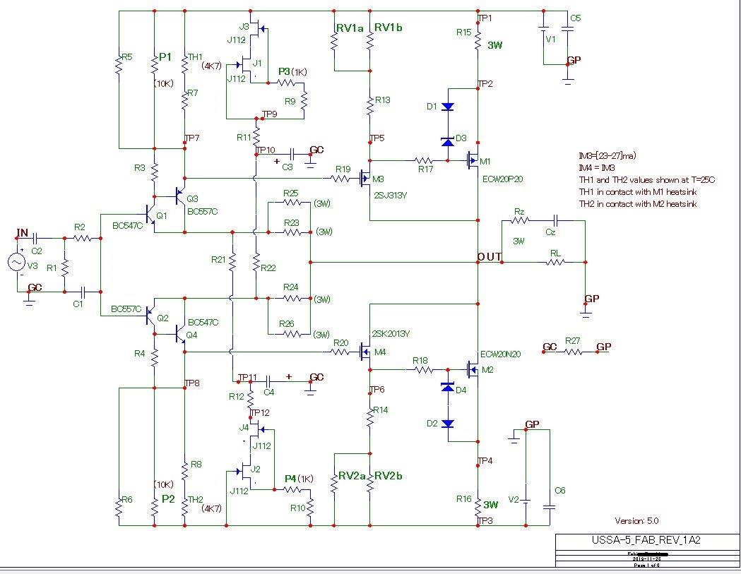

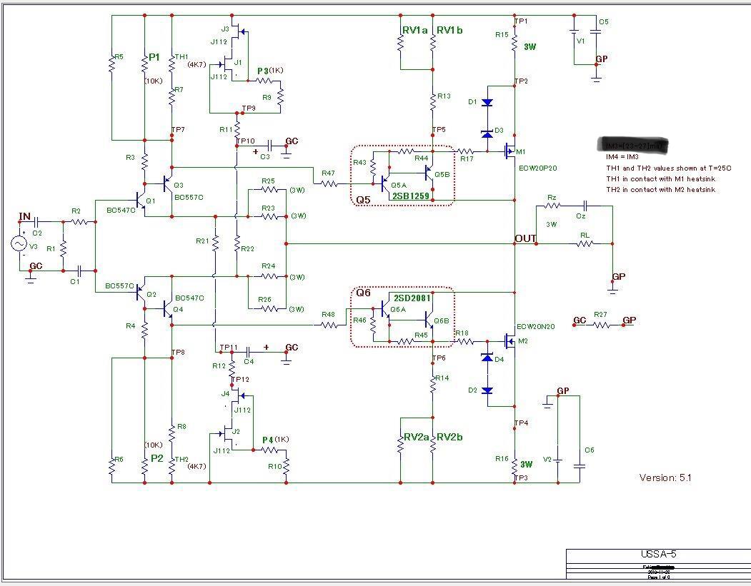

Differences between USSA5 versions
See below the 3 schematics for the USSA5 versions:

The objective was to have the 3 amps to have the same following characteristics:
1) same voltage gain
2) about same feedback factor
3) about same damping factor
4) about same THD profile
Note that USSA5B can be adjusted for a little higher feedback factor thus higher damping factor and even lower THD ( if that matters). This is similar to my old USSAB amplifier. Sound wise I prefer my actual recipe...
Fab
USSA5.1 had only one channel assembled due to lack of pcbs. Meanie and a Vunce who had both built the original USSA5 are volunteers to also build the USSA5.1 which is very Diy spirit 🙂
Recently I have found 2 Proto pcb with lower quality I did not remember I had which allowed me to experiment with the USSA5B. The USSA5B design has been adjusted yesterday to meet the criterias I have mentioned previously but modules tested on my bench still not installed in power amp to play music. I am working on it.
But as I said, the goal of the 3 versions is to have a similar sound signature. Based on my experience with that topology I expect the USSA5.1 to sound similar to the USSA5. The USSA5B should be more different with bipolar outputs.
The goal of USSA5.1 is to have a lower cost amp with no difficult to find matched mosfet drivers. The goal of the USSA5B is to reduce further the cost. However, as a reminder, the USSA5 pcb is not meant for the bipolar output pin out thus require connection inversion.
To continue the story, the USSA5 goal was to have a bipolar input compared to higher cost jfet input of the USSA3 and also have a higher damping factor.
To complete the story, the goal of the USSA3 was to use lateral mosfet as output compared to vertical mosfet of the PASS F5. I prefer the sound of lateral mosfet over the vertical mosfet - at least up to what I have heard so far 🙄
The sound of USSA is quite different from an F5. Pass upgraded the F5 amp design to Lateral mosfet with the F7 but the latter needs positive feedback to achieve a proper damping factor. Positive feedback can be more difficult to implement but some members seem to have succeeded in the PASS forum. I believe the F7 schematics is not disclosed by PASS at this time.
Fab

Hi Fab,
Did a quick check on Mouser on the Q5,6 (2SB1259, 2SD2081), which turns out not available. Are these pair your final parts for USSA5.1?

Hi Gary
The manual can be used as-is for the USSA5 (I mean the full manual version) since we all know that the output mosfet are Exicon instead of Alfet.
I will update the manual for version 5.1 most probably by adding an addendum during next week. For version 5B it will be later since I prioritize to test this version in a sound system.
Fab
Fab, you have good memories
I just gathered 4 pairs of driver Mosfets and 8 pairs of the output Mosfets .
As the latest 5.1 can use Darlington transistors to drive the output Mosfets, I will try assembly them in the Christmas Holiday.
