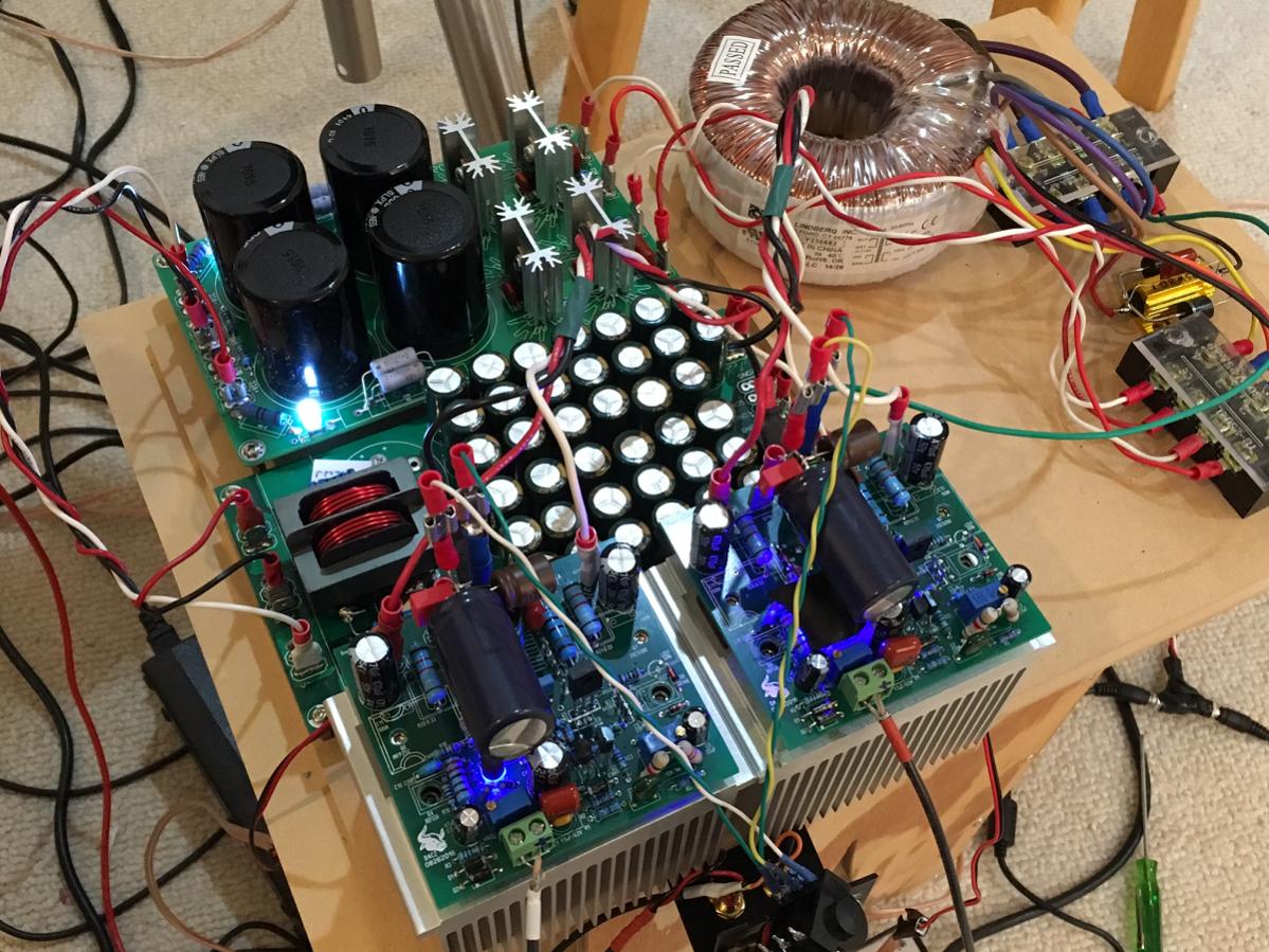

Wow that's a wonderful build - pretty much the same that I have planned, but I'm going for the 5.0 Turbo.The USSA-3 hybrid is alive and sounds very good. 🙂
First impressions: very good separation and soundstage, gives me that holographic sound with my speakers.
Bass is good, no need for higher damping factor.
So far it's the best amp I have built for my hifi-system.
I've build it modular, even if there are only two modules 🙂
Power supply is easily inserted this way.
Build specs:
- LT4320 ideal bridges
- dual mono CLC PS, star ground
- GR grade for the SJ74/SK170, this gives 50% higher damping, I used 2k7 for R5/6 and 5k pots
- DC coupled, since I use a DC protection on the speaker out, I can live with the dangers of DC coupled and don't have the worry about the SQ of the coupling cap 😉
- bias at 1.3A
Thanks Fab, for this design !

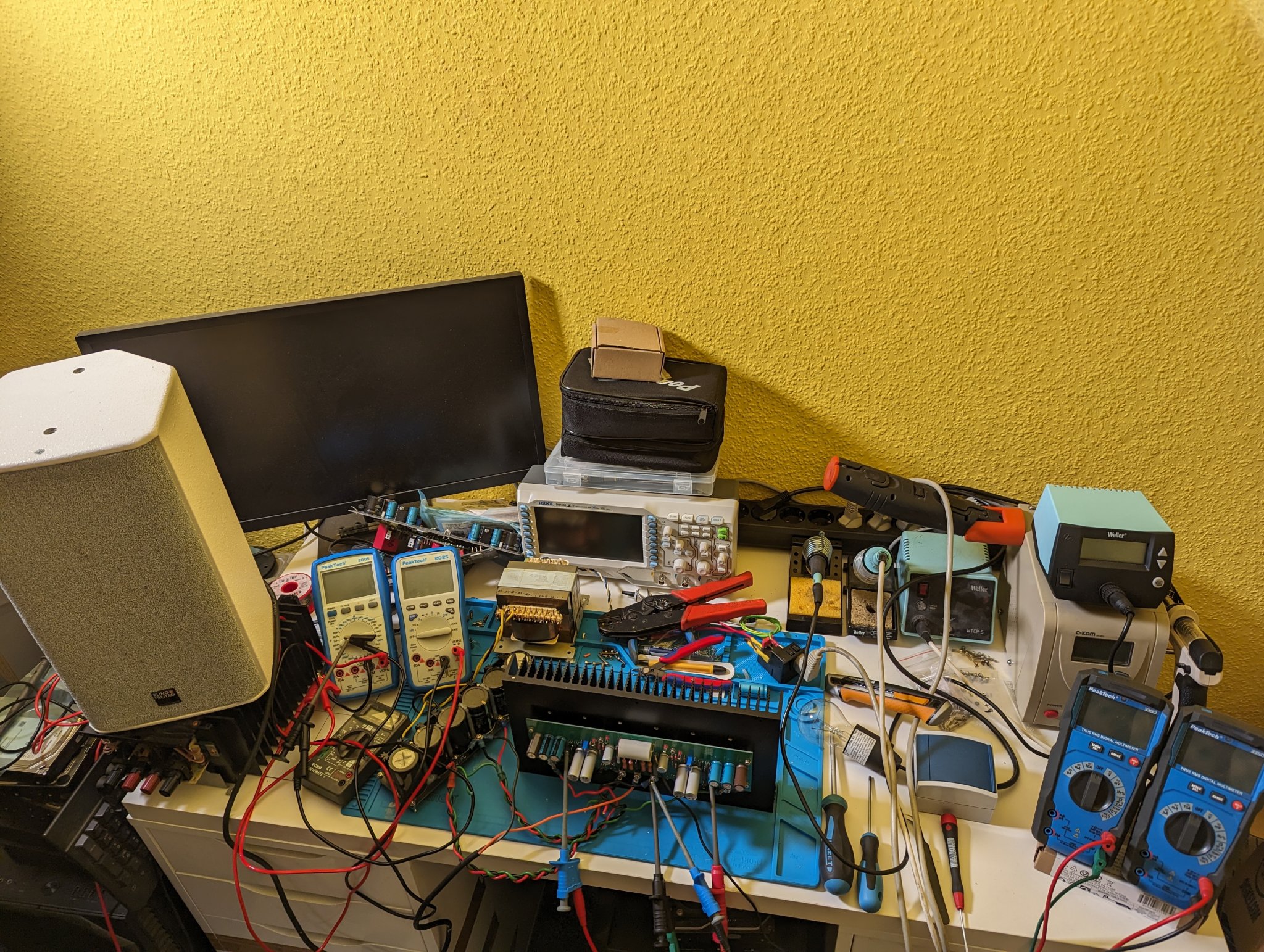

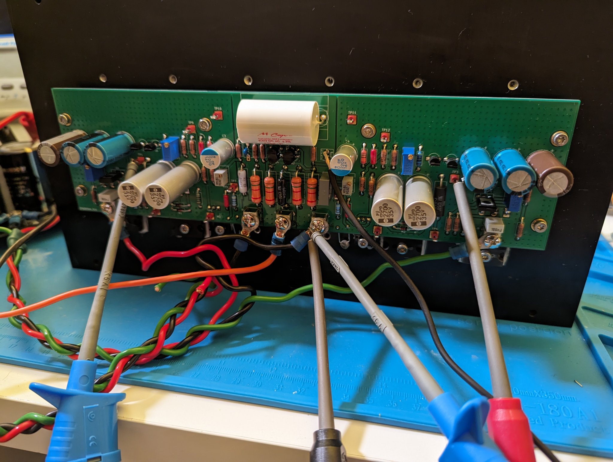

Done some prototyping and testing today.. It's singing right now. CMX onboard - dead-silent with some 93db/1W/1m-speakers. UMS compatible layout...
