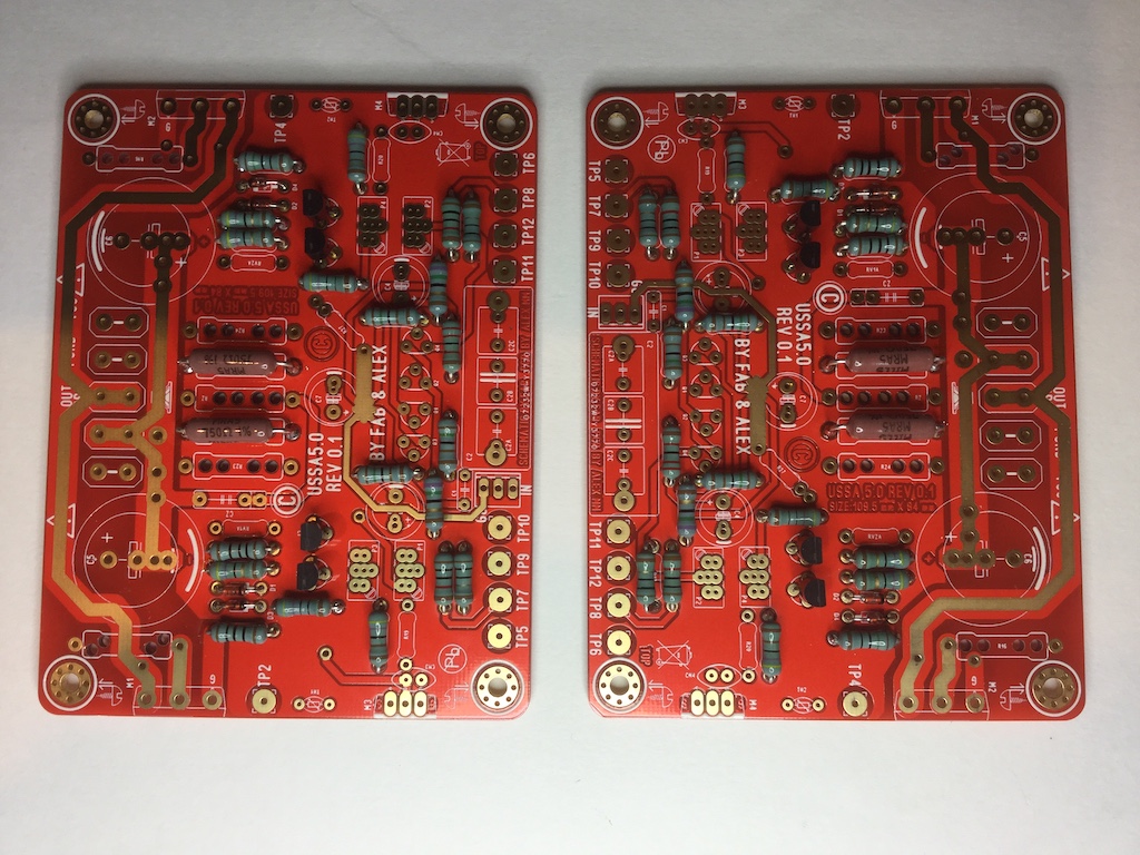

I was lucky enough to buy a USSA-5 kit in November that was a left over from the earlier QuebecDIY forum group buy (thanks Do).
I promised Fab that I would update as I made progress, so here is the first. These are the version 0.1 boards in glowing red. Most of the small resistors are in (though I made a mistake on my last order and shorted myself a couple of 220R, so testing will have to wait until I can get more)). Some of the larger resistors, small diodes and jfets are in too.
Question for Fab: capacitor C1 (220 pF mica in the kit). The mica leads are too big and would have to be soldered to the top of the pads, per Do's suggestion. I have some extra 240 pF polystyrene that would go through hole and wondering if these would be appropriate in this position?
Thanks!

I have not used polystyrene cap since a long time... I would still use the mica since it is not a big deal to install. Version 0.4 of pcb have increased size holes for that cap.
