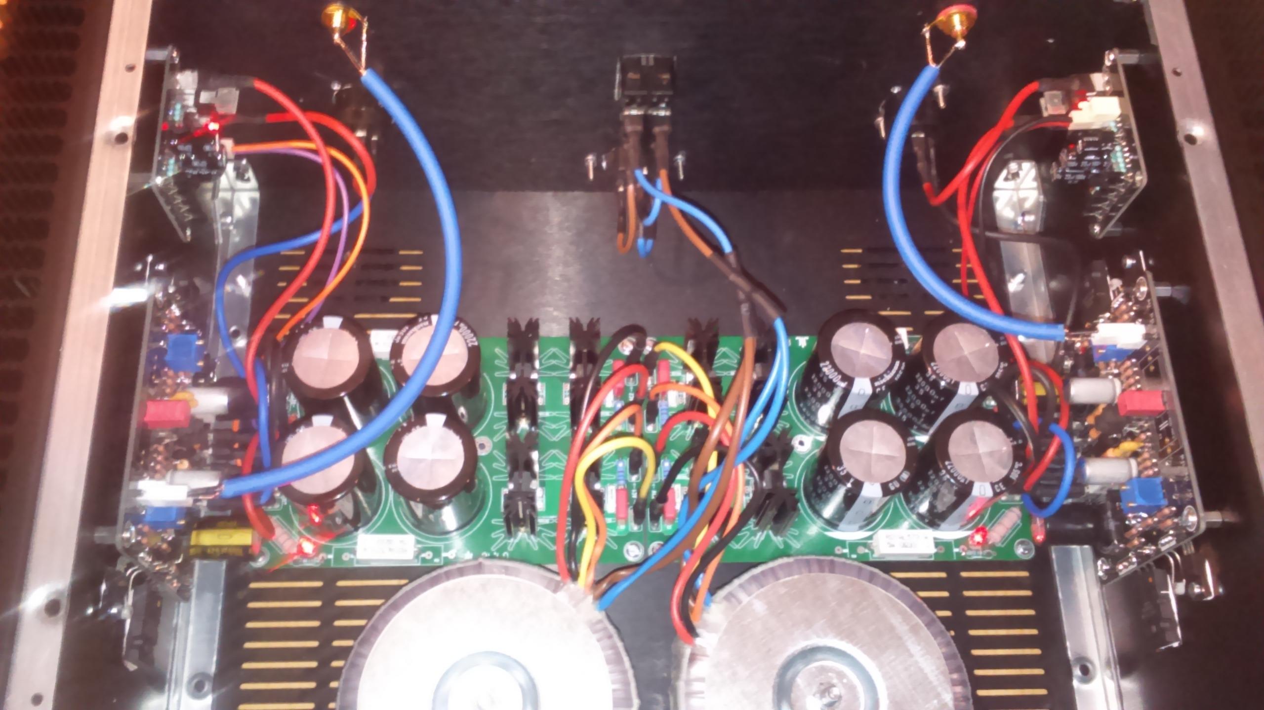

André,
Thank you for sharing updates and build pics. Good luck with the rest of it, and hope you will be making music soon. I am another one who wants to build the USSA 5 and got the PCBs from Fab a while back, but the project is still awaiting a few parts here and there... Hope to get it done eventually. In the meantime learning through the experience of fellow diyA forum members. :)
Hello Do,
Can’t wait to see and HEAR the final build too! :)
Thank you for your suggestion, I will try to put the AC lines in to the cellar (between mounting and bottom sheet if possible or use a shielding).
I will see what fits and what works, but I will stay in the middle.
Do you know if ferrite rings make any sense in an amplifier?
Have a nice evening.
CU
André

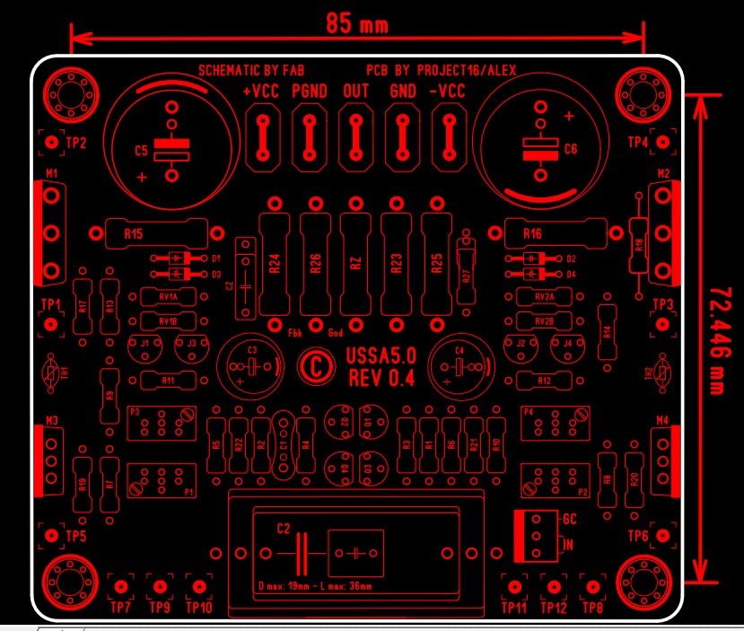

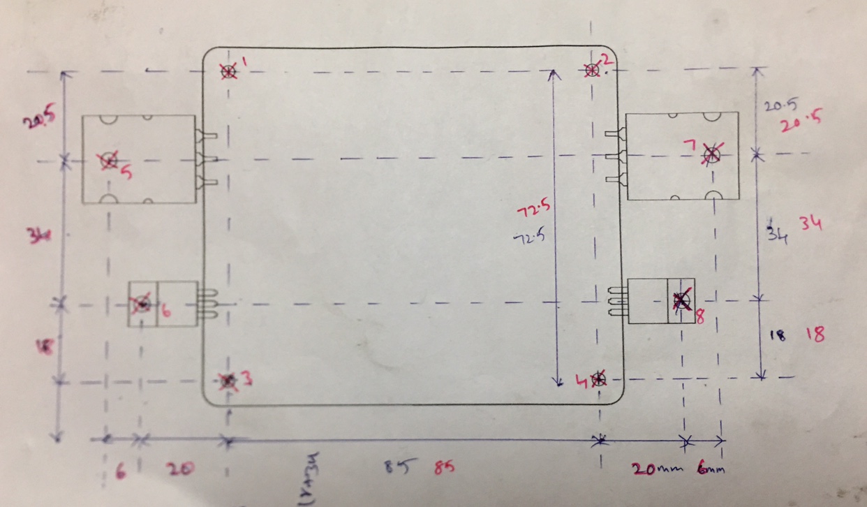

Does someone have the exact dimensions of the latest ussa-5 pcbs? I don't think the info in the manual is correct.
Also, the heatsink drill template with dimensions - the one I found in the gb thread doesn't have any dimensions.
Thanks,
Hi
The manual shows dimensions of pcb v 0.1 and 0.2.
Last pcb version 0.4 has a smaller size. See attached mounting holes relative positions.
Fab
