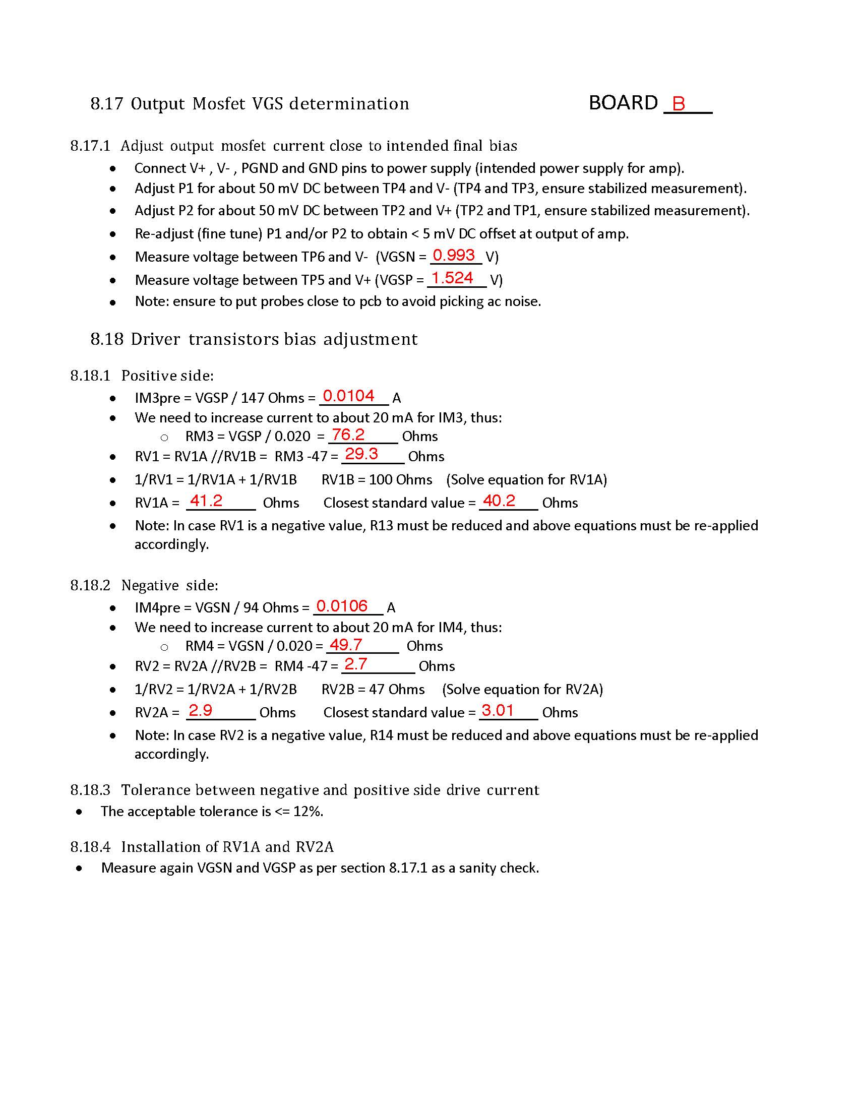

Hello All:

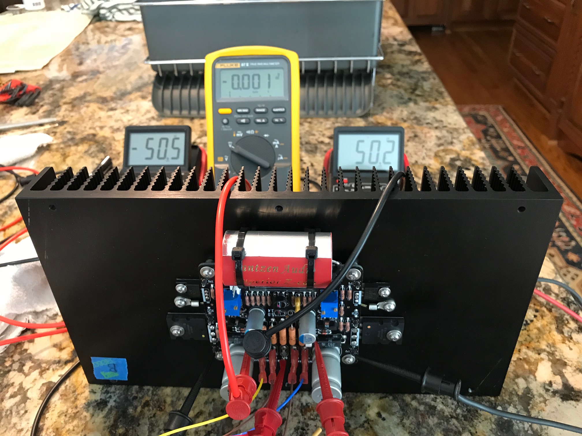

I am up to section 8.17.1 , Adjust output MOSFET current close to intended final bias.
Everything has measured fine up to this step. When I apply power, TP4/V- and TP2/V+ read 0.00 volts, and the offset at output is about 0.5 volts. The MOSFETS are not getting warm. I get the same readings on both boards, so I believe parts are installed correctly.
Should I proceed to increase/decrease P1/P2 to turn on MOSFETS?

Hi
If all previous steps measured fine then it is normal to get 0 volts before adjustments if the vgs off of the mosfet are on the high side (red color band for example). Therefore you can proceed to adjust P1/P2 to get output bias while keeping DC offset close to 0 (<50mv until final bias). At final bias you can tweak dc offset to < 5mv once température is stabilized.

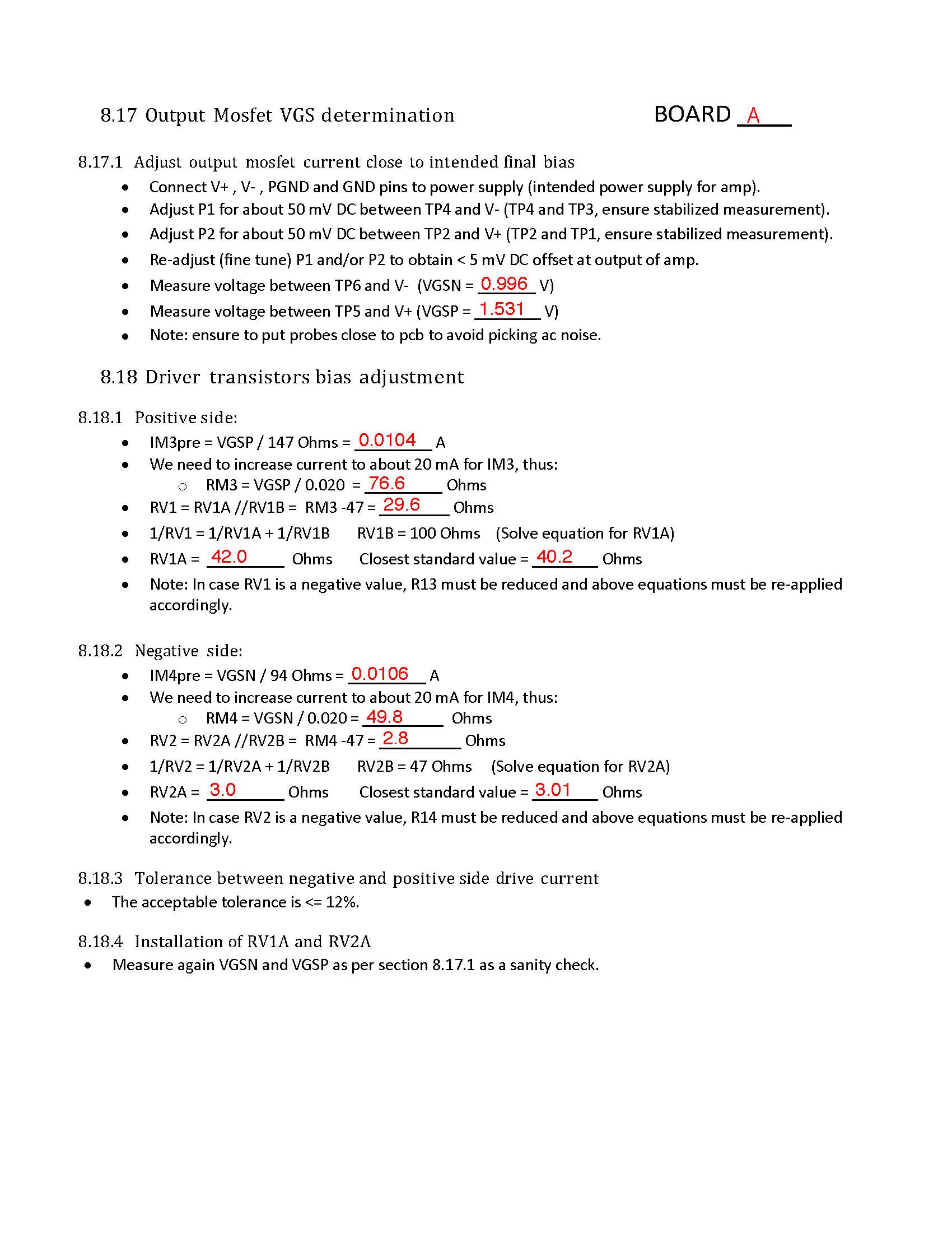

You got 100% for your test 🙂Apparently forms behave differently on iPhone and iMac version of Acrobat. Here are jpg images of my results.

HiThanks Fab. Will post VGS calcs for confirmation soon.
You have clean assembly, proper positioning and good size heatsink. Your input cap is a little (far) more expensive than the one specified in the BOM...😉

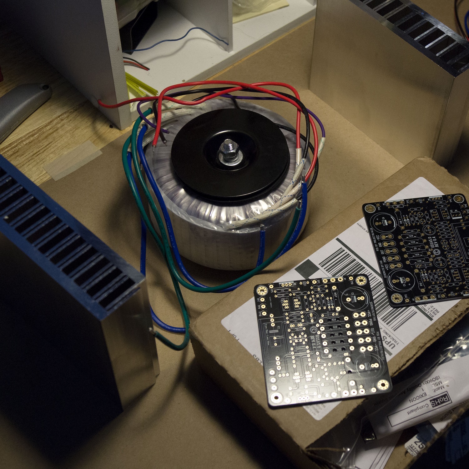

Anyone attempt this kind of thing and can point me in a direction for photos or build info?
- USSA-5 Build with Review
