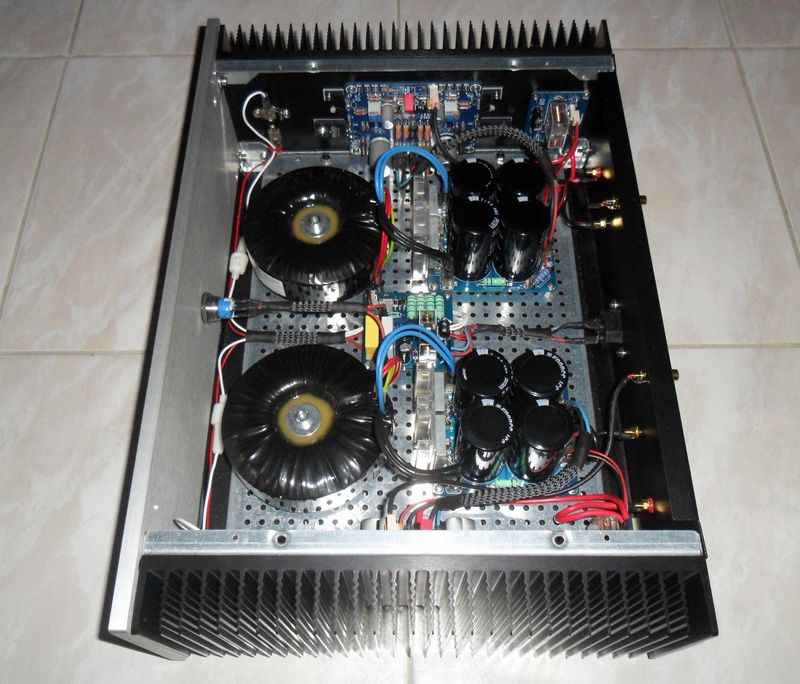

What type of chassis would you recommend ? Is a 3U, 300mm deep ok ?
Eric
Hello Eric
My USSA-5 is in a box 3U - 300mm and no particular problem of heat for 1.1A on the mosfets, the temperature of the heatsinks does not exceed 47 ° with an ambient temperature not exceeding 25 °. The only problem with a model 3U - 30mm is the space available inside for the power supply which is quite limited and a model 3U - 400mm would be more suitable.

Thanks guys, I’ll go w 3U but aim for 400mm.
