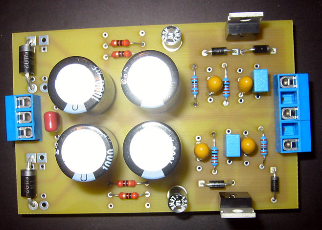

Pulled the trigger last night. I should get the boards by Friday, along with a digikey order, so I can work on it over the weekend.
Update...Got the PCB today, and will start soldering tomorrow. One question I have is should I solder all the components from the bottom side? Also should the regulators be inserted "all the way" through the hole? If you click on the www button below, it will take you to my new webpage devoted to this and future DIY projects of mine.

Success! It works on both +/- halves. I have it set up for half wave (D1,D2 populated) with 1000 uF, 63V caps for the smoothing. I'm using reg resistor of 3.01K and 332R, which is giving an output ~12.5V. I didn't have the right resistors for 15V, but that's o.k., since I have 2 boards left. I also put in the fuses. I'm excited! I was fully expecting it either a) not to work or b) to blow up in my face. So far neither has happened. Also, I noticed it takes several seconds for the voltage (current?) to discharge after I remove the inputs. I've always known that is supposed to happen, but it's fun to watch it on the scope.

First Pic
My camera was o.k., but I needed a new flash card. Here's a pic. There will be more, but my camera battery needs to recharge. I'll do some more scoping tests tonight.
One thing you can probably tell from the pic is that there is not enough room for two 1N5403 diodes (i.e. D1',D2'). Oh, well. I can easily put more space and order new boards in the future.
