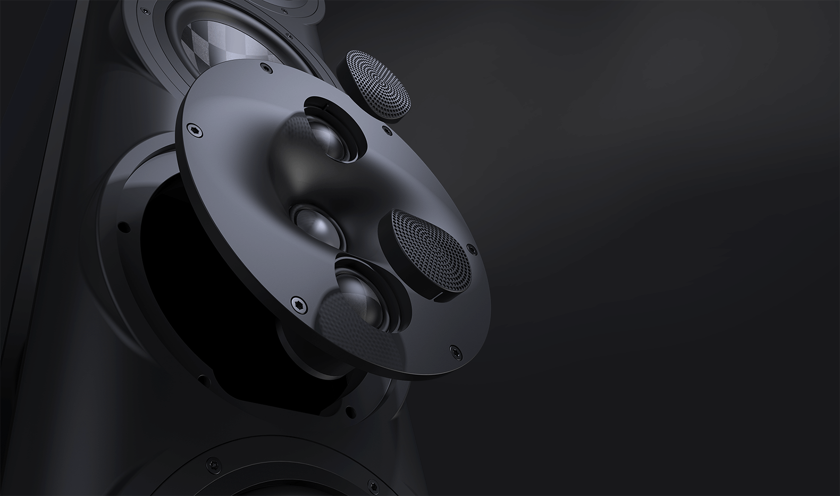

Perlisten is using 3 tweeeters with some tricks
https://www.audioholics.com/tower-speaker-reviews/perlisten-s7t
https://www.perlistenaudio.com/
