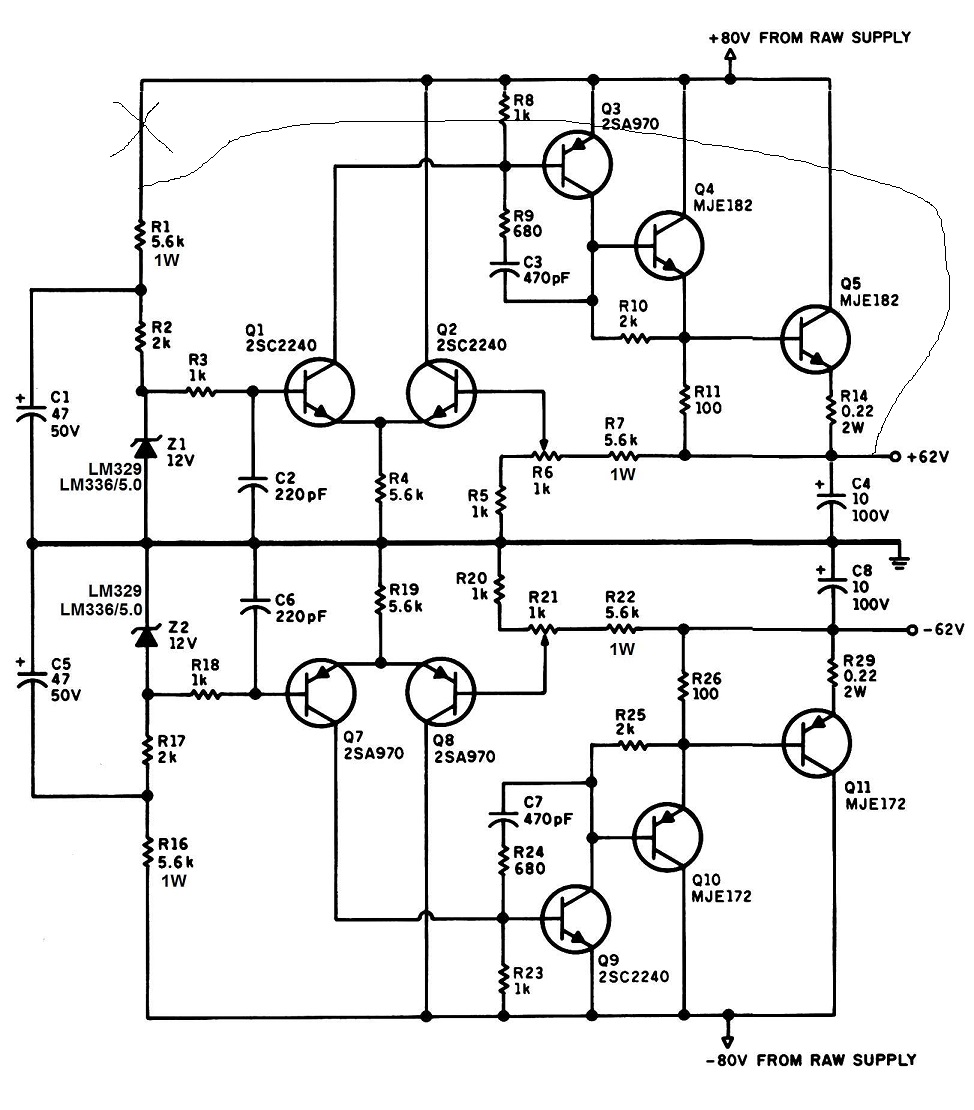

Closer to what you suggested?
The basic circuit is that the ref goes to Q1 base, so the LPT can compare that ref with (a sample of) Vout and correct when necessary. In this schematic, what is done with the zener voltage? Nothing, so it can't worjk as a ref.
There is no reference to Q1, it's just Vout.
Take the original circuit and look at how the zener is fed through some R from Vin. Only ONE change: take that feed and move that to Vin. Don't think too much behind it. Just ONE change of a resistor from Vin to Vout, so all the current through that resistor that goes down to ultimately the zener now comes from Vin instead of from Vout.
BTW, normally such a regulator should start up, but there might be a chance it will not. So try it out before modding all your 24 regulators ;-)
BTW2: the resistor-zener string will now be fed from a lower voltage. So you should lower that top resistor so the zener current stays about the same (not critical).

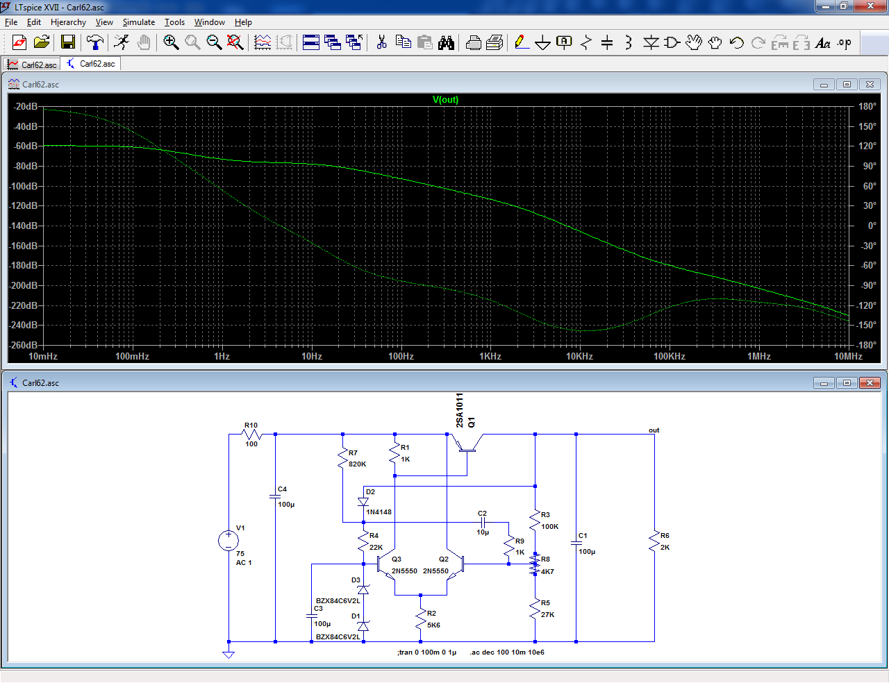

Are there any values we could change in the three transistor regulator to improve results? As it is now we get 77dB @ 10Hz
The circuit is pretty much optimal, meaning little room for improvement with this topology.
You can tweak some values, to marginally increase the loop gain, but you are going to scrape a few dB's at most.
The floor is dictated by the Early effect in the transistors, thus you could in principle improve matters by chosing transistors having a higher Vaf, problem: this parameter is not specified in the DS, and the value given in the spice model is generally fanciful and unreliable.
It is also possible to compensate this effect with a resistor, R11 in this case, but a series cap also needs to be added, to compensate for phase-shifts.
The result looks wonderful: 100dB PSRR @ 10Hz, but it is too good to be true: this is just a simulation, and the reality will be somewhat duller.

You can realistically expect a 20dB improvement, but you will need to make R11 adjustable, because real transistors will not behave in this way.
A less glamorous but more reliable solution is to add a passive filter in front of the regulator, like for the Luxman:

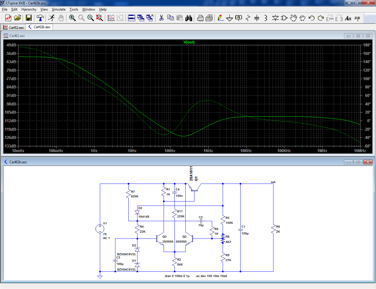

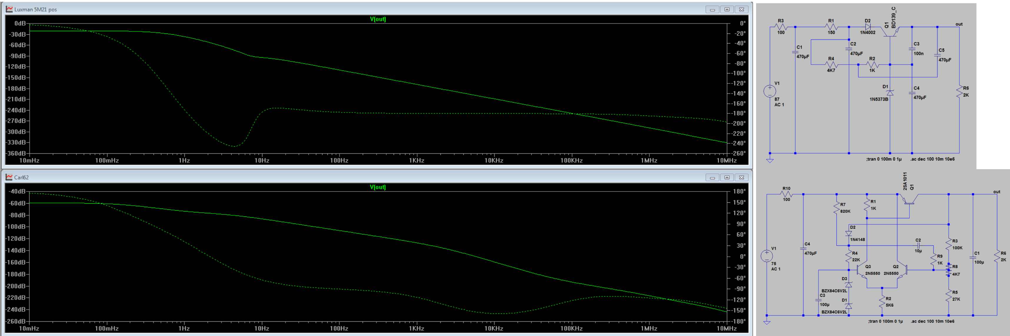

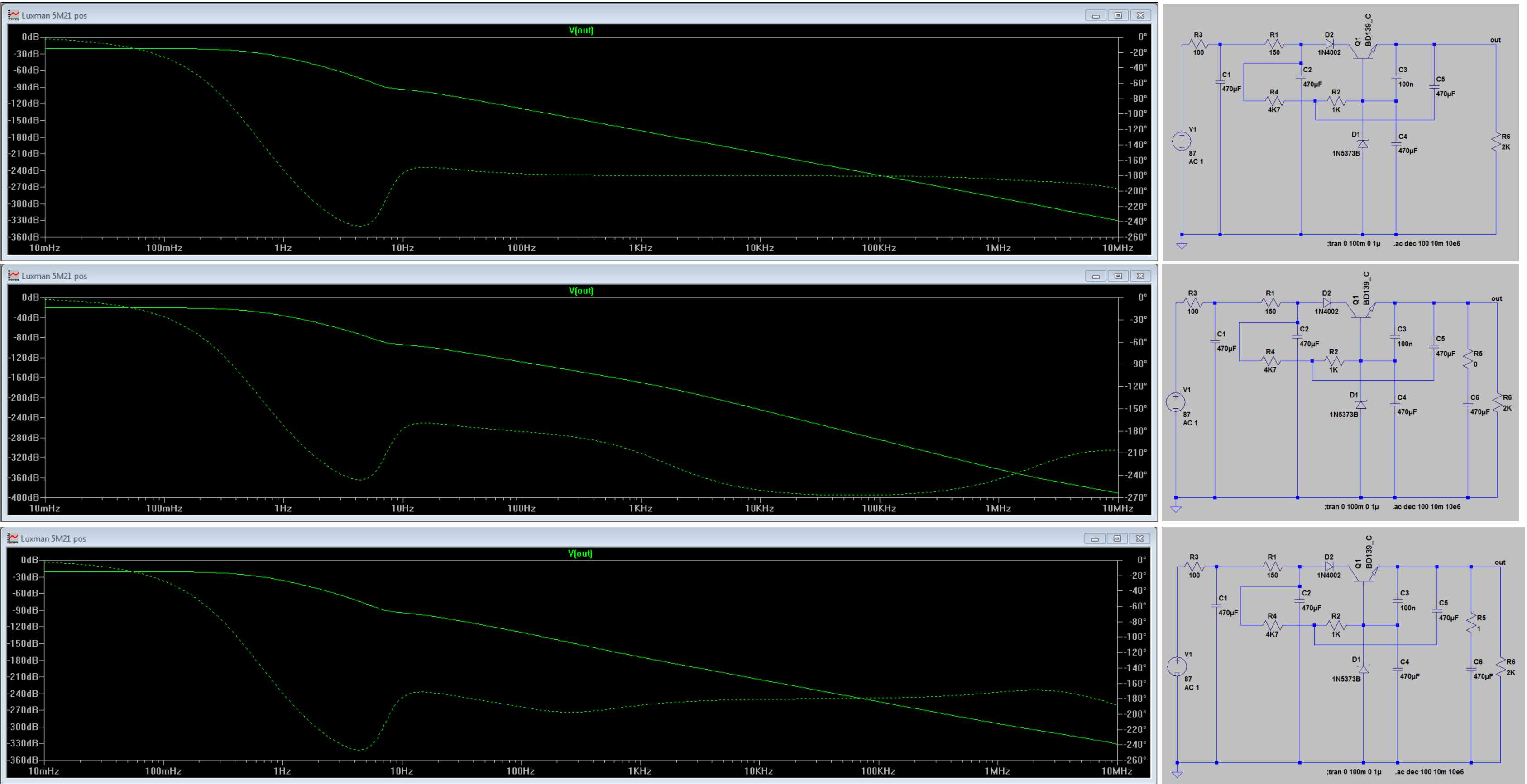

Things seem to have got clearer and simpler, with just two major options, changing minor details on one or the other. That is very good and what I wished to get by coming here.
The two shown share the same input R/C filter, and the resulting sim curves are both very good.
The simpler regulator, based on the original supply, looks like the best choice in quantity of parts, almost half. Which would mean a simpler pcb that I could even add on the power amp pcb itself, which is a very good thing.

The top one doesn't have an output cap. That has a major impact on loop gain. There will in practice always be an output cap.
To make the sim more accurate, use an output cap with a small series R equivalent to the ESR of the cap you plan to use. Then check again for stability.
Interestingly enough, the only thing that visibly changed by adding the output cap was the phase curve.
I did add a series resistor to the output cap. I guess that R value would be correct for the cap ESR.
Of course. The cap is in parallel with the low Zout of the reg so the output wouldn't change perceptible in magnitude. But it's the phase versus magnitude that determines the stability.
I think these things can be better appreciated when you look at the open loop transfer of the regulator, not the closed loop. You can also do a .tran to see if there are no obvious instabilities.
Jan
With modern types, it is more likely to be something like 0.25 ohm, but with a single transistor, it would be difficult to have instabilities.
Without the zener, interesting things could happen: with the numerous capacitors around providing multiple feedback, the response could be quirky, but as soon as the zener conducts, it will kill any resonance.

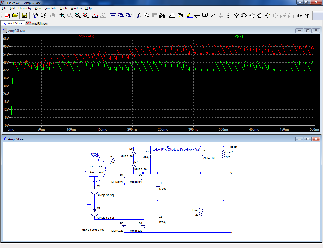

Elvee, can you upload the asc file for the boosted DC lines?
Here it is, annotated with design information:

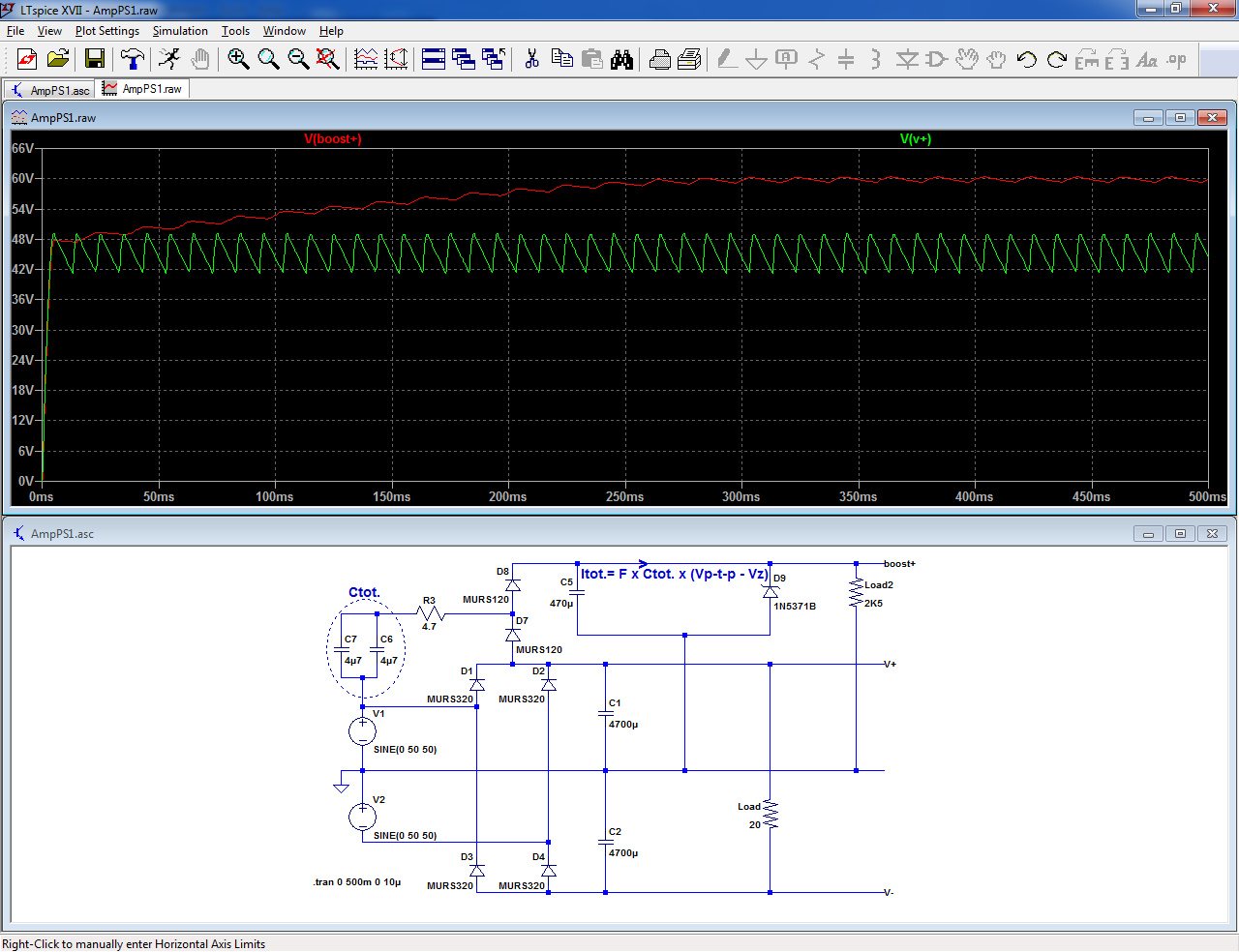

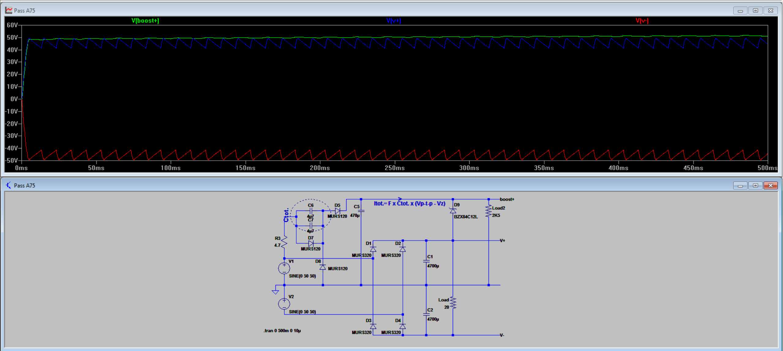

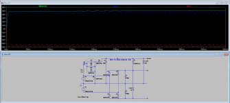

OK, this is an alternative wiring for a doubler as applied by Nelson Pass on his A75 amplifier.
I did retain the D9 zener, but moved all the diodes and caps following what Pass did.
Some questions to understand this simulation, which I never did:
1) Why don't we get smooth DC at the outputs?
2) Why connecting the doubler from main high current bridge instead of directly to the AC output?
3) Why don't we get double the voltage at the boosted output? Shouldn't it be +/-100 VDC?
  • Pass A75.asc
    Pass A75.asc
Why did you vandalize the circuit in this way? You rendered it non-functional and added useless components.
If you tried to fix this "problem", I also provided a variant addressing that:
You wanted the boosted rail to track the main V+, and that's exactly what this variant does (ripple included, obviously).
You cannot have one behavior and its opposite at the same time in the same circuit: you will have to make a choice.
Here is the non-tracking, smooth version again:
attachment.php

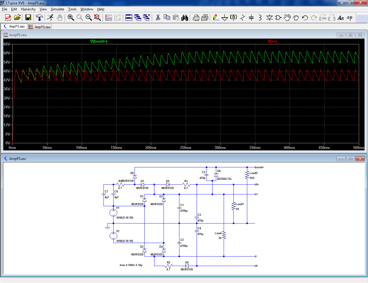

To reference it to the main V+, to avoid this:
No, you got it all wrong.
I didn't vandalize your circuit. That would be a lack of respect, and that's the last thing I wished to do.
What I did was sim the Pass A75 regulator and asked why you had connected the booster parts in a different way than what Nelson Pass had done it?
You can see that I named the asc file that way too.
What I thought to boost was not the main V+ rail, but the AC feeding the large current bridge. Then smooth it, then adding the regulator.
You seem to be proposing a different approach, which I don't quite understand, with a zener diode. Can you explain that?
It seems that it starts as double, or it seems the zener is limiting voltage the booster can get to. Am I right?
My purpose is to get this doubler not to affect anything with additional noise, for instance. On Pass A75 supply the extra voltage is dissipated on the regulator's output transistor, even if voltages were lower.
As I said previously, the circuit is a capacitive supply*, which is loosely based on the doubler topology, but with the front cap small enough to act as a (lossless) ballast.
Without the zener, the final voltage would reach 3*V+
*Search this expression
