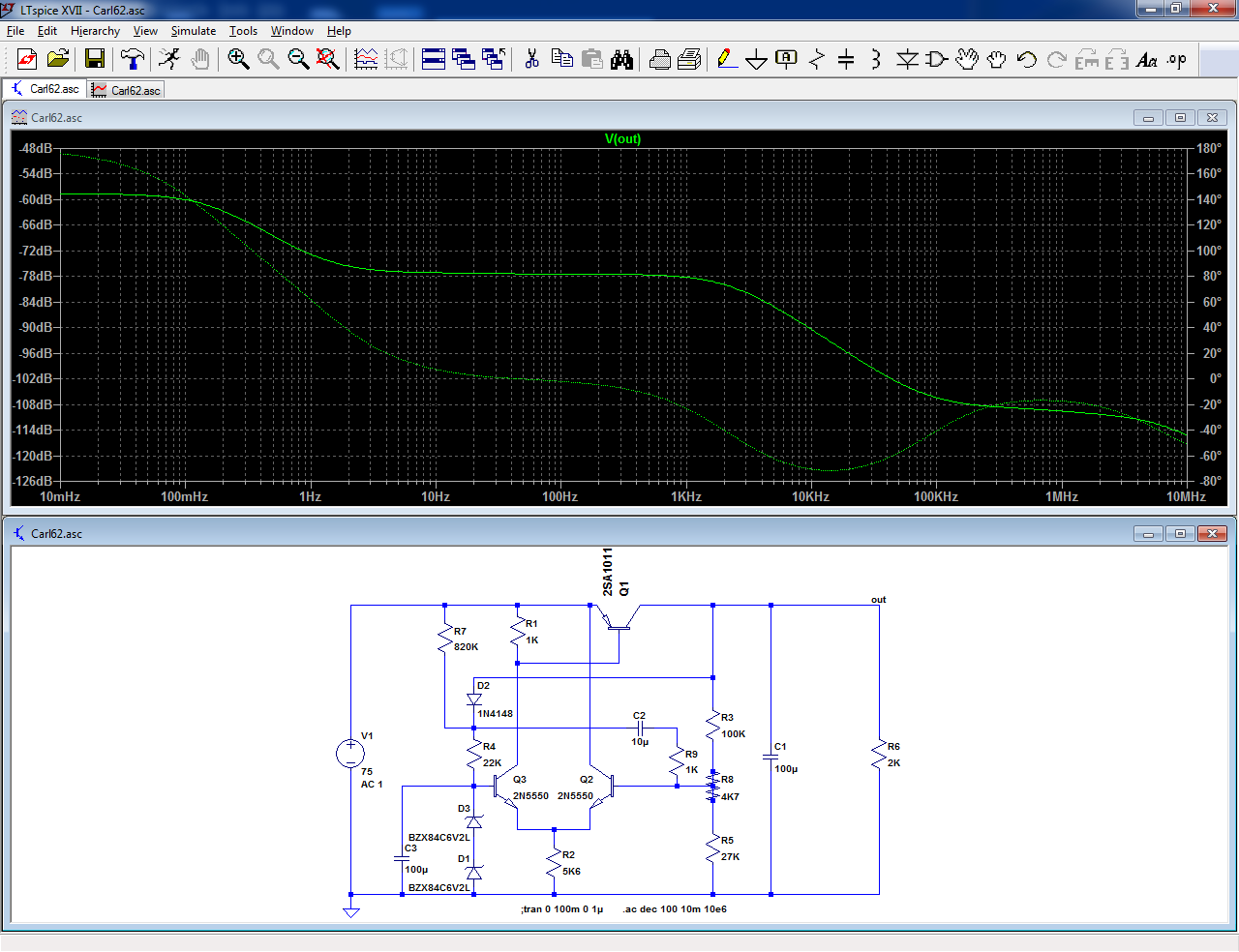

I think I did mention that the current needs for this regulator will not be large, so I won't need the output transistors used for the Adcom.
Just run the LTSpice simulation, and the current is 16mA on one side and 6mA on the other.

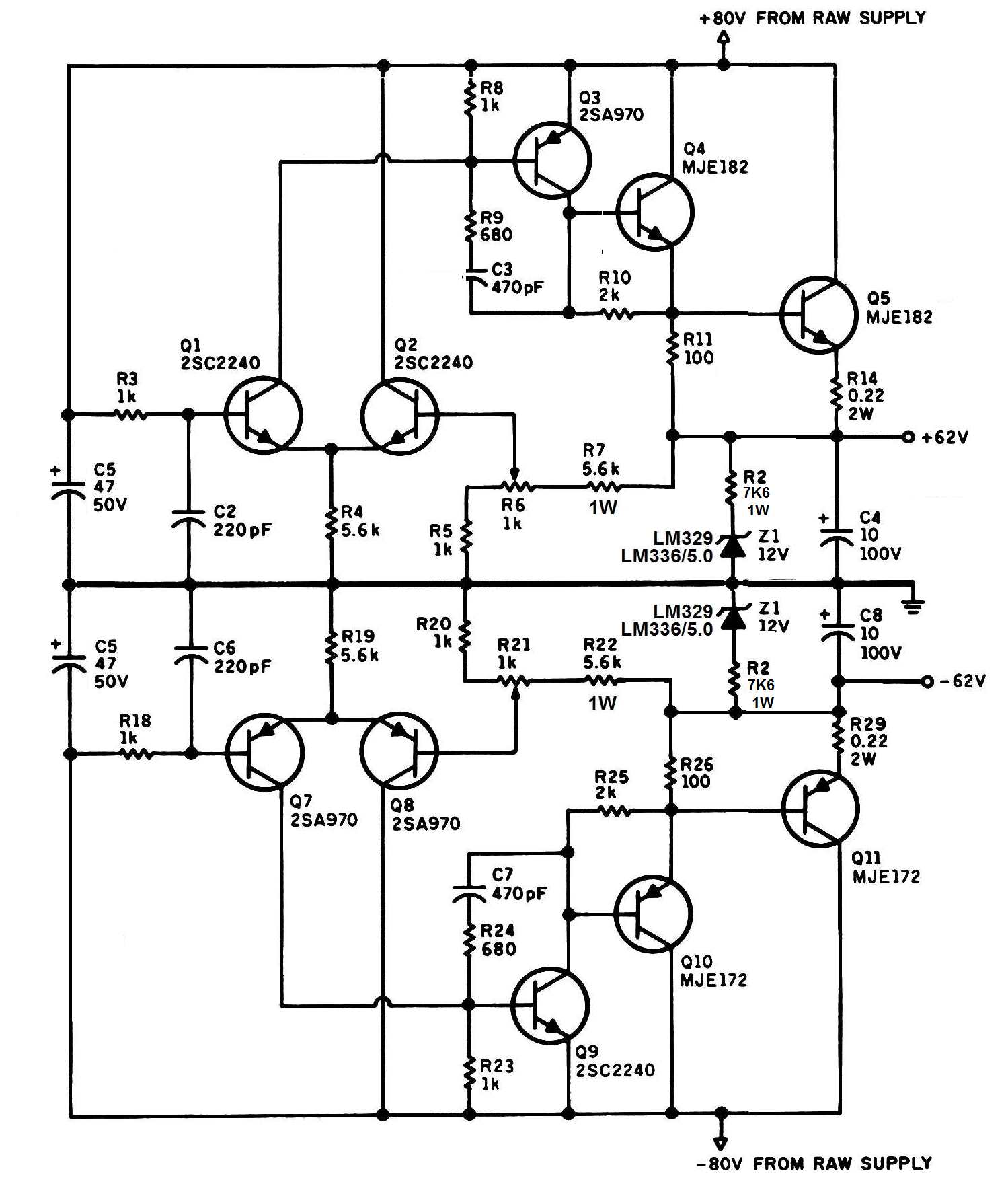

Today I found one of the articles, from The Audio Amateur magazine, where they used a 317/337 pair to modify an Erno Borbely 60w amplifier published years before on that same magazine.
One important thing mentioned on that article is that the author did consider the TL783, but considered the voltage drop too large: 10-15v. Indeed it is.
So I went back to have a look at two similar discrete regulators that I think might be simple and good options.
Kit Ryan's supply has the advantage of being completely bipolar, meanwhile Borbely's uses MOSFETs that you can't find now.
Your opinions over this are important to me.

Both can be improved for zero extra cost by feeding the reference string from the output instead of from the input.
Also, by making the reference voltage higher you get extra loop gain thus better performance, also for free. What's not to like!

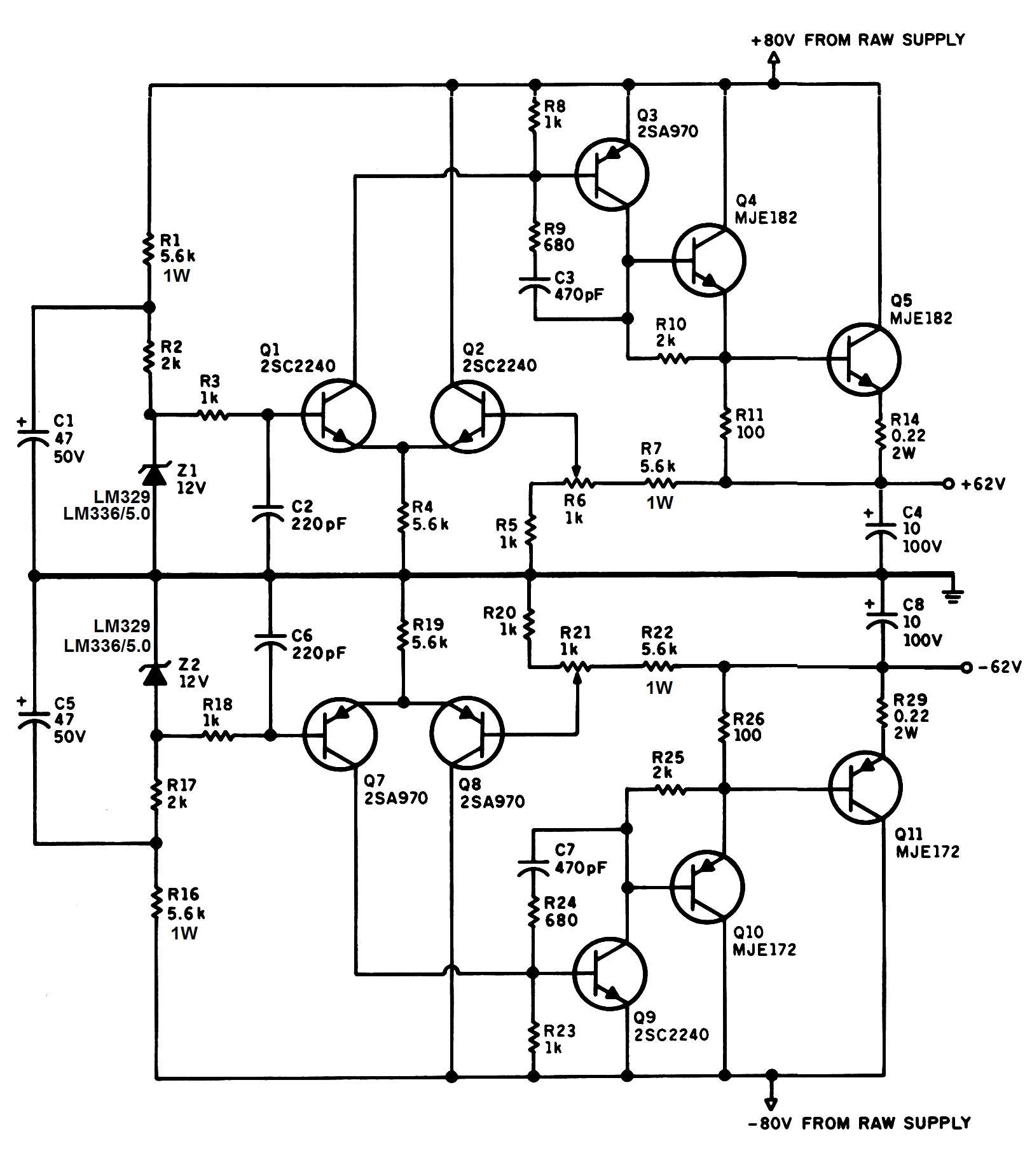

It is very simple. Look at the zener that forms the reference on one base. That zener is fed by some R's from Vin. Change that to be fed from Vout. R1/R16 on the left schematic, R39/R48 on the right one. That's all. You can keep the caps that decouple that R string or trash them, doesn't make a difference after the mod.

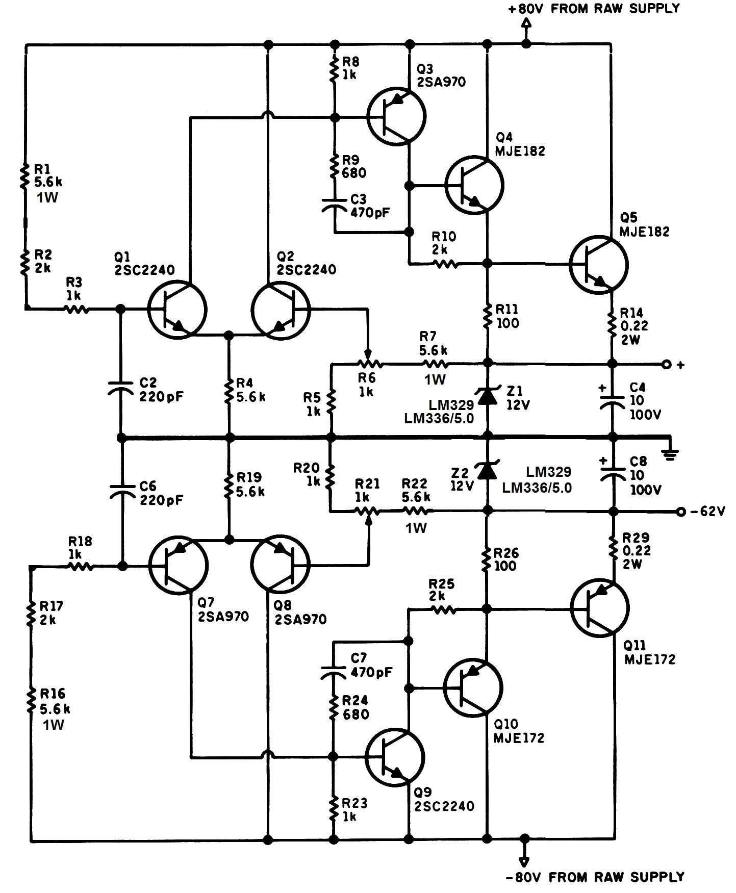

You mean something like this? Wouldn't this output 12v?
No, here is a more reasonable version:

PSRR in the auidio range is ~78dB, which is probably better than you could expect from a TL783-like reg.
It doesn't match a denoiser, but why would you need better than that for such a mundane task?
No, here the zener is across Vout, that'll release all the build-in smoke in the zener. Take the whole ref string, not just the zener, R1/R6 or R39/R48 down through the zener to ground, and feed that string not from Vin but from Vout.
Closer to what you suggested?
What do you think of Elvee's LTSpice demo schematic?
No. You need to feed the diff amp's non inverting input from the zener reference and the inverting input from the output voltage divider.
Isn't that what the Kit Ryan's PS already does?
