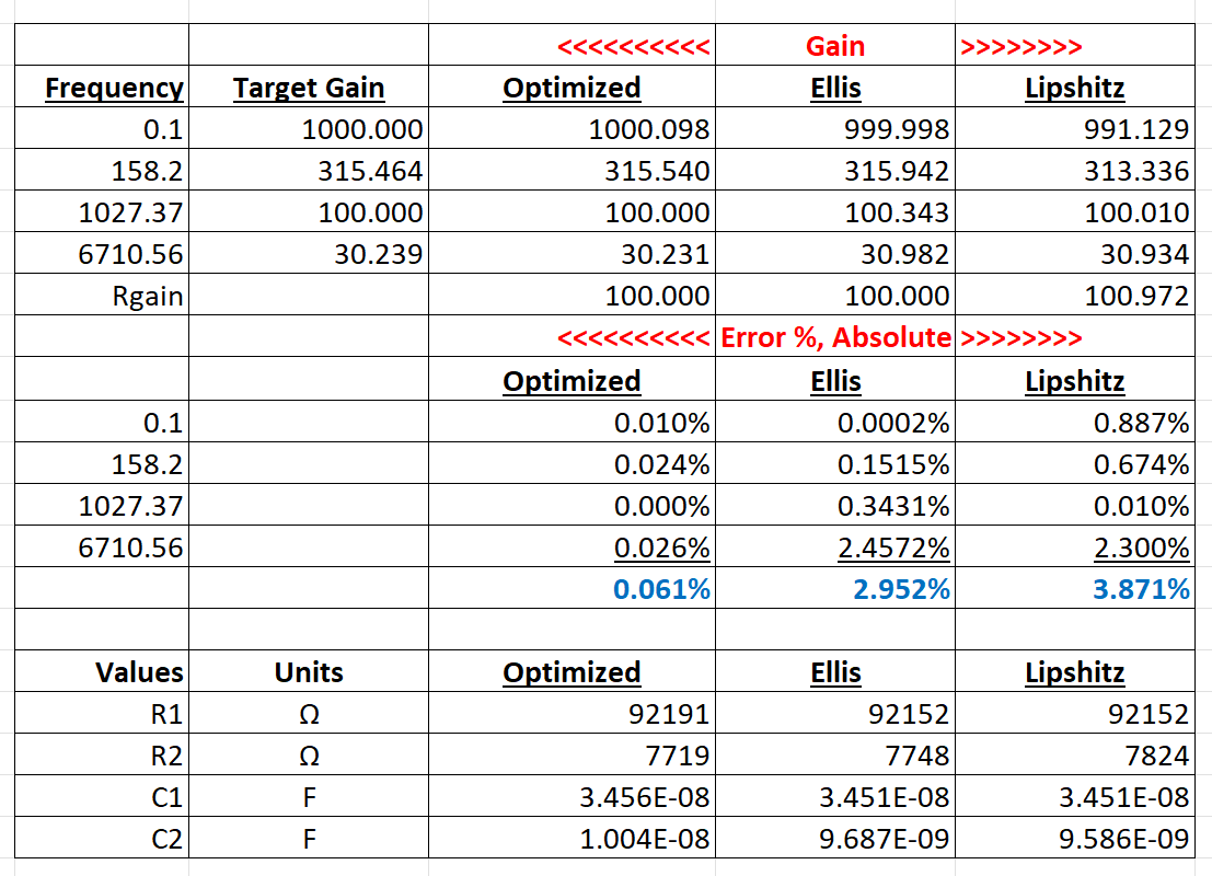

Here's a chart which illustrates the difference, using the "Ellis" values from the AudioXpress article, then using R1 of 92.152k Ohm as a seed value for the "Lipshitz" values. Gain error is adjusted to 0dB @1kHz. In both cases, R(0) = 100 Ohms.

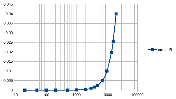

The error is about +0.04 dB at 20 kHz, corresponding to a zero with a corner frequency of about 208 kHz (that is, zero position about -416 pi krad/s). That means that the midband gain must be about 100 and the low frequency (20 Hz to 50 Hz) gain around 1000. The low-frequency zero then has a corner frequency of about 20 Hz/1000 = 20 mHz, that is, the zero shifts from the origin to about -40 pi mrad/s due to the +1 term.
When I calculate the effect of a zero at -40 pi mrad/s that should have been at 0 and a zero at -416 pi krad/s that shouldn't have been there at all (or should have been at infinity), I get this:
which doesn't resemble the blue graph of post #58 much, at least not below 3 kHz. Does Ellis account for other imperfections as well, besides the +1 term?

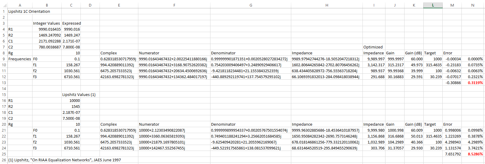

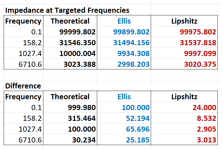

Perhaps this explains the error. I used the Laplace transforms to calculate the impedance of the Lipshitz and Ellis RC networks compared with the scaled impedance using T3,T4 and T5 for Ellis' frequencies.
The gain for Ellis is then ~= 1+(99.899kΩ/100Ω) = 1,000 at 0.1Hz and ~= 100.3@ 1,027.37 Hz
So, using the theoretical network impedance, subtract the resistance of the gain resistor and solve.

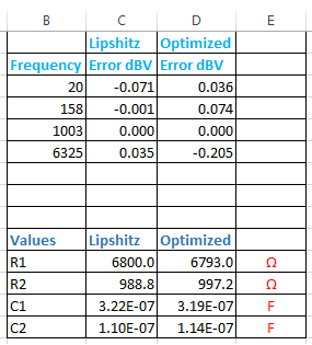

Since there are only 4 frequencies to examine, rather than an optimization I chose the "eyeball" method, first adjusting the value of R2, then C2, slightly tweaking the value of R1. That's a "hat tip" to Mark.
The matrix just uses the complex math functions of Excel and rather than writing one long expression divides the job into numerator and denominator.

I have a Pass Pearl II that has MilMax female headers to try an assortment of resistor and cap values (Pearl uses the passive Lipshitz "1C" configuration). At the spot frequencies I was able to run, the Lipshitz values are superior to the "Optimized" values, disrespecting all of those Laplace transforms in Excel. Will have to try this in the active "1A" configuration.

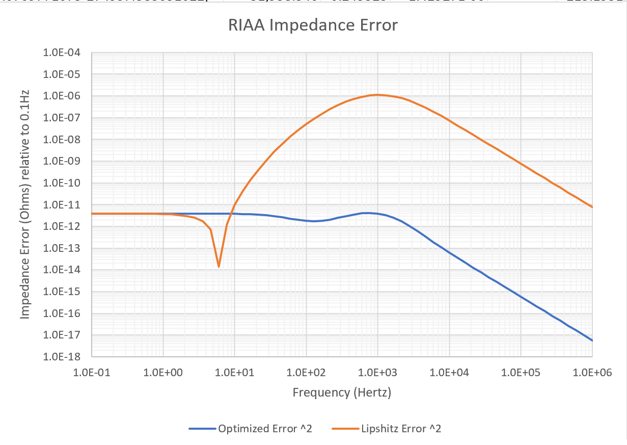

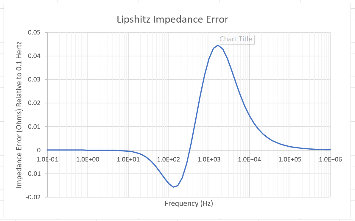

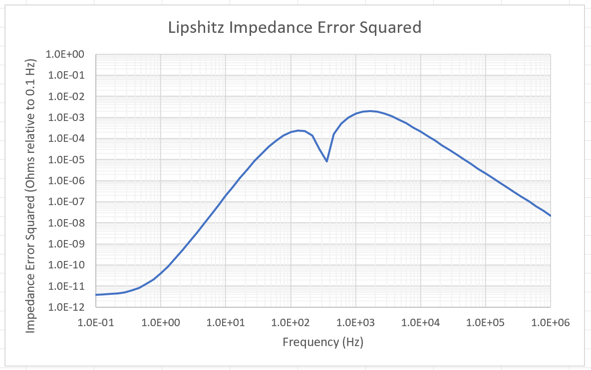

An extension of this -- will probably have to start a new thread -- I took the Laplace using the time values (t3, t4, t5) , and the Laplace using RC values carried out to 5 digits. In addition, I used multiple decade frequencies. If running an Excel I minimize to the sum of squared errors.

Here's another example of optimization. Note that Lipshitz in his 1977 article said his work was accurate to a tenth of a dB. This optimization is a wee bit better. Original values R1 120k, R2 10k, C1 26.5n, C2 7.5n. Optimized values R1 120k, R2 10.170k, C1 26.5n, C2 7.36n. I am away from the workshop, so won't be able to demonstrate "reality" until next week:
Log Squashed Error is ABS(LN(1-ABS(ERROR))). Optimize for the minimum.
The differences in impedance between the Lipshitz values and those optimized, are the difference between a milli-Ohm and a micro-Ohm. Given that my HP3456A will only get to 1 milli-Ohm at DC I would say the results are pretty much inconsequential. Even with the VNA you are going to see some reactive impedance for the best of components!
Interesting, R1 * C1 still gives 3180us, and R2 * C2 gives 75 us, but (R1 || R2) * (C1 || C2) shifts from 318.000 us to 318.083 us
