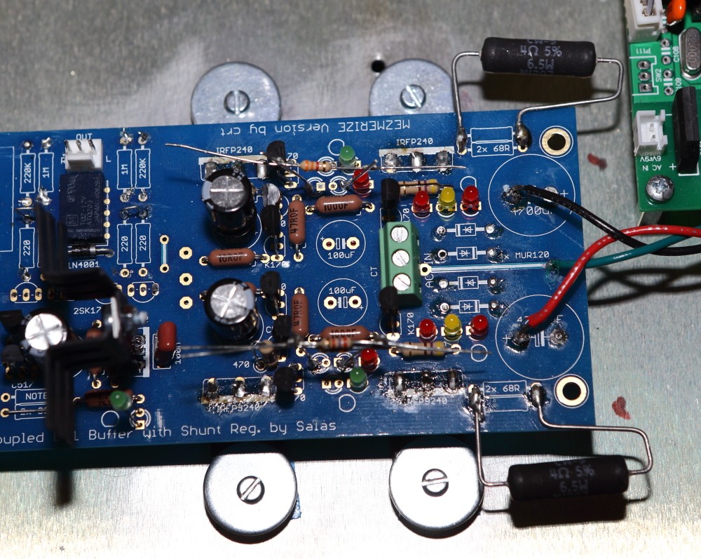

Hi Salas, I'm working my way through re-purposing my blue Mez board as a regulated power supply for a preamp and am running into some strange issues with output voltage and current. The PSU going to the board provides +/- 37VDC. I was hoping you could shed some insights
On the Positive rail side (moving from PSU to Relays) I have the following measurements:
Current Set Resistor (2x68R position), I have a 4R power resistor that drops 1.42v to provide 355mA current to the first Mosfet
First 9240: G=32.4v, D=28.4v, S=36.5v
2SK170 next to 3-terminal AC input: S=0.9v, G=0.9v, D=32.4v
Vset LEDs + resistor: used a 1k6 resistor to provide ~27.5v output from regulator, this resistor drop 23.7v across it.
Second 9240: G=24.2v, D=0.0v, S=28.0v
2SK170 adjacent to second 9240 mosfet measures: S=25.9v, G=25.9v, D=30.9v
10R at the board output measures 0.13V for bias of 130mA
On the Negative Rail Side, I have
Current Set Resistor (2x68R position), I have a 4R power resistor that drops 1.43v to provide 357mA current to the first Mosfet
First 240: G=-32.4v, D=-29v, S=-36.5v
2SK170 next to 3-terminal AC input: S=-32.3v, G=-32.3v, D=-0.8v
Vset LEDs + resistor: used a 3k3 resistor to provide ~-28.1v output from regulator, this resistor drop 22.8v across it.
Second 240: G=-24.5v, D=0.0v, S=-28.6v
2SK170 adjacent to second 240 mosfet measures: S=-32.3v, G=-32.3v, D=-0.8v
10R at the board output measures 0.05V for bias of 50mA
Blue PP caps are mounted to the bottom of the board in the place where the 100uF caps are open on top.
So, there are two things going on that I don't understand.
1) Why do I need to use two different Vtest Resistor values (1k6 for pos and 3k3 for neg) to balance the regulator output?
2) Why am I getting two different bias levels at the 10R output resistors (130mA Pos and 50mA Neg)?

Hi Eric
I think that the two K170s placed next to those 10R resistors have very different IDSS. Because those are the ones that define the current through the Vset LEDS and resistors, then its expected to need so different resistors in value if that's the case. Blue board needs no "leg trick" by the way.
Verify their IDSS and find nearer characteristics pair if you got any spares. If not, you may keep equalizing the voltage drops with different value Vset resistors.
Use the 100uF voltage reference filter capacitors also on top if the preamp is sensitive for noise. If medium to high gain analog or having some digital chips on it for instance.

Thanks for the input, Salas. Those jFets are the unmatched ones, so they were probably just chosen at random because they didn't match any others that I had. I have no idea how they actually measured, I'll have to go back and see if I made any notes.
Sounds like everything is functioning correctly, and this is just a function of the parts I've used.
