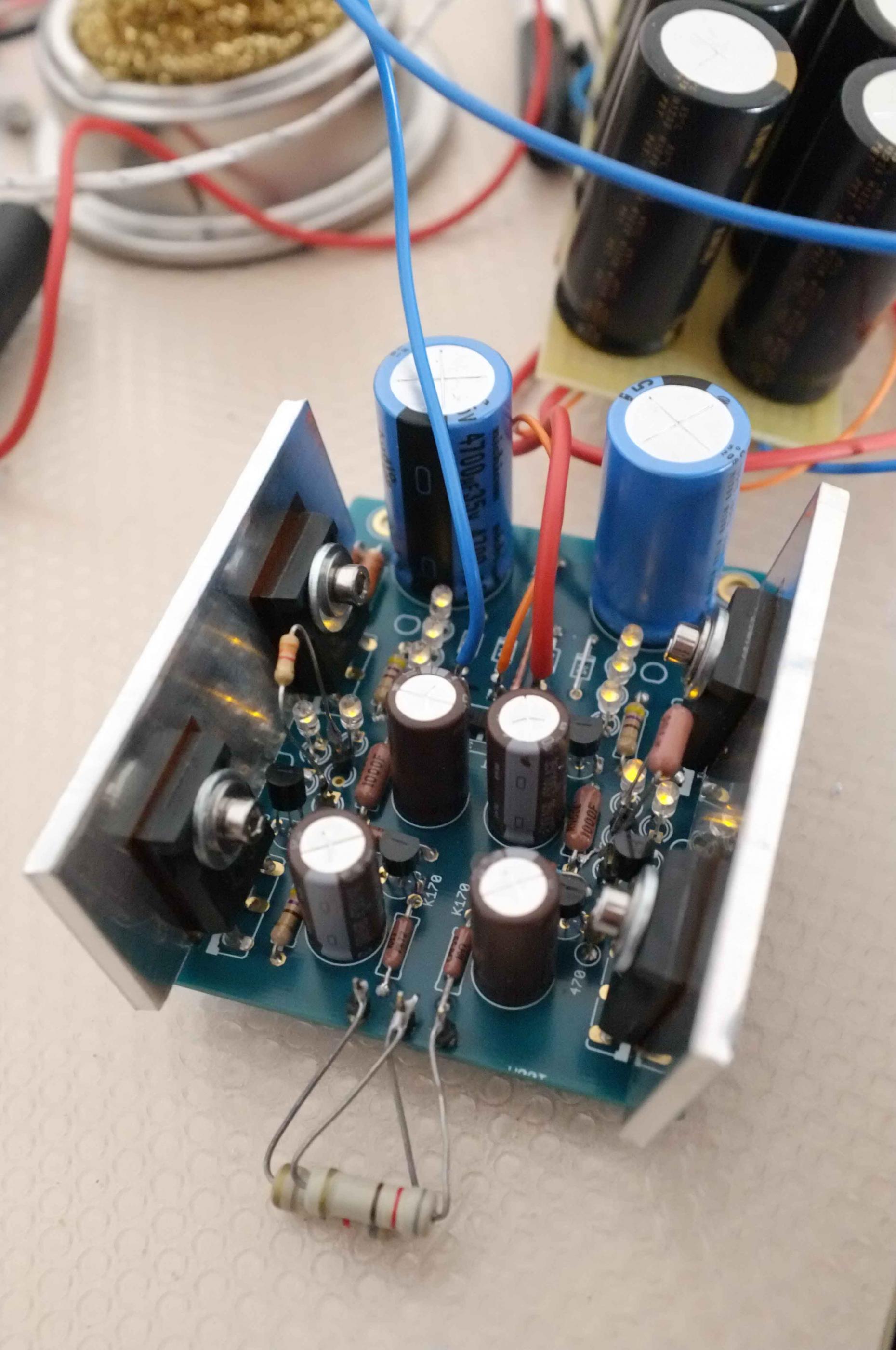

Finished my first regulator. With a 220R test resistor I'm getting Vout=6.96V, and 1.94V across the test R itself. Dummy load is 800R on each rail.
Replaced test R with 2k2 on both rails. I'm now getting Vout=+/-22.4V.
Vin dropped to about 32.4V per rail.
With 2x22.1R and small sinks (75*30*4mm) the temperature on IRF cases reached about 65C (149F).
The yellow leds are happy and shiny 🙂
Going to raise the current to at least 300mA, with finned sinks, and trim the V resistor once the actual Pearl Two channel is completed.

Hooked one Pearl2 channel to the regulator, with 3x22.1R and bigger sinks.
Looks like the phono card is asking for about 40mA on each rail.
Across 3x22.1R I'm reading 1.96V on the plus side, and 1.76 on minus.
So, the current dissipated by the mosfets is >200mA per side.
The current mosfet on the minus rail is sensibly hotter than its + brother.
Everything looks stable, no unexpected heat, smoke or fireworks 🙂
Now, time to complete the second channel and fight against hum&buzz.

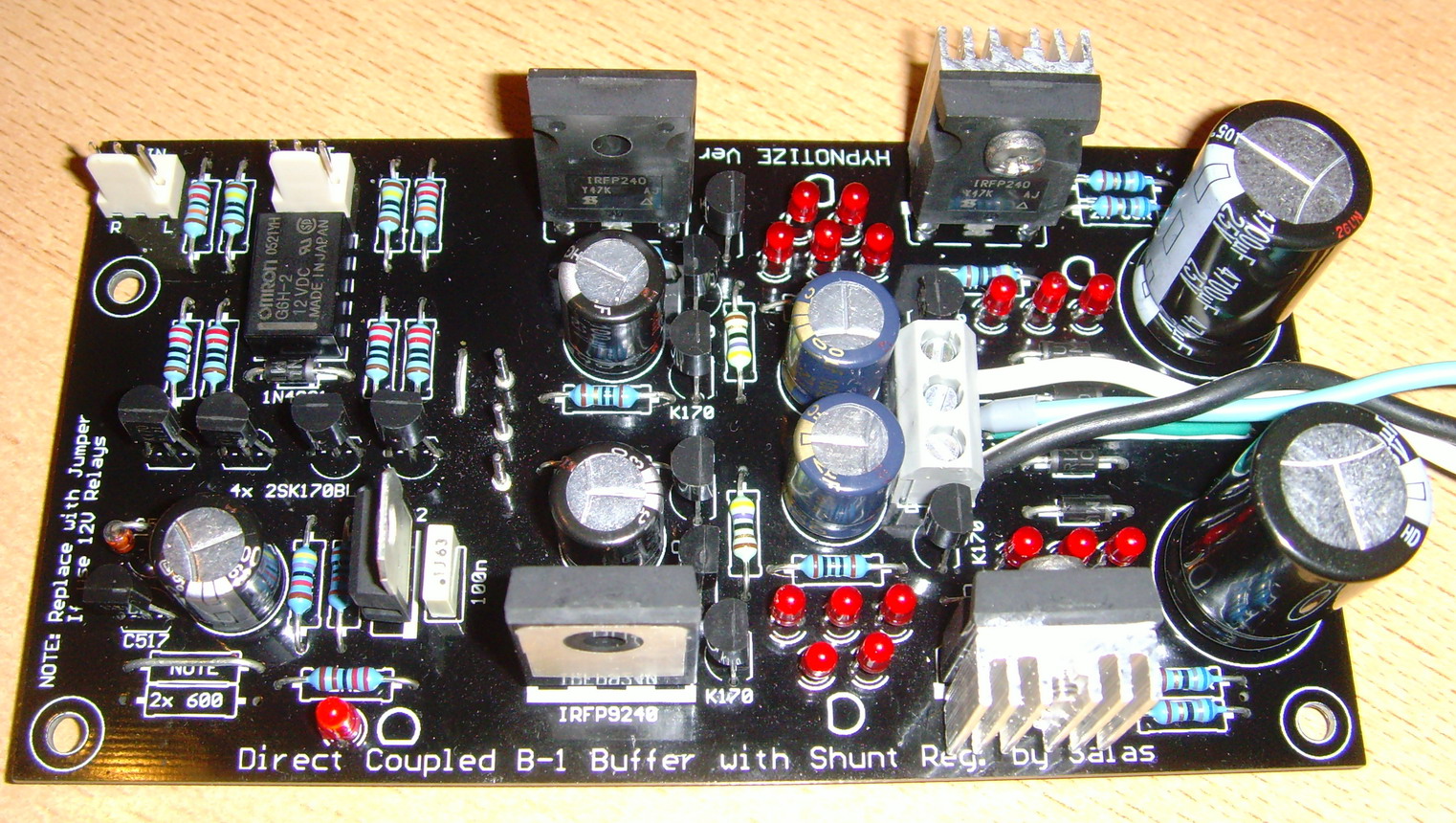

Gentlemen, a DIY-friend of mine left me his partially built "Direct Coupled B1-Buffer with Shunt Regulator" - see attached image.
For example: he has already soldered all of the 2SK170 transistors.
I have finished the PCB yesterday and did some measurements / tests. The transformer used is a 2x12VAC / 50VA toroid.
All LEDs are shining and no component is getting hot.
But:
1st: I had troubles with the relay. It would not switch on. I finally replaced the BC550 (the upper one) by a 5V1 - ZENER - diode. Now the relay switches on after about 4-5 seconds.
2nd: I measured the positive rail-voltage (10.5V) and the negative rail-voltage (9.5V !). So there is > 1V difference. Is this tolerable?
I have measured and selected the LED-strings by myself. They are definitely o.k.
3rd: I measured 1mV DC-offset (I have measured between Output and GND) on one channel and 10mv (!) on the other channel.
Is this a "usable" buffer or do I need to fix anything?
Best regards - Rudi_Ratlos
