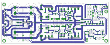

Is there any reason not to use MUR860 diodes on the new blue hypno boards if I have some spare? They are also 8A 200volt fast recovery and the package size is the same.
Where do I look for a guide to implementation of the shunt reg only for different voltages, like 27v (to drive my Atlantic RIAA), for example?

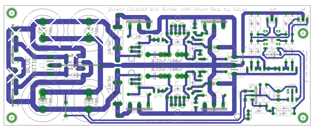

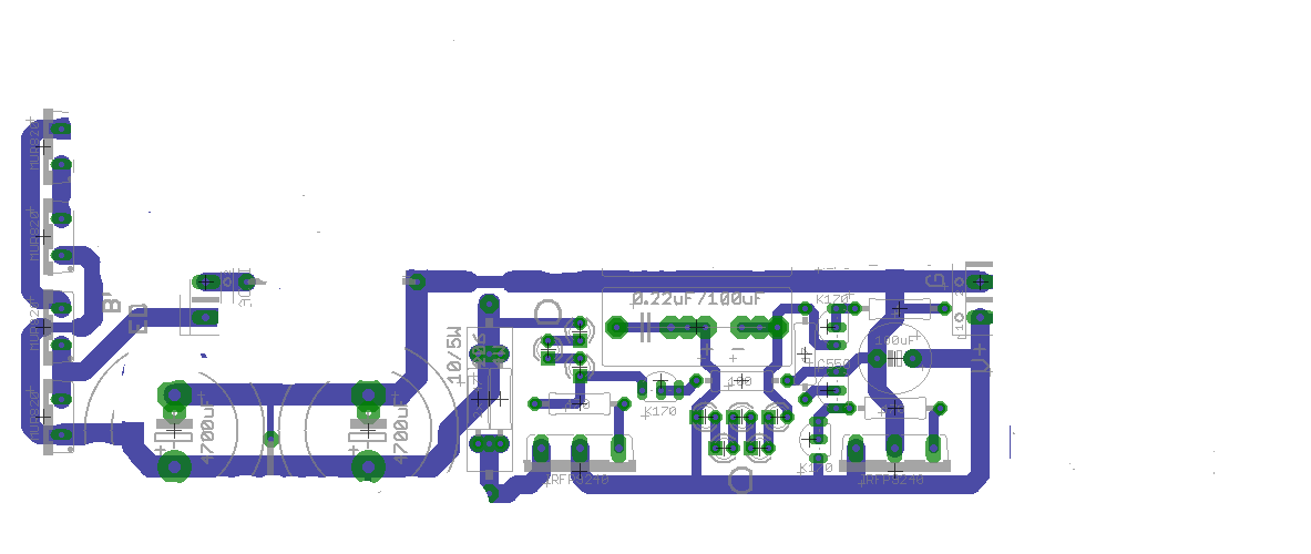

For single rail use, I realise that the central bar is a common earth, and that I need populate the + side only, but it's not so simple at the PS caps and rectifier diodes, which span across the two sides of the reg.
Do I need to add a jumper from the - side to earth to complete the rectifier circuit?

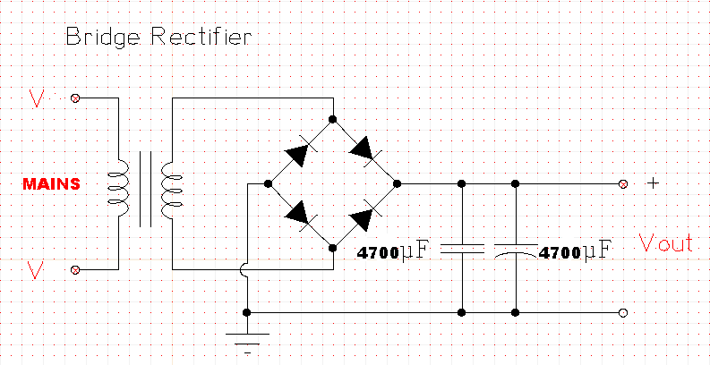

Is your trafo centre tapped 3 wire secondary or 2 wire? What are its specs?
Arrange for a config like in the attachment.
Thanks Salas. I have a dual secondaries on this particular toroidal transformer.
I am familiar with the schematic for a standard rectification pattern, but only a little confused as to how this relates to the PCB for single rail use.
Because one side is left unstuffed, it looks like the rectifier needs a jumper or two to complete the circuit. No?

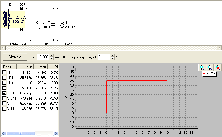

Meanwhile, I have another question. I have 2x Panny FC 2200uF 50V caps. Any good for the shunt supply or too small? The RIAA is Class A and will only pull about 20-30mA (estimated by your good self if I remember correctly, some time ago.)
Also, is there any advantage to the Hot-Rod for a phono stage?
Sufficient caps. There is quality gain in 200mA. Stay with 10R 5W and sink the Mosfets. You will need lytic in the bypass bay with resistor you gonna add for 27V. There are +/- marks. When only LEDS for 10V DCB1 use, PP cap benefit plays. Resistor Vref Vout extension calls for lytic due to different impedance needs.
2200uF is usually considered good enough for about 1A of DC current with tolerable ripple on the supply.
If you want excellent ripple on the supply you could reduce the current draw by a factor of 10, i.e. 100mA of DC current.
Set your CCS to 100mA and use 20 to 30mA at the RIAA. The remaining 70 to 80mA is dissipated in the regulator.

Oh, my transformer is 25v x2 and rather too large 120VA.
With your centre tapped transformer, things are easy. Lending nicely to full wave two diode rectification for a positive polarity reg only you requested, without hacking the board. Reminder: Its either the big or small size diode pair you will use, not both.
