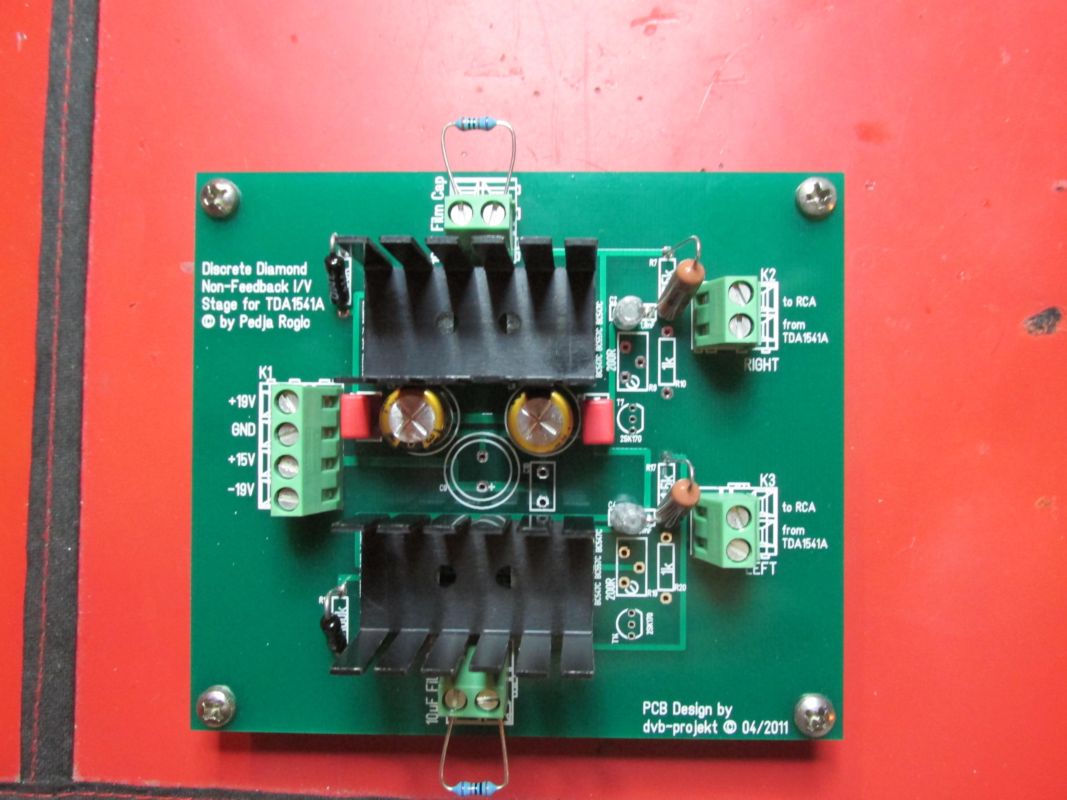

Pedja Rogic DDNF circuit boards
Update: I have 3 DDNF boards built up minus bipolar transistors. A friend asked me to build his Chinese transistor tester for him. Side benefit is I can try it out. Hope to get that done by the weekend. 2 boards will go in the Mark 3 Parallel TDA1541A S1 Crown dac. The other is slatted to go in the PCM1704 dac. I am only going to DC couple the PCM1704 version if at all possible. The unknown is if the Chinese device is accurate or not. Time will tell.

Pedja Rogic DDNF for PCM1704
Assembled the DDNF board for the PCM1704. Untested as an assembly. My solution to bonding the transistors was video card double sided heatsink tape. I had some suitable heatsinks in my parts box. Hope to test it this weekend. Plan: Test offset and drift with shorted inputs. Test the DC coupled concept. It is essentially a go, no-go test. 🙄

The board test was somewhat what I expected. It did not like being shorted at the inputs however was unharmed. Without the PCM1704 connected I got +26 mV's and +32 mV's in each channel. Discrete is much tougher to get perfect. Does not have the benefit of laser trimming during manufacturing. Only positive thing was that at least in initial testing it was stable and had no drift. I am unsure if the BUF03 nulling circuit can correct that much offset. It would seem the capacitor should be used. I found a benefit to buffering the DDNF just like with the AD844. That avoids the 10 uF cap and the loss of bass depending on load. Will need a day or so to connect it to the dac and remeasure it.Hi,
What's the dc offset of your highly matched DDNF? I found AD844 has minimum DC offset followed by OPA861 ( can be trimmed externally). These two are the easiest to build.
+26 mV and +32 mV is still less than my OPA861 which often shows 20mv~50mv offset. Some say discrete version is better, but it really takes time to find good match pairs. Thanks to the many experts here, both my AD844 & OPA861 sound very good. I wonder if it's worth making a DDNF.
I appreciate your input on the offset. I will try to get it hooked up tomorrow morning and retest it. Yesterdays test was to see what contribution any transistor mismatch would have on the DC offset. Both of my PCM1704's measured 0.1 mV's although the DMM is likely not to be trusted at that low level. If it is well behaved on the output of the dac I will attempt to null it out at the BUF03. It would be nice to skip the caps. As George says best cap is no cap. In my experience the DDNF with a film and foil cap and voltage buffer does out perform the AD844 triple stack. I have not tried the OPA861. I will have to do some testing however if it works with the PCM1704 I will let everyone know here on the thread. 😉+26 mV and +32 mV is still less than my OPA861 which often shows 20mv~50mv offset. Some say discrete version is better, but it really takes time to find good match pairs. Thanks to the many experts here, both my AD844 & OPA861 sound very good. I wonder if it's worth making a DDNF.
