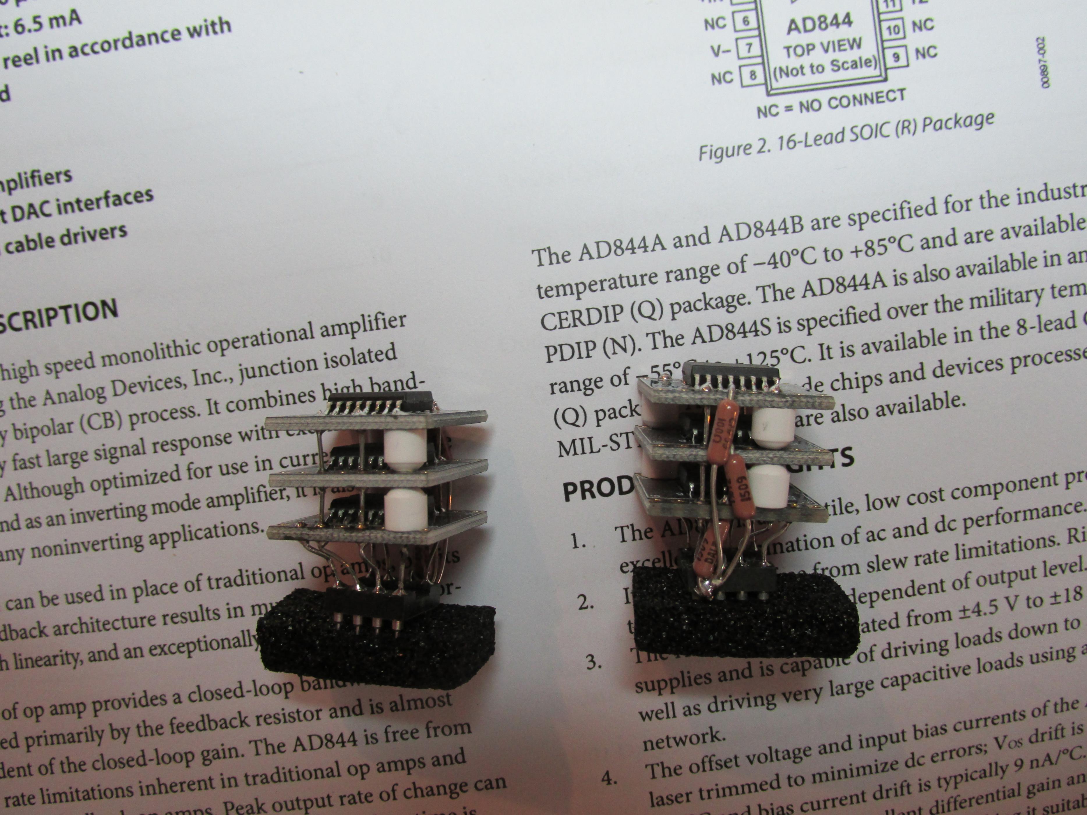

You could try it. The issue as I see it is the AD844 is current limited in the current mirrors. So running at minimum supply rails will likely be a handicap. The beauty of DIY is there is no reason not to give it a go. Build it and see if you think it meets your expectations. Die heating was likely the design constraint and why the current mirrors run so lean. In my triple stack I choose to build it with the SOIC 16 package. The larger die in my mind means less heating. Here is an example of my solution. For practical reasons I keep my rails at + and - 12 VDC.
