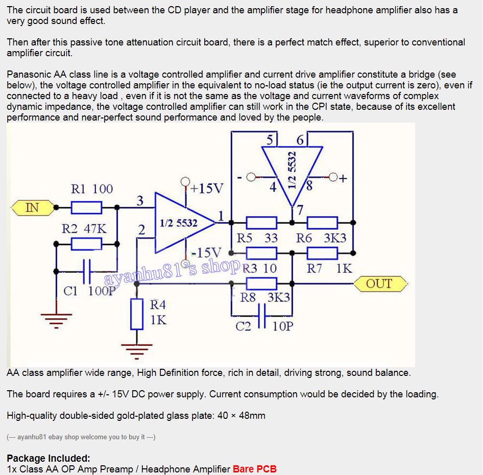

This looks like a interesting buffer to make for the 844 using dual maybe opamps for ease.
I would though use fet input opamps so the 844's TZ output has higher impedance to look at and change the input so the TZ sees 200k, load.
http://www.diyaudio.com/forums/analog-line-level/155143-class-aa-opamp-schematic.html#post4654086
Cheers George
George
I recognize the ebay seller name in the schematic. If this is still available then I think we can get it ready made for very reasonable price from ebay.
Cheers
Cheers George
The pcb for this one is available on ebay for 4 bucks including shipping 🙂. It seems that many people have bought it.
