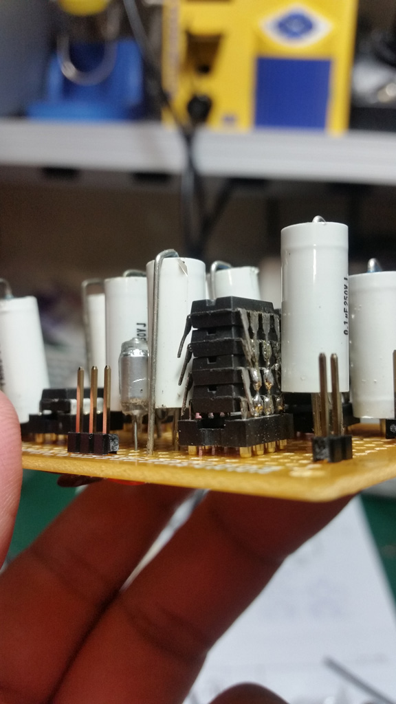

Leave all pin 6's float, never tie them together, if using an external buffer.
Only if you want to use the 844's buffers stacked, don't tie them directly together, they each need a series 100ohm isolating resistor on each leg then the other side of the resistor can be together and the output taken from there.
Cheers George
OK. First thing to do tonight. I turned on my DAC for run-in. I hope those AD844s aren't damaged or anything. Now, I need to find a way to isolate those pins.
Stacking...
Thanks for the warning. I will try to isolate those unnecessary pins tonight. I am not using pin6. Do I need to un-tie it also? As George has mentioned, pin 2,3,4,6,7 can be tied together. BTW, I didn't look into buffer OP yet. I tried single AD844 without problem, and then staked them for listening.
You need pin 5's tied together as well. Pin 6 should float or be through 100 Ohm series resistors. If you are going to try that output. 😉
Are they running "HOT"? If not, they are likely OK.
No, they are just fine. Maybe I was lucky. The stacked AD844s I have are having the same date code. (The other 4 are different, but still matched)
It turns out the easiest way to un-tie those pins is just to float them. I tried heat resist tape, duck tape...etc, but this is the best in my opinion. No one will open my DAC anyway. It should be safe.

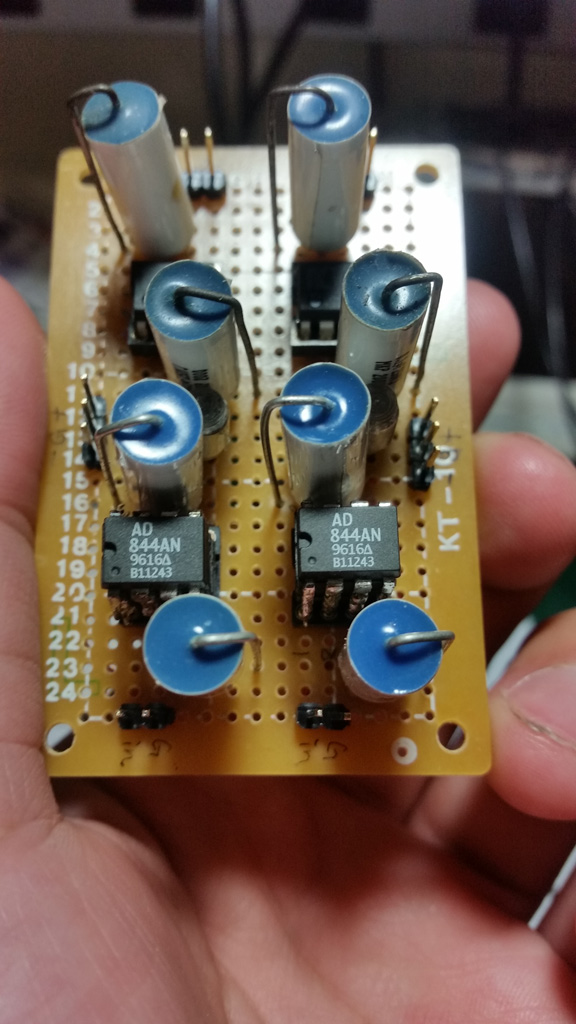

AD844 Fakes...
One pair is in the photo in post #1381.
I have two other pairs that look like in this photo
https://lh3.googleusercontent.com/P1WEm2oJL3Hc8KPJRQtAWqbo6MBp7QxC6za_k6JrKrQ=w747-h561-no
Could be late production.... Here is the thing. I have some older ones and they have a softer dull labeling. I also have a few in Cerdip package. Only a true AD844 can be applied with the pin 5 TZ no negative feedback scenario. No other chip features that. Test each chip as a solo (not a stack). Make sure they work as a single pin 5 output. If they work they are real. I have not actually seen a fake AD844 to date. Doesn't mean they are not out there.

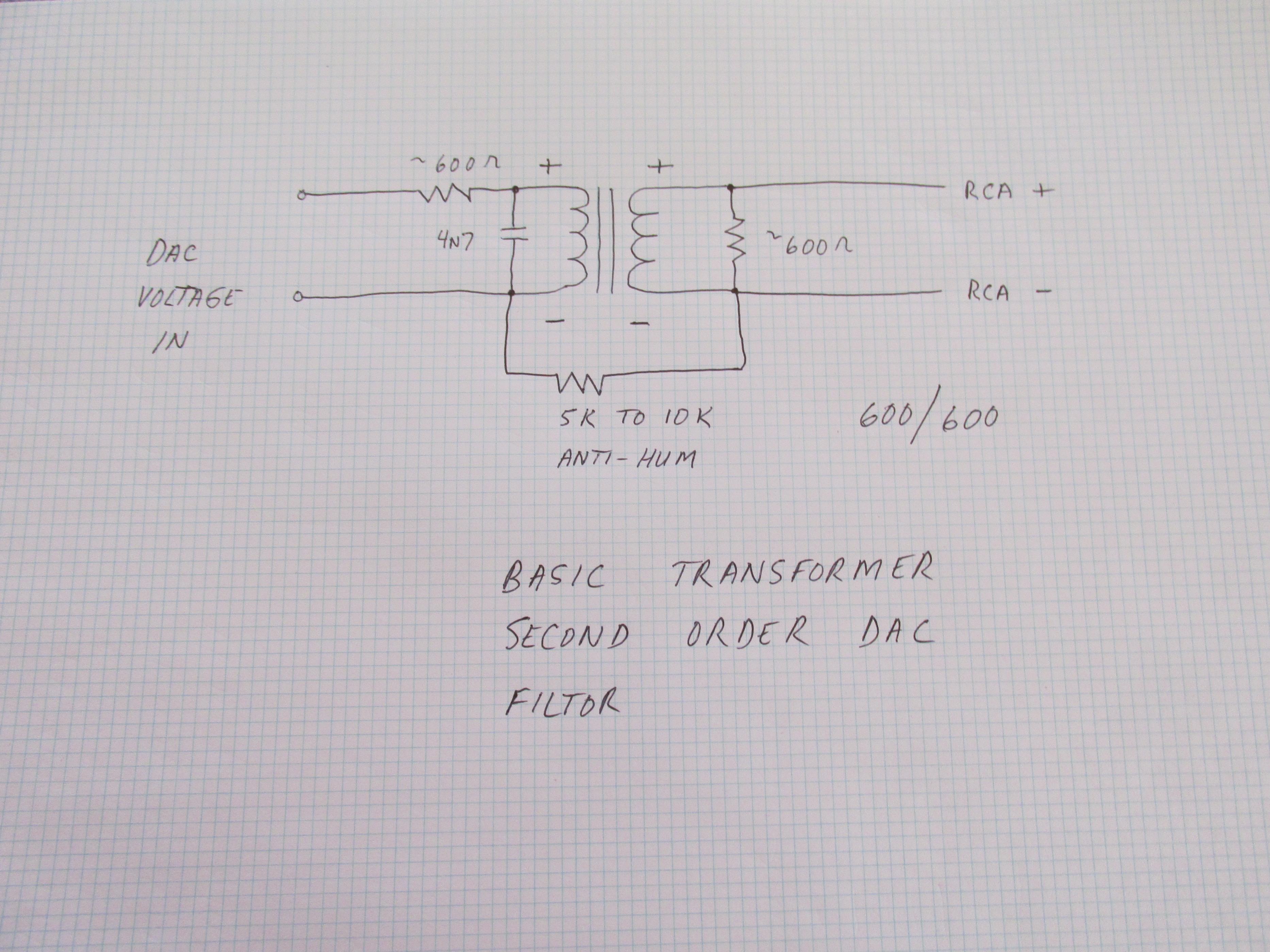

Hi canvas, Good caps... I agree with you. Even in the USA good caps cost far to much. The ideal situation is to only use them if you must. I like the Audio Cap Theta PPT's from Parts Express. Around $8 US Dollars for each piece. That is for the 0.1 uF value. Still very expensive although I have some NOS (new old stock) Teflon caps in that value that run $50 a piece these days. I still prefer the first cap. Cinemag filter.... You can also use Lundahls (!$!), Edcors or my favorite Cinemag transformers as a filter. Wire the primary with a series ~600 Ohm resistor. The 4n7 Cap will go across the primary winding. On the output winding place a ~600 Ohm resistor across the secondary. Wire to RCA on back panel. I'll have to check my files to see if I have a schematic to upload. As a picture helps. The cap with the inductance of the primary winding forms a second order roll off function. I have found no downside to using input transformers in this way. If you can hear RF rubbish in your DAC this will filter it. Some transformer like a 3n6 capacitor so measuring it with test tones and an oscilloscope is worth while. Output op amps... Not that familiar with the more modern ones. I will look into that. Thanks. 😉
Simple second order passive filter
Hi canvas, Here is a simple schematic. Another nice thing about transformer based filters is it allows balanced to single ended conversion if needed. The 5K Ohm or 10 K Ohm resistor provides a path back to ground to reduce hum if it is encountered. Not a common issue. Hope that inspires you. :devily:
Thanks for the schematics. It's helpful. As you mentioned, it's a filter. I assume you are passing the signal to a preamp? I do not have a preamp. Should I put the trafo between AD844 and the buffer?
Filter....
I use that right behind the buffer. So it does go between the DAC and preamp. However depending on your setup you could place it between an I/V and the Buffer. Input and output impedance is about 600 Ohms. So the load is fairly light. Can also be useful in situations where you have excessive RF hash. Typically it rolls off at 19-20 Khz at a second order rate. Usually quite adequate for most DAC applications. Avoid placing high idle currents through the transformers. They work best with no more then a few mV's. I have used the cheap Edcors in this schematic and they work well. Lundahl LL1690's like 4n7 changed to 3n6 for the same roll off. 🙂
