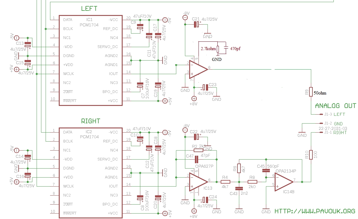

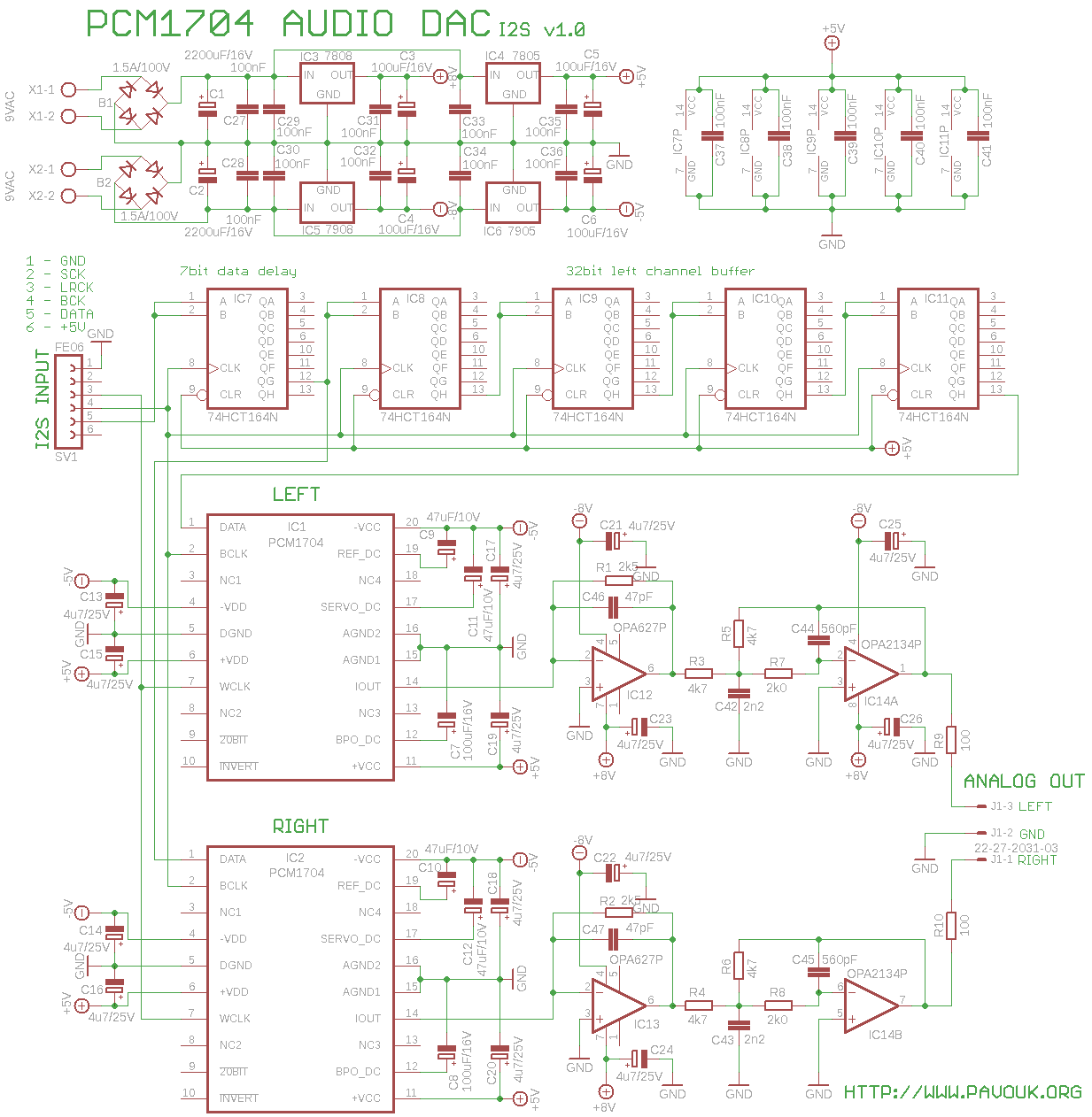

I'm just finishing up this circuit (see attached) and notice that this thread started when George was looking at the PCM1704 from the datasheet circuit. In terms of swapping out the OPA627 (IV gain) and the OPA2134 (LPF) - would the AD844 actually be a decent choice, or are serious modifications required first?
Left channel only done, using the 844's own buffer for the output. Don't forget to stack 2 for the PCM1704, read previous posts for stacking the iv stage only not the output buffer. You may have to use the dc offset nulling circuit on pins 1 and 8, depending on how close to zero dc offset your 1704's are.
Cheers George
