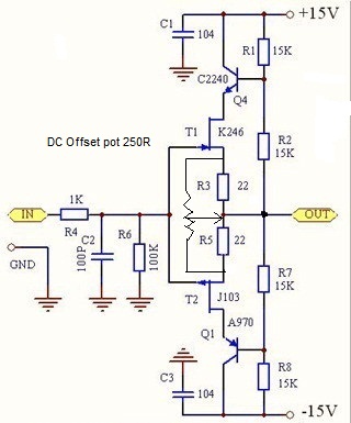

Here's an experiment to try - slap a couple of hundred uF in 1206 ceramics between the 844's supply pins and listen again to the internal buffer.
I tried this one (attached), but the BUF03 was better. There are similar other buffers, but from what i saw they all have global feedback, I'm not sure if it is this lack of global feedback on the BUF03 that makes it sound so good to me.
Cheers George
Cheers George

That's a pretty dumb buffer on a few levels.
You are much better off sticking with P & P solutions like BUF03 if you are
getting great results.
It does take a fairly deep understanding to optimize discrete circuits for a
given application and get the best outcome. If you are just P & P'ing
discrete circuits but don't know what too look for and tweak, you will waste
a lot of time trying to get there.
I think i'll try that. Is X5R good enough?
Yeah X5R is fine. The reason I said a few hundred uF is they all lose appreciable capacitance when biassed up. Some of the larger values (I'd not go above 47uF myself) lose 90% or so at full rated voltage. I recommend TDK and Samsung as the brands giving the least drop-off with applied voltage.
