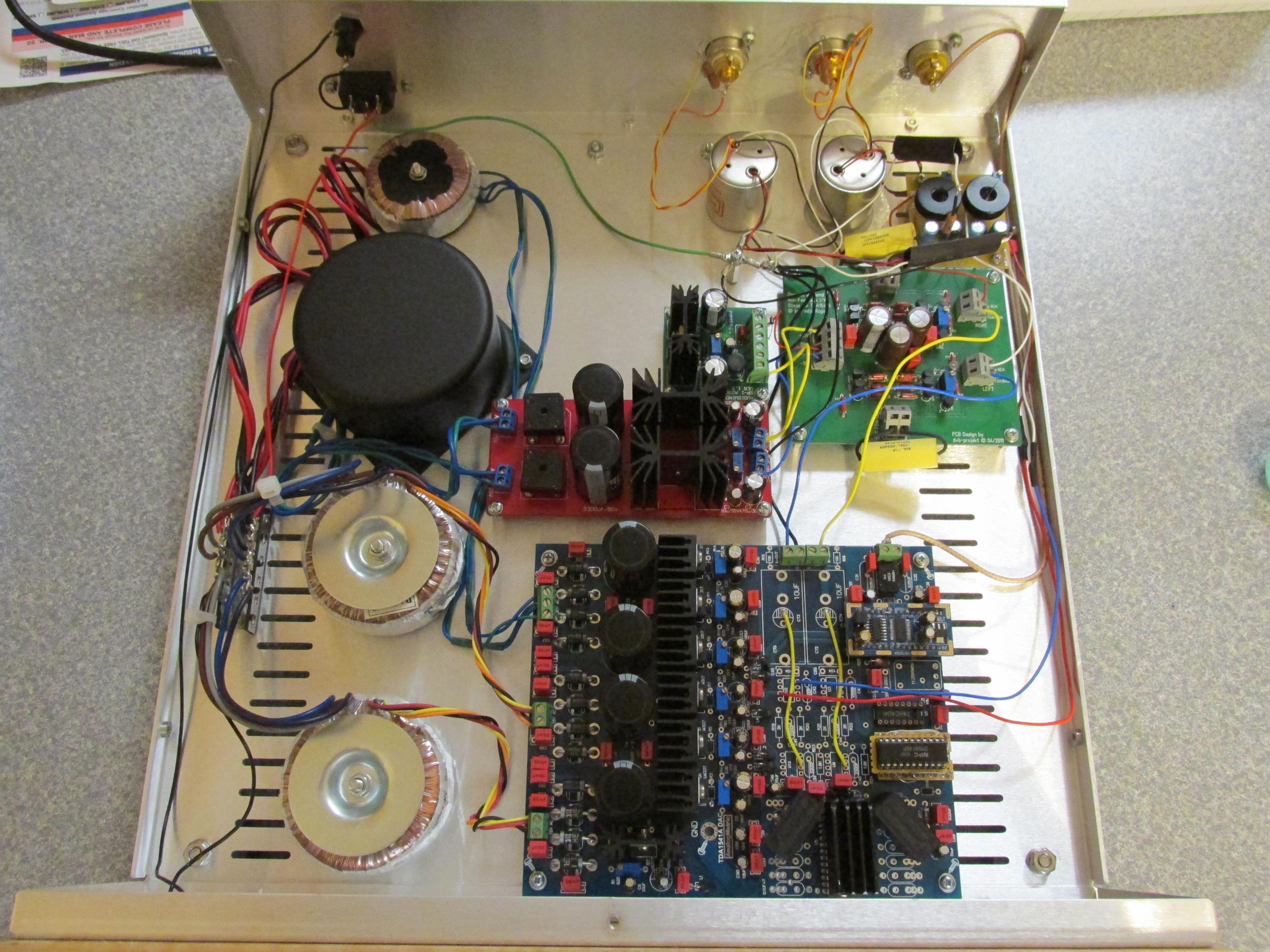

Triple stack VS Discrete Pedja diamond I/V
Hi all, I finally finished the second dac. I spent the last week going back and forth listening. The digital side is for both is.... DIR9001, NPC SM5814 (digital filter), TDA1541A S1 Crown. Both have Cinemag based passive filters. Both are buffered with the AD BUF03. So the difference is down to I/V's. Triple stack: Super powerful. Dynamic. Vocals are clear with a you are there sound. Slightly forward presentation an attribute common with the 1541A. Good details. Sound field comes from a black velvety background. The bass is mighty. Pedja's discrete diamond circuit: Open sound. Sound stage is pushed back a bit. Vocals are clear and articulate. Everything in the mix is easily heard. Sound comes out of nothing. I don't hear the velvety black background at all. Frequency response sounds flat from bass to as high as I can hear. It is a joy to listen to. I can't say it is as seductive as the triple stack. I miss some of the dynamic attack. No clear winner. A matter of taste I'd say. I like them both..... So the question might be which one is high end sounding. Based on what I hear I'd say the discrete circuit has a slight edge. I like how I can hear into the mix. I hear things more clearly. My system for reference is the Magnepan MG2.5R's, Nelson Pass BA-3 pre, Class D Audio SDS470 300 WPC amp. A recording I liked for this test. Roger Waters "Amused to Death" for its holographic sound field and low level sound effects like radio and tv sounds. I also used remastered Beatles, Pink Floyd. Jazz and Blues recordings. So I am expressing an opinion only. Your results could be different. :)

I have never seen why there should be a need to stack 844s if you do it right - make the current go direct to ground at around 3R and the 50R input will see so little current that stacking is not needed. It will be like stacking 15 x 844s. The level will be lower, just increase gain of 844 on Pin 5, it is low noise, so gain can be increased substantially.
Cheers, Joe
Joe, go back and read a few more pages around 20 pages ago, it's not just about input impedance being halved with stacking, which was a plus, it also eliminates the 844 going into current saturation on loud passages and transients.
