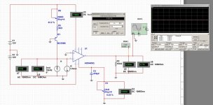

Has anyone tried to use the AD844´s TZ pin´s gain resistor as a form of volumen control ?
It seems to work in my simulation. Maybe noise would be an issue ?

For one thing, DC shifts too much to make it work in practice. Any input offset will change DC on the output as you change gain.

Lowering the resistor on TZ pin will only minimize the output dc offset, so I think you are wrong here.
Simulation in Ni Multisim works flawlessly changing this resistor to lower values and thereby changing volumen!

Joe is saying that any D.C. offset appearing on the TZ pin will be modulated whenever the volume control is changed. This will produce audible low frequency transient noise while the varying D.C. offset charges any output coupling cap. to the new D.C. value.

Perhaps but the offset is very very low, so I dont get your point?

I suspect it won't be small. But by all means try it. I can assure you, I would have done it in the past when I constructed some microphone preamps (studio use) using 844 and needed variable gain. I could not direct couple as I needed to have multiple gain settings. This chip is very flexible and makes the basis for high quality zero feedback preamp design. But varying Z on both input and TZ changes (or as Ken says, modulates) DC shifts.

Well today I had a little time to simulate some more on the AD844 and with different values on the TZ load resistor. And I have added some pictures to share below. I the simulation I used the TI PCM1795 as my current generator (+/-2mA FS, -3.5mA Zero offset current). Used a simple common base PNP as current source to null out the -3.5mA. Seems to work well in the simulator.
Then I adjust the emitter resistor of Q1 to trim the current to get near the 3.5mA. but also to null out the DC offset on the buffered Output (pin6).
I configure the AD844 in the Openloop configuration, and I connect a 2K resistor (potmeter R1) to Pin 5 (TZ pin)
Here is a series of simulations, where I half the resistor each time. (eg. Volumen control).
Sim1: R1=2K resistor Frequency for all simulations is 7kHz +/-2mA. Vout = 2.8Vrms, DC offset = 0.82 mV, THD@7kHz = 0.002%
Sim2: R1=1K ohm.
Sim3: R1=500 ohm.
Sim4: R1=250 ohm.
Sim5: R1 = 125 ohm.
Sim6: R1= 62 ohm.
Sim7: R1=31 ohm.
Sim8: R1 = 16 ohm.
Sim9: R1 = 8 ohm.
Sim10: R1 = Zero ohm.
As you can see the DC offset get lower each time it R1 is halved.
Now my question, why would this not work in real life, as mentioned earlier ?
If there is some DC offset on Pin 6, due to temperature drift and what not, an series capacitor is an easy fix I would reckon.
On the other hand, If it works, it is a pretty nice way to implement volume-control on any current DAC 😀

There is another big snag, when you vary the TZ resistor your also going to get a different HF roll off because the TZ cap will remain constant, so if you set up for -1db @30khz as I do and then halve the resistor value for less volume without doubling the size cap as well you'll let much more HF crap out to the output buffer and onto the amp/s.

Here is some -3dB bode plot for very low R1, 500 oh, 1k and 2k ohm.
I don´t think that is a big concern, ? One could and an RC filter after the buffer..
It was to me in practice, as the highs were notably harsh if the rolloff was too high, letting through lots of rubbish.
As for the dc shift with changing of the TZ resistor if it becomes a problem, you could if you devised a dc servo to change slightly null points offset setting on pin 1 and 8 thus changing the 20ohm null pot electronically as the TZ resistor is lowered.

- george, was your amplifiers after the AD844 traditional power amp with fair amount of global negative feedback ? This could explain if it started to sound harsh, when to much HF get into the amplifier.
Was your DAC a non OS type ?
I intend to use AD844 as I/V in my ASUS Essence One, 2xPCM1795 in dual mono config (8 x AD844 needed), with oversampling. So the DAC out-of-band noise is pretty low. Volumen control via Pin 5 will not be part of this project.. to much of a nightmare with so many AD844.
For 2-3 years now I have been using passive I/V in the ASUS E1, which sounds very great. (about 180 ohm, 360mVrms from each DAC output) I also has added a singled ended buffered output of this passive converted signal, so I can listen to music that has not been trough any opamps. This is a marvel to listen to!

You could couple the Tz pin to the pot through a capacitor, and have a fixed resistor for the Tz DC bias.
How would that work?
At any rate, the issue is exactly the same as any preamp stage with offset needing ac coupling, no?
Jan
Need to see specific R values that would work, maybe the cap size would need to be too big?
Maybe just figure out the range of DC shift on the output and put a cap there - in which case, just put the pot on the input, the Tz value fixed, then RC on "+" input and null the DC on the output as the 844 has that facility. If you are going to use a Tz cap, then a cap is a cap and maybe if a cap is needed, then put it on the input.
I know it works because I have done it.
