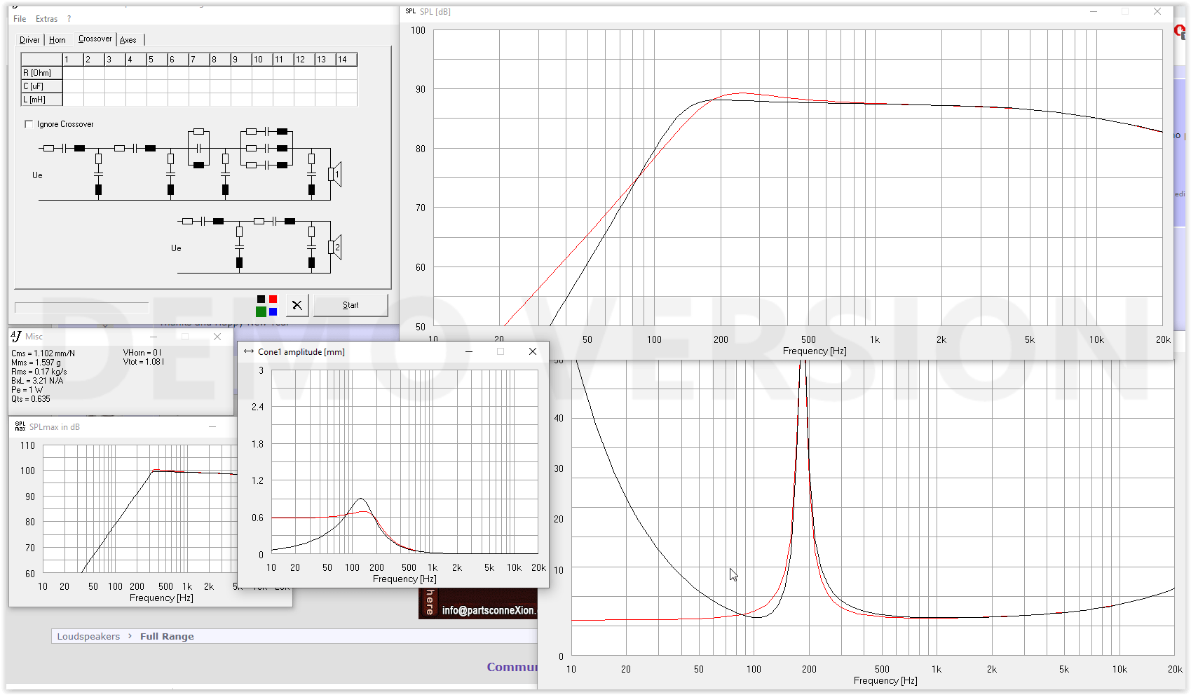

The Variovent-ish + uF enclosure, was made with a small 1 cm diameter hole in the enclosure, stuffed with damping material. I tried to have my cake and eat it. I wanted a smaller enclosure and flat impedance for use with a tube amplifier. The Qts of the Peerless 3 inch is 0.89, closed box would have been 4.7 liter... Computer said yes, so i tried it, and it worked very well.
I can not speak for others, but i use the closed box + capacitor trick mainly to get smaller enclosures, with high Qts drivers and low tuning, enclosures can get very big. Also more subjective, i don't like the Q 0.5 closed box sound, the cap gives a wee bit more subjective pressure. Somewhere between very dry closed box and the woomp of bass reflex.
This is the TB in 1.08 liter, with and without capacitor, excursion is higher with the series cap:

An in-line cap is a highpass filter, ish. Output is reduced below ~0.7x Fc (resonance of driver in cabinet).
However, just below Fc, you get a boost from the interaction between the cap and the rising impedance. The impedance presented to the amplifier is lower, so more current is drawn.
In a way, it's another form of EQ. Quite useful, though, in the right circumstances.

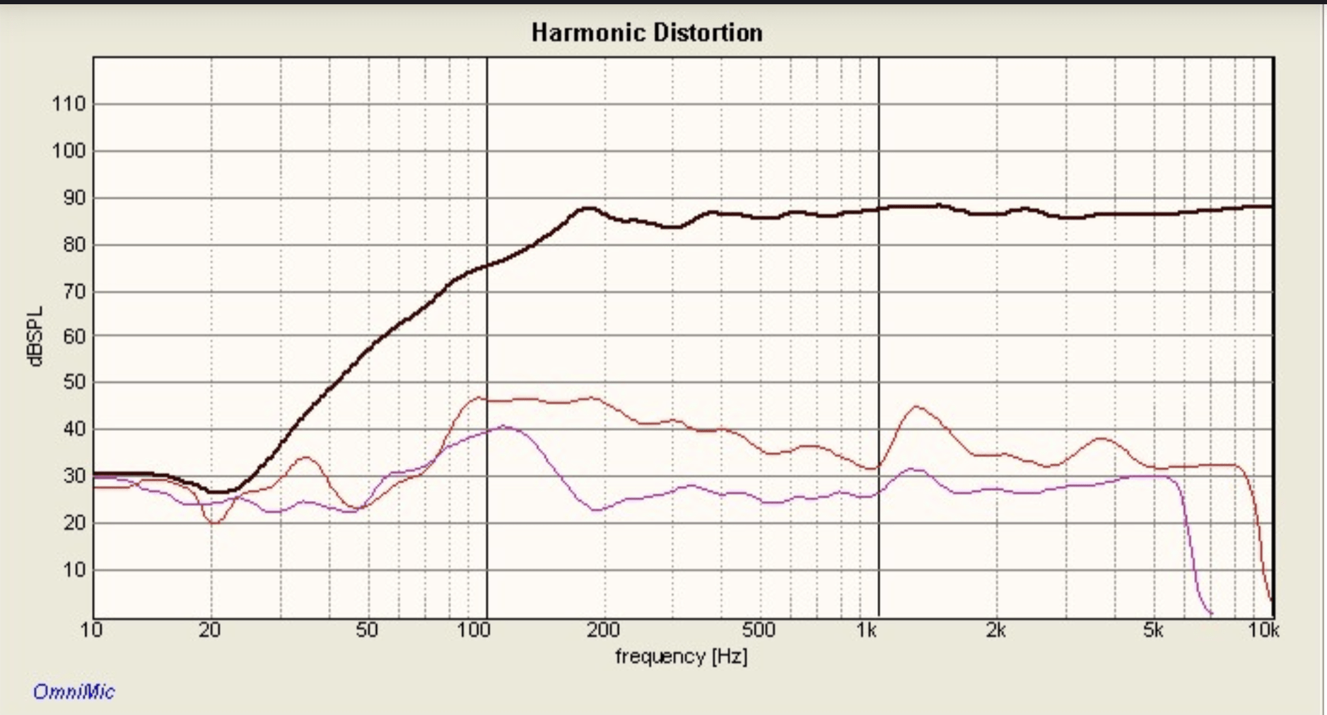

It was not intended negative, i just don't know how the TB's will react, distortion, soundwise. Does the THD peak below 100 Hz or 200 Hz. This data is missing to say something meaningfull, or predict the outcome 🙂
2nd order harmonic distortion does increase below 200hz(doubling), but it's the 3rd harmonic that increases below 150, peaking at 125.that I'm most concerned about. The large series cap is supposed to reduce output below fc- wouldn't that help? (TBH, I don't actually know where I need to set the crossover point, at fc, F3, or higher up in frequency, w/sub @ / below 160hz)
Is the THD graph from this Tang Band? I am used to seeing THD shooting up below 100 Hz, for 7 inch drivers, let alone a 3 inch. I do think, the precise crossover point should be selected by ear. Or at least it would be impossible for me to give an precise answer in Hz / oct. And would be very suspicious if some would chip in and gave you a precise advice.
I see. Just want to understand how to get these drivers down to 150-160hz to mate with the subwoofer below, much as I was doing with my other satellites (single 5" sealed and also a 4" ported model). Or if I were to leave it 2nd order would there be enough overlap?Is the THD graph from this Tang Band? I am used to seeing THD shooting up below 100 Hz, for 7 inch drivers, let alone a 3 inch. I do think, the precise crossover point should be selected by ear. Or at least it would be impossible for me to give an precise answer in Hz / oct. And would be very suspicious if some would chip in and gave you a precise advice.
The graph I posted is the only one I could find online and is from a similar Tang band 3" full range:
Tang Band W3-1364S
which looks a lot like the one I'm using (same cone, surround and phase plug). Specs are not too different as well. Do you think the distortion characteristics would be very different between similar models? Unfortunately, I don't have the gear to measure this myself, and I guess I'm grasping at straws.I don't know, THD between different drivers can be wildly different. Just try it 😉Do you think the distortion characteristics would be very different between similar models?
I'm going to throw 4 of them intoa 4.5x5x30 inch box I have on hand and listen.i will also attempt to measure using an app on my old iPhone.I don't know, THD between different drivers can be wildly different. Just try it 😉
