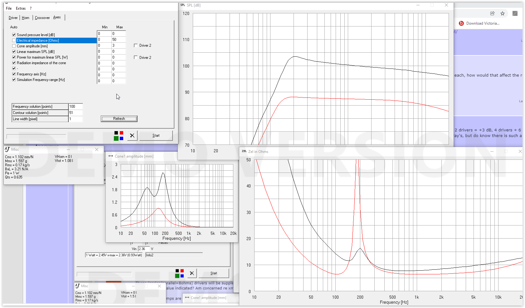

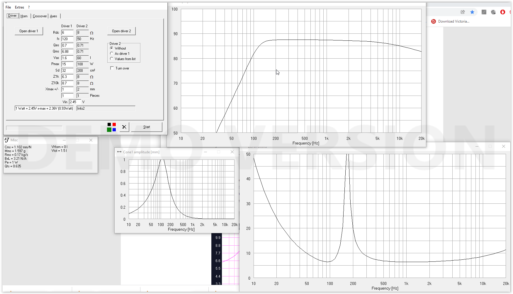

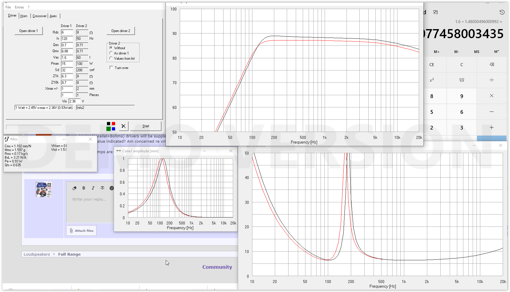

The Variovent-ish + uF enclosure, was made with a small 1 cm diameter hole in the enclosure, stuffed with damping material. I tried to have my cake and eat it. I wanted a smaller enclosure and flat impedance for use with a tube amplifier. The Qts of the Peerless 3 inch is 0.89, closed box would have been 4.7 liter... Computer said yes, so i tried it, and it worked very well.
I can not speak for others, but i use the closed box + capacitor trick mainly to get smaller enclosures, with high Qts drivers and low tuning, enclosures can get very big. Also more subjective, i don't like the Q 0.5 closed box sound, the cap gives a wee bit more subjective pressure. Somewhere between very dry closed box and the woomp of bass reflex.
This is the TB in 1.08 liter, with and without capacitor, excursion is higher with the series cap:

An in-line cap is a highpass filter, ish. Output is reduced below ~0.7x Fc (resonance of driver in cabinet).
However, just below Fc, you get a boost from the interaction between the cap and the rising impedance. The impedance presented to the amplifier is lower, so more current is drawn.
In a way, it's another form of EQ. Quite useful, though, in the right circumstances.

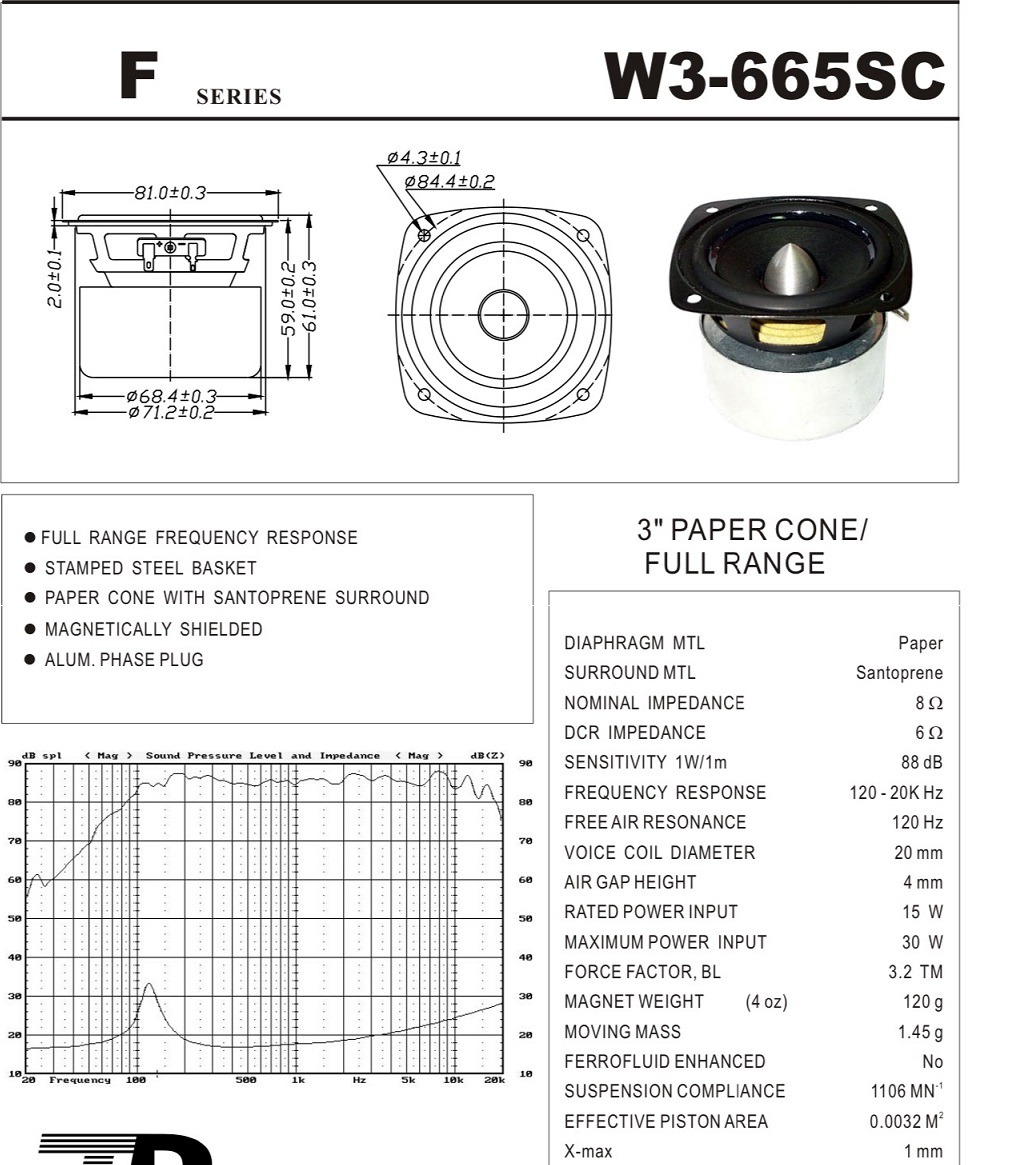

The graph I posted is the only one I could find online and is from a similar Tang band 3" full range:
Tang Band W3-1364S​
which looks a lot like the one I'm using (same cone, surround and phase plug). Specs are not too different as well. Do you think the distortion characteristics would be very different between similar models? Unfortunately, I don't have the gear to measure this myself, and I guess I'm grasping at straws.
