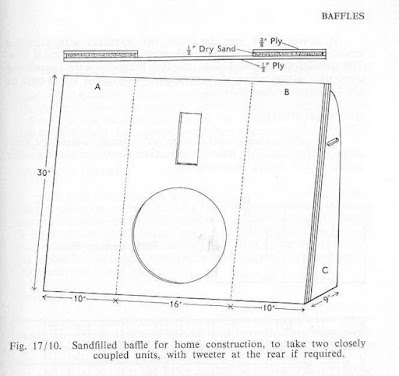

Here are DIY vintage french project that use sand filling. The first two are horns that closely ressemble the Altec 511 and the other is an Onken W bass enclosure.
Pavillon 1" en bois sablé (J.Le Dauphin)
Construction des pavillons sectoriels en bois sablé.
Caisson W sablé (G.Philippon)
