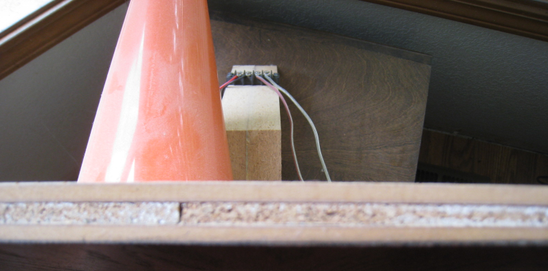

i used cd postage cardboard boxes filled with sand and then glued inside the box.
however today I prefer concrete pouring side after side into the box (thin wall wood for looks only)

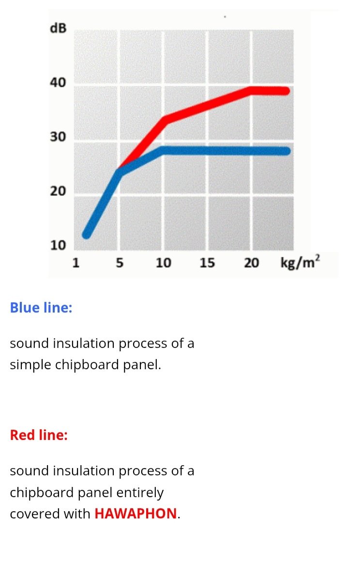

Another known effective method "constrained layer damping".

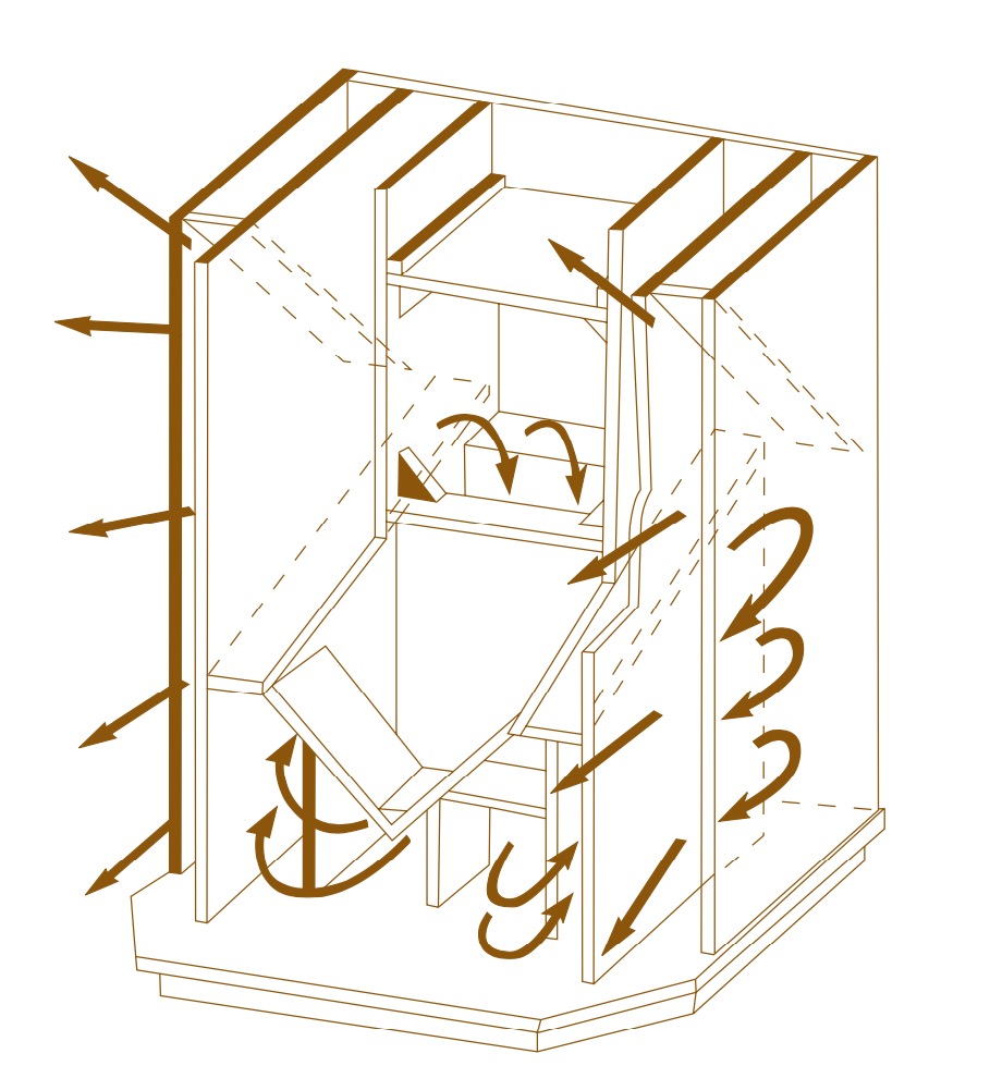

It was the TensorAlpha
https://www.adam-audio.com/content/uploads/2016/12/adam-audio-user-manual-Tensor_Alpha_active-1.pdf
