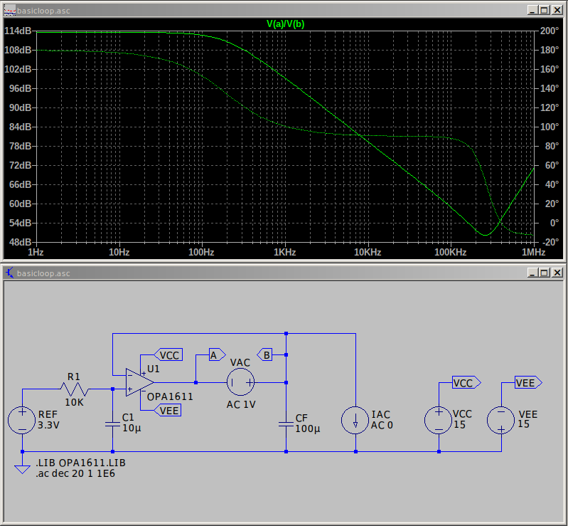

From the two above .zip files there will be a .lib file. Place them in the directory where you set up your LTSpice model. Open LTSpice and make a new schematic. Place an opamp2. Give it the name of the model with no extension, LM1611. Place a .LIB LM1611.LIB spice directive. Connect other parts and simulate.
OK... it's in the attached .zip file.

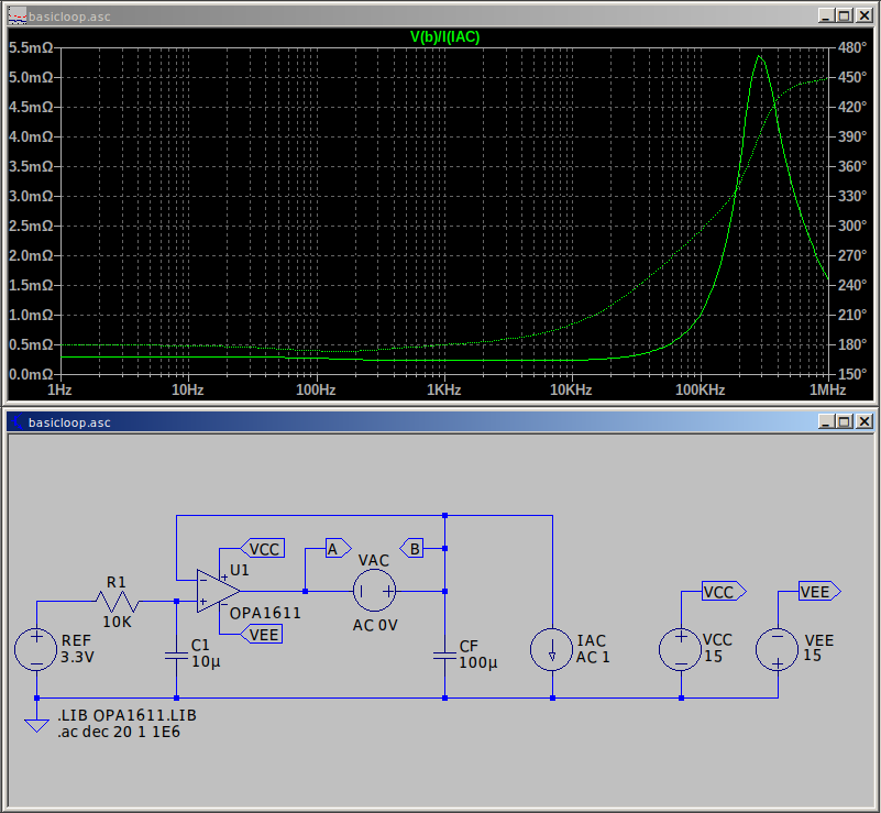

Use VAC and plot V(a)/V(b) to get the loop gain. Use IAC and plot V(b)/I(IAC) to get output impedance. Set the one you are not using to zero. You have to right click on the axis to get linear vs dB and turn phase on and off.
You can add ESR and ESL within the capacitor model or model them as external components. The same for traces if you find one of those web calculators.
Have a play. Shout if it goes wrong.

Thanks very much for simulating that! Things just got a tad clearer for me...
I'll take a step back though and explain why we arrived at the values for the caps that were chosen as of now. So what is it that we are seeking for? Well, the ideal voltage source which has zero output impedance over the needed frequency range. As zero is not possible, let's look at a more realistic approach.
The ESS has 0dB PSRR on the AVCC pin, it's a reference voltage. So to achieve a SNR of 125dB for example the noise voltage on the AVCC pin must not exceed 3.3V/125dB which equals 1.8uV. if we say the current swing demanded by the AVCC pin is 8mA the output impedance of the regulator must no exceed 0.2mOhms or otherwise the current will modulate the voltage by more than these 1.8uV (Hope there is no error in my calculation). Even if I would use an Opamp with no capacitance at all it will not be able to have such a low Zout over the whole frequency range that we need it to operate at. Keep in mind that this is a SD DAC which modulates in the MHz region. So we quickly came to the conclusion that there's no way we would get away without a cap across the AVCC supply. So we did quite a long search to find a suitable capacitor combination that a) does not induce resonances from the package inductances and will b) have a low impedance over a wide frequency range. That's why we ended up with a 1812 10uF MLCC in parallel with a four terminal feedthrough cap from TDK, 0603 package, 4.7uF.

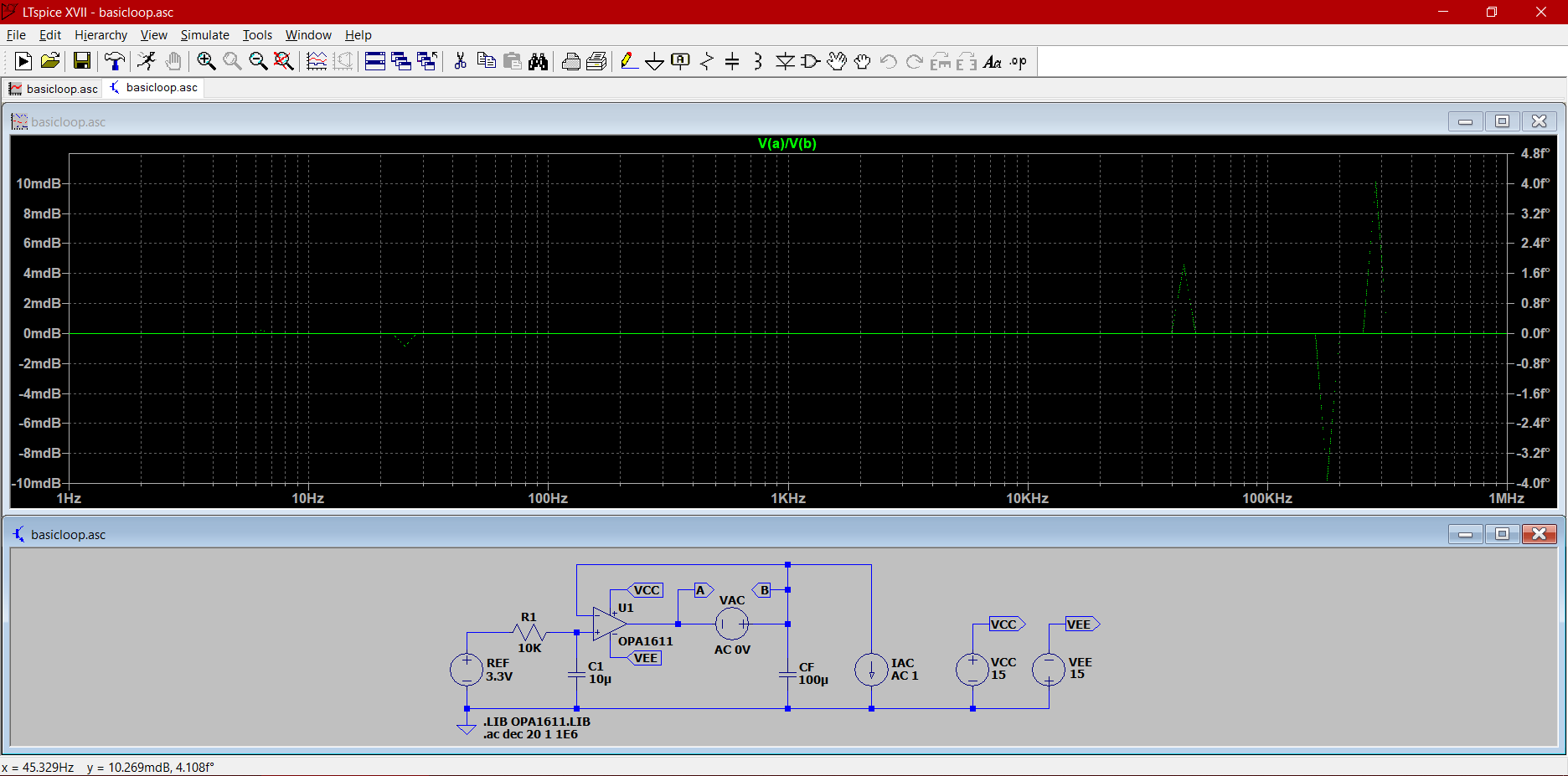

@MorbidFractal: I just installed LTSPICE, opened the simulation files you provided and got a weird result (attached). So I guess I have to adjust some simulation options... I clicked through them but can't seem to find anything obvious. Probably bloody beginners fault 🙂
Depending on the analysis you are doing you have to set VAC or IAC to 1 with the other being 0. In the one your picture shows. Set IAC to 0 and VAC to 1. Right click. Click on Advanced. AC is on the upper middle right.
Oh... or you can just right click on the AC 1V and edit it directly.
You are measuring the voltage across a voltage source. Of course that is constant ...
