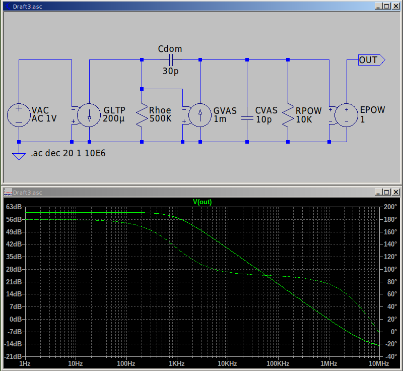

But back to the earlier simulation, the basicloop. As one can see in the gain/phase plot with the 100u cap you provided, the gain starts to rise again after some frequency. is that to be expected? What does this mean? And yet another thing, which _might_ explain the weird behaviour - should the cap not be connected between the output of the opamp and GND? In the .asc file you provided it's essentially connected between the negative input and ground, separated by the voltage source.

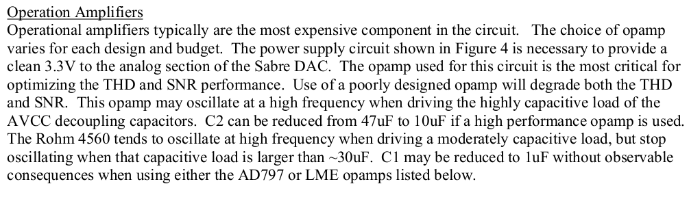

3. There seems to be at least some discrepancy between the theory/simulation and real world performance. AD797, OPA1611, LME49720 all seem to work with significantly higher capacitance on their outputs than the simulation suggests. Who's wrong and why? How much phase margin is actually needed to pervent an opamp from oscillating? From what I understand the step response becomes worse and worse with a lot of ringing if I approach 180° phase, is that correct?
Reality is the ultimate acid test, but if the phase margin is too low, stability is not sufficient and sim is a good indicator of what to expect.
Depending on how you see things and how the phase-wrapping of the simulator works, the stability is zero when the phaseshift around the loop reaches 180°, or when the phase difference between the input and output is 0°

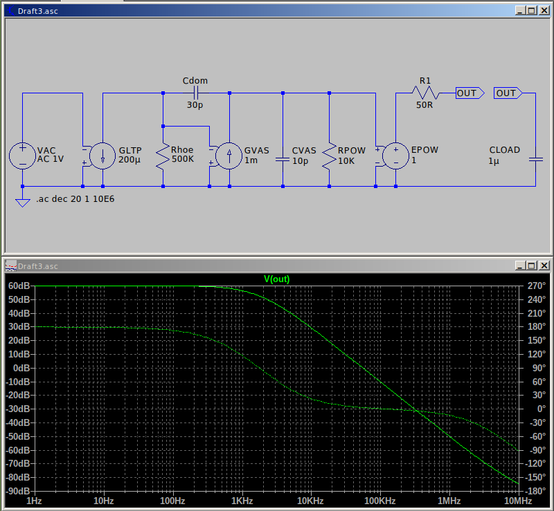

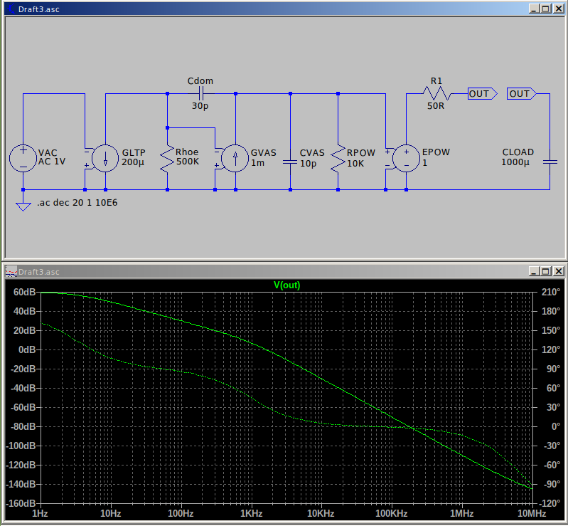

5. My buddy did a lot of the tiring task of simulating different versions of the schematic, he deserves all the credit for patience there. Attached is a probably working example of it, in which we tried to use real world capacitor values and some inductance for the lead from the reg to the load. I'd really like your comments on that. Is a phase margin of 8° considered enough?
8° would not be enough, but your sims are incorrect: for the impedance you cannot mix a current stimulus and a voltage on a different node (otherwise you measure transimpedance instead of impedance), and for the loop gain you need to break the loop at the point of feedback (split that node), not on different, existing nodes

1) Rumour has it that for critical damping you want to cross over first order with 45 degrees phase margin. That one assumes the loop is, can be, second order at half of and twice that frequency.
2) Your 8 degree figure results from the cursor being in the wrong place. You appear to have measured the minimum phase. What you should look at is what the phase is when the gain crosses 0dB. On the second picture that is where the phase has bumped back up to 60 degrees.

3. regarding the last statement: We turned off the voltage source and enabled the current source for Zout simulation and vice versa (Can be seen from the 0 or 1 value next to it in the screenshots). So I think this is in fact correct. Please correct me if I'm wrong.
I'll give examples of the proper (simplified) way of measuring loop gain and out Z.
I use a simplified setup and a native LT device for simplicity, but you can apply the same principles to more complex situations.
This the loop gain:
attachment.php
And this is the output impedance:
attachment.php
