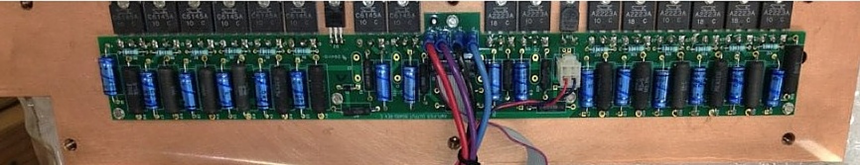

Hi, tommy1000 thanks the picture.This is the Momentum output stage, there is nothing special with the numbers of transistors. It has local decoupling dought. The Sanken BJT transistors are low cost.
Sanken bjt has good reputation at their good sounded amps from the past like luxman amps, sony, etc. And my 1st good sounded amp using sanken bjt both driver and ops, but most the driver blow in ~3years and changing the driver to toshiba make it sounds worse.
