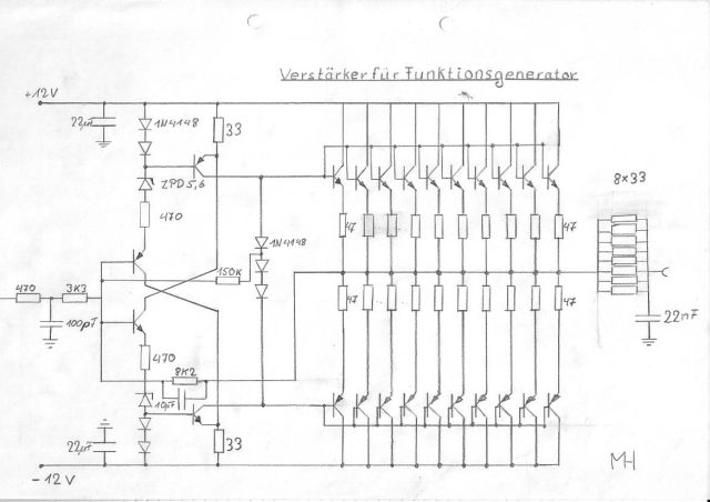

I used this approach for the output amp of an signal generator,
which had to work up to 1MHz.
10x BC550 & 1x BC560 biased with about 7mA each transistor
and operating from +/-12V.
It worked fine, but I have no idea how it would sound.
The attached schematic show the output amplifier, but please be
aware that the input stage is not good for HiFi, because the emitters
are referencing to the rails and any noise in the rails will be found
in the output signal too. For the signal generator it was OK.
For HiFi I would prefer some diamond input stage, which is referencing to signal ground !!!
Me too, just build some sort of power stage for function generator, mine went straight to 10Mhz. AD817 and emitter follover stage inside feedback loop. Stability, no problems.

But if the Ube of your transistors were quite different, and
you tried to bias with low voltage drops across the emitter
resistors it could look like like this.....
The BJTs with low Ube will carry the idle current while the others are
still passive. When paralleling BJTs you should select for identical
Ube, or work with with high values of emitter resistors.
