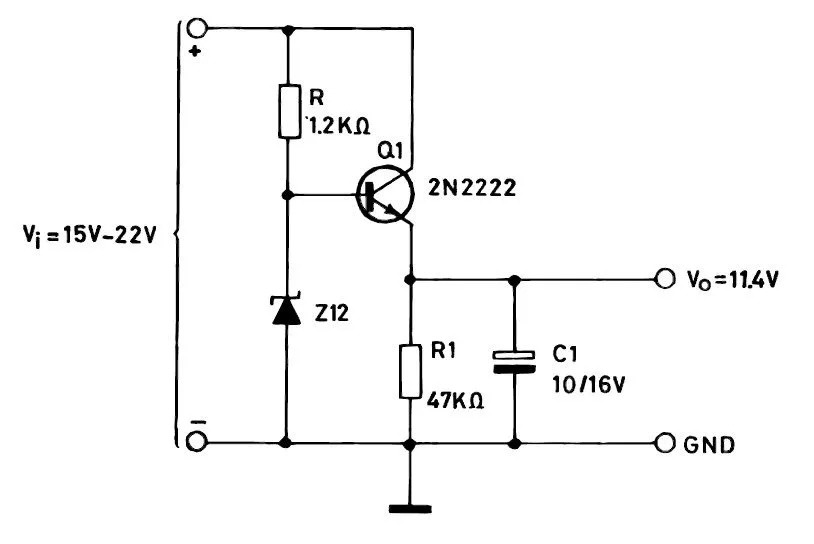

One could also make a simple zener regulator:
You can make a similar circuit with a PNP for a negative voltage. Of course, now you introduce a slight temperature dependence, both from the zener and from the BJT, but that shouldn't wreck anything.
I highly doubt you need much precision on those voltages. In fact, the schematic shows series resistors that take the +28 and -19 V and turn them into +24 and -18 V in the preamp section, so the tolerance on the voltage in the preamp section is worse than ±5 % already.

Until the input voltage glitches beyond the sum of the two zener voltages and fries the zeners and the regulator. 🙂Using a zener to drop the input voltage to reduce the dissipation needed, and a zener across the input-output pins to protect it from over voltage at startup, would that not satisfy both issues?
I personally find it much easier to dissipate the power in a TO-220 bolted to a heat sink than in a DO-41 or similar Zener diode.

The input voltage doesn't rise to 40 V instantaneously. As it rises, so will the output voltage of the regulator, which limits the voltage across the regulator. If you further protect the regulator with a 39 V zener there shouldn't be any issues unless someone short circuits the output of the regulator.
