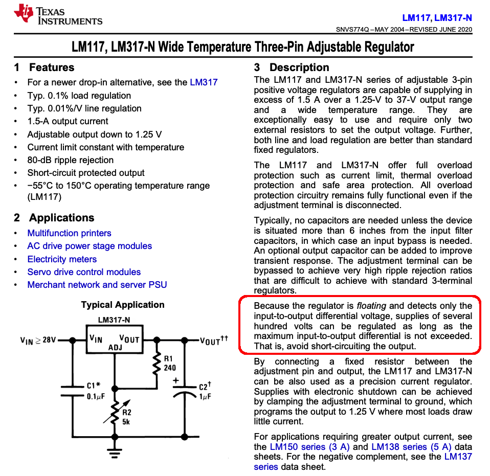

Consider reading
If you have any relevant capacitance decoupling cap in the circuit you are supplying there will be a high in/out voltage difference.
Output voltage always starts at 0 V and only then rises. That could exceed the maximum allowed value.
Same with an eventual short (or current at regulator limit) after the regulator.
True, but you have to analyse what happens at start-up then: how fast does the input voltage rise, how fast does the output voltage rise and does the difference between them stay small enough at all times, even when the mains voltage is 10 % above nominal and the amplifier is switched on at the most unfavourable phase of the mains?
True that. Startup, shutdown, and error conditions need to be considered.

The input voltage doesn't rise to 40 V instantaneously. As it rises, so will the output voltage of the regulator, which limits the voltage across the regulator. If you further protect the regulator with a 39 V zener there shouldn't be any issues unless someone short circuits the output of the regulator.
