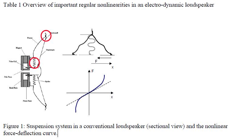

There is a really good paper I have but I am not sure of who posted the link to the paper discussing the various factors in loudspeaker nonlinearities. The title is as follows: Loudspeaker Nonlinearities-Causes, Parameters, Symptoms by Wolfgang Klippel, Klippel GmbH, Dresden, Germany, Klippel@Klippel.de
Thx glad I found it. This confirmed what I thought. You have primary distortion issues and all the rest. But first you need to eleminiate (or as good as it gets) the primary distortion issues before you get to the rest.
Kms(x) Bl(x) Le(x) Le(i) etc...
As first they mention the nonlineair suspension. => that is why i replace it with a full lineair suspension. So I think if you can improve the main problem and you have to sacrifice (not as much) a less critical problem then it would be better. Today I tested the lineairity of the EM suspension and it is 95% lineair till Xmax. As it is current driven it will not distort (also not improve) anything (of the primary distortion parameters). It eleminates also the resonance freq of the surround and also of the spider (two peaks).
Question. since it is current driven (DC) would it generate a second resonance frequentie (peak) on it's own? I think it would shift the primary resonance frequentie but not a different one. Am i correct?
Jef,
You have to remember that each speaker has its own set of compromises. Most speakers have a limit to the maximum excursion and this is commonly handled by using a rising rate spider that will slow the cone movement as it approaches the limits of the excursion. You also have to make sure in most designs that your former does not hit the back plate and this is the intention of the bumped back plate. The surround is also a contributor to the non-linearity and with common surrounds there isn't a lot of room for change. You have to have some form of surround for centering the outer diameter of the cone and also to attenuate the wave traveling along the cone as it reaches the outer diameter and wants to be reflected back at this point. So the choice of surround is at least as important as the spider selection for multiple purposes. Most 1/2 round surrounds will have a fairly limited excursion limit unless the outside diameter is increased to allow more cone movement. But then you have now introduced another problem, this surface area of the surround is often in antiphase to the cone output, the larger the surface area the greater the phase problem. If you use an M-roll or W-roll these suspensions are often much stiffer than the 1/2 round surround and now you add added stiffness to the suspension and need to add mass to the cone to counter this affect. It is all a series of tradeoffs, what can you live with and what is important to you. There are no magic bullets here.

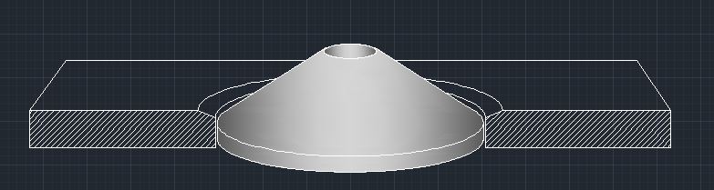

Jet,
Though you say there is no surround that is probably a miss statement of fact. If there is no way for the outside of the cone to move in and out how can it move period. If you are using the cone itself as the surround, the same material that forms the cone itself you will find the problem when you actually get to the point of testing for resonant problems with the cone.
Jef,
Okay I get the idea now. So you are counting on the dc current source to do everything then. I am not so sure how that is going to work as not only the centering force but also the damping force for the moving mass. I don't know how that is going to work and what actually sets the centering of the voice coil as I think you said the dc coil is the long coil short gap design? Perhaps I have that backwards but still it seem that the location for center will not have a precise positioning. Very strange indeed.
