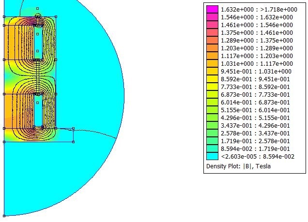

I guess your magnetics circuit is axisymmetric (like most drivers), so the correct setting would be exactly that: "Axisymmetric". "Planar" is more for planar drivers, like ribbons or magnetostatics.

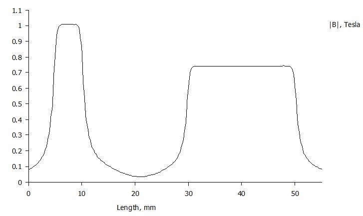

Thanks I redraw the magnetic circuit in FEMM axisymmetric and now i got a more realistic B value. 0.9T for the long gap 1T for the smal gap. But this looks oke for a good motor.

You should show the axi-symmetric plots since the planar ones that you have shown will be completely wrong.

This is the correct simulation. (I changed an example of Femm itself, now it must be correct)
Maybe using a shorten ring. Would it be possible to use a very thin insulation between the structure to prevent some distortion?
In this case I have a BL of 11Tm. DCR is 10ohm (1cm high coil) so i have to use parallel winding (DCR drops too low) or thicker wire. Is there a better solution, or what is the best solution to maintain the strength and get 6ohm DCR?

Interesting motor, why do you need so much Xmax for a midrange tho? You could shorten the gap and increase B pretty much.
At first it will be a mid. But afterwards I'm going to try to extend it to a mid-sub for two way speaker systems (with high lineair excursion)

If I make the outerdiameter smaller this would saturate the structure. Would it be a good solution? Saturation of "normal" steel is 2T?
It's not that hard to simulate...
