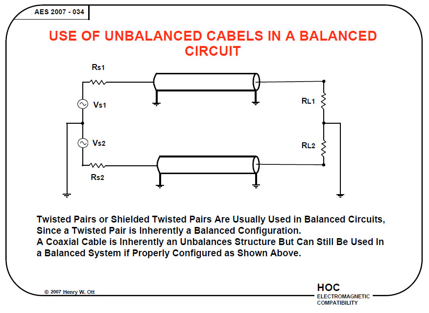

Suppose two different arrangements for balanced differential connections: 1 - four BNC 75 connectors with four coaxial cables; or, 2 - two twisted pair shielded cables with two XLR connectors.
Are they equivalent? Is the first arrangement acceptable?
You can use two coax's as a balanced interconnect.

Generally the whole point of balanced (or differential) is to have a twisted pair carrying the two signals in very close electrical proximity. The point being to limit the effect of any ground noise/bounce on the signal.
