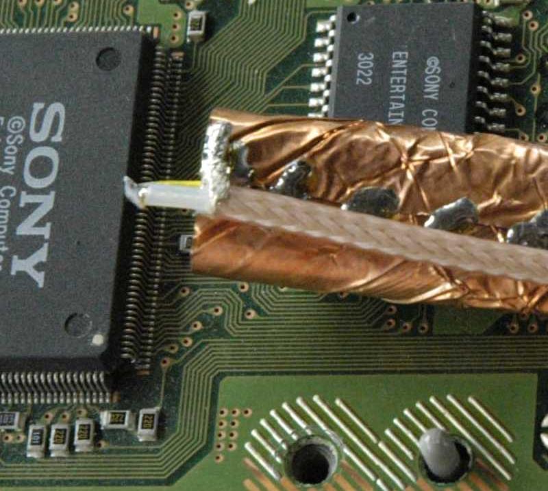

Don't bother with shoelace based interconnects.
Use normal RG59 or teflon RG179 for your interconnects. The highly regarded ICs all have low capacitance. 75 ohm coax is ideal. It's screened and has similar specs to the shoestring cables with the added benefit of costing cents per metre and being ready-made.
I've used teflon insulated RG58 equivalent (50 ohm) and it's too stiff and the capacitance is slightly higher than 75 ohm coax.
Even better are car stereo antenna extension cables, these are 93 ohm coax with even lower capacitance. The downside is the inner wire is so fine it starts making termination difficult.
RG179 is nice and thin and being teflon insulated can be very enthusiastically soldered. Here is a bit used for a PS mod on a screened capacitor.
