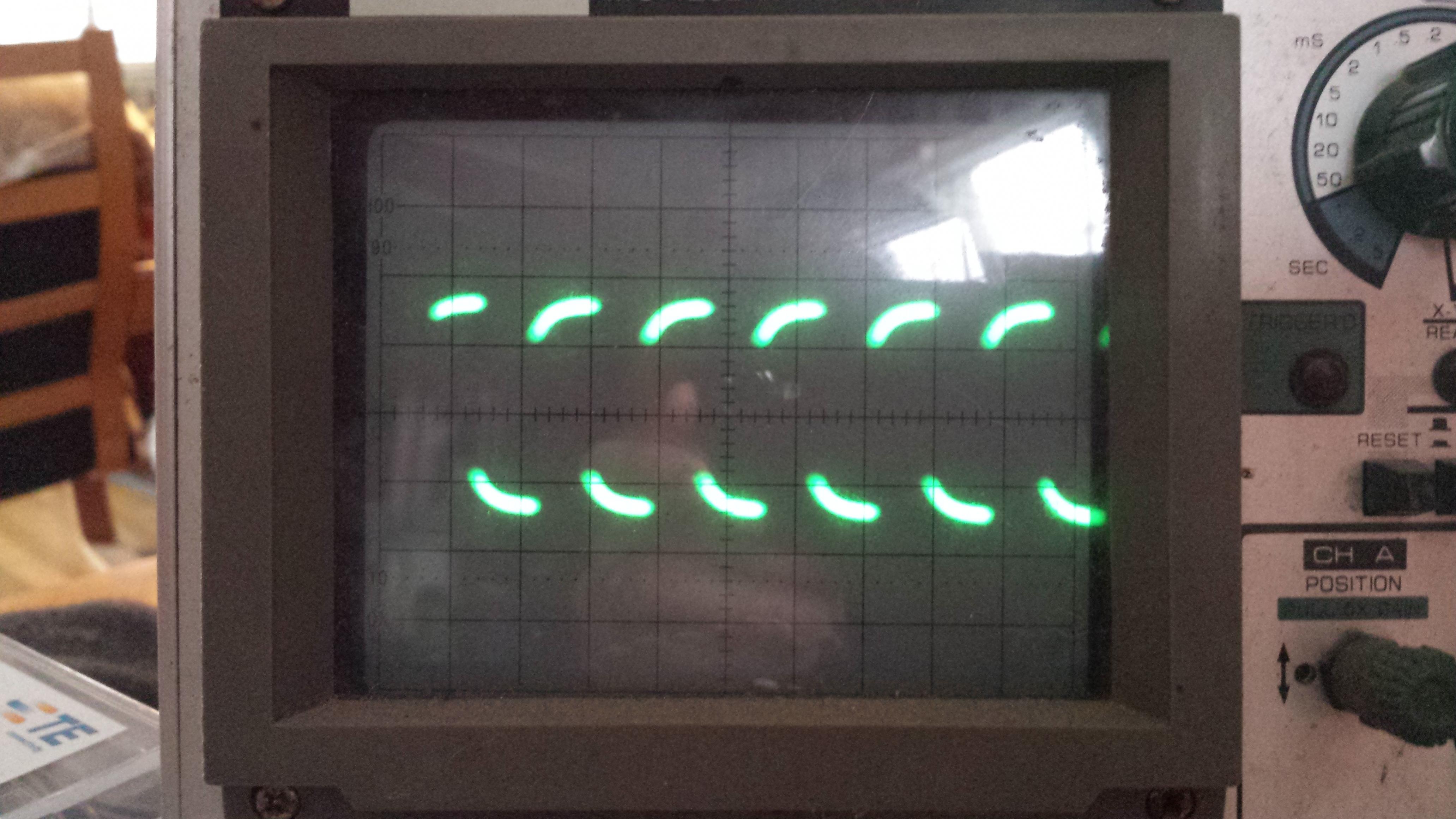

So I'm thinking my scope my be broken, this is what I get when I try the onboard .5v peak to peak square wave generator. What is the possibility that the onboard test function has failed and it's not the function of the scope? Is there another good way to test out a scope?

There is no problem whatsoever, you just need to adjust the probe in x10 setting. If you have a closer look, you must see a slot on the probe body, that you can adjust with a screwdriver until the top of the waveform is flat.

I guess I need to finish watching that scopes for dopes video, I'm only about half way through. I apparently didn't make it up to probe calibration section. Thank you your help that worked perfectly.
