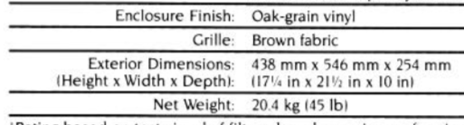

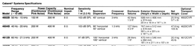

40L, 20 L per driver sounds about right if it the size of the 4612B, built from 19mm (3/4") plywood:The 4612 cabinet is 40litres.
Funny, they list the 4612B as only 28L.
The 4612OK (Oak grain) is near the same dimensions other than lacking the Cabaret corner protectors:

I have seen no response graphs of the "original 4612 vented enclosure" or the 4612B.I cannot understand why JBL used that size but don't publish it and how it performs in their literature. How is the smaller recommended size enclosure ever going to deliver the bass of the original 4612 vented enclosure?

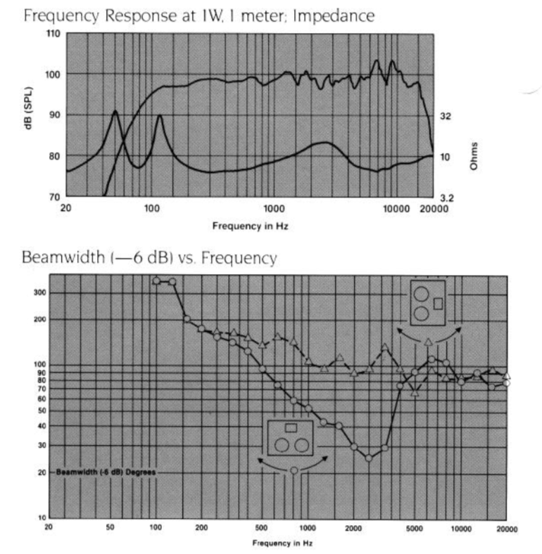

The 4612OK Fb is 80Hz, as can be seen by the 8 ohm impedance minima between the two lower 32 ohm peaks.
Response is more than -10dB down (useless..) at 60Hz. These cabinets were not designed to "deliver the bass", even in the 1970's.
The (near) equal impedance peaks and flatter low frequency response than the 14L box are a result from the higher tuning, and perhaps somewhat from the 4612 larger baffle size.
The horizontal cone orientation shows the -6dB beamwidth (dispersion) dropping to ~25 degrees at 3kHz, compared to 100 degrees with the cones vertically oriented.
The midrange is "cancelled" off axis with the cones horizontal.
Using pink noise as a source, the cancellations should be very obvious when walking from side to side in the coverage area.
Room EQ Wizard has a pink noise generator.
Using a microphone and the software's RTA also would allow you to see the changes you hear in real time.
