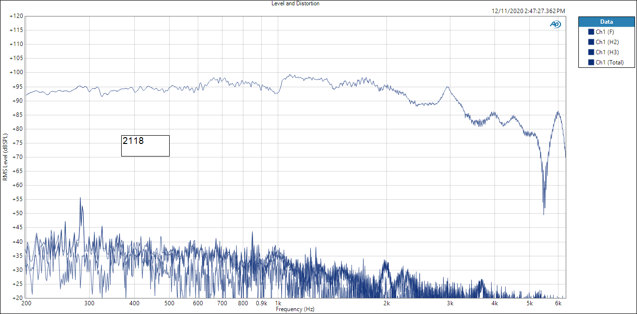

The good news is I got four very nice 2118 midranges that look and sound to be perfect at still reasonable price.
I am now looking at tweeter options. I have a CNC router so might try one of Joseph Cowles bi radial horn files or a ring radiator. Open to hear suggestions...

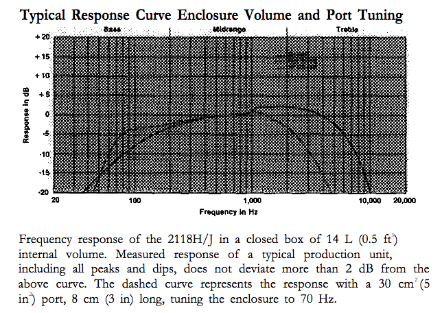

Depends on what crossover range they cover and how loud you plan to listen.If I was using these drivers in a new enclosure as part of a 3 way what do you suggest I do? Use a similar ported enclosure?
JBL's response graph gives you an idea of what to expect with just 14L per driver:
If volume isn't top priority, I usually opt for sealed for its better transient performance in the woofer to mid range transition.

Just showing my ignorance here but how would it go as a 2.5 way with the higher channel in a sealed 15l and the lower channel in the ported?
Another question... Why does the ported enclosure roll off so much earlier than the sealed?
I have ordered a Celestion CDX1-1425 Neo and paid for the Joseph Crowe matching horn CNC file which I will make. Horn Lens No.2332 Looks like sensitivity in that horn and frequency range and dispersion should be promising with those drivers.

I am sure that a clever & smart member WILL respond clearly & concisely regarding your question about 'Ported vs Sealed' roll off.
When the two woofers have different rolloffs through the bass, they will compete with differing phase. You may lose out this way.how would it go as a 2.5 way with the higher channel in a sealed 15l and the lower channel in the ported?
