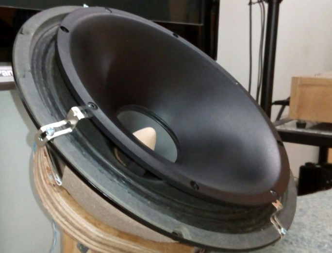

Let's say a 11" effective diameter, it will start to beam at about 700Hz ?

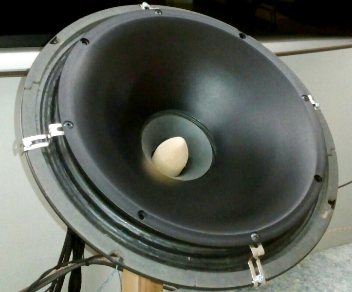

After I dismentled the system based on Oris 150, I used 8" mid on OB + 8" HF WG for mid-high. That was a clear step-up in imaging. However I miss the dynamics so much more. That's why you read the 12" midrange story here....
When I changed the 8" mid to this 12" one, I did lose some of the imaging quality. But I can live with that and am very happy with the dynamics gain with this bigger cone. Well, that's for me. 🙂
Ideally, a bigger 'tweeter' which can play down to around 1kHz must be good. That has been one of my 'future' plans....

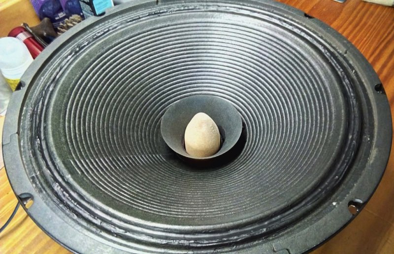

sure looks like fun - there should be more guitar speakers - I have an ancient University UC122 12" , fs ~100 - might have been lower when new, has nice mids and top in a Karlson Twelve without any "helper" tweeter - like an idiot I ripped the whizzzer shortly after this picture

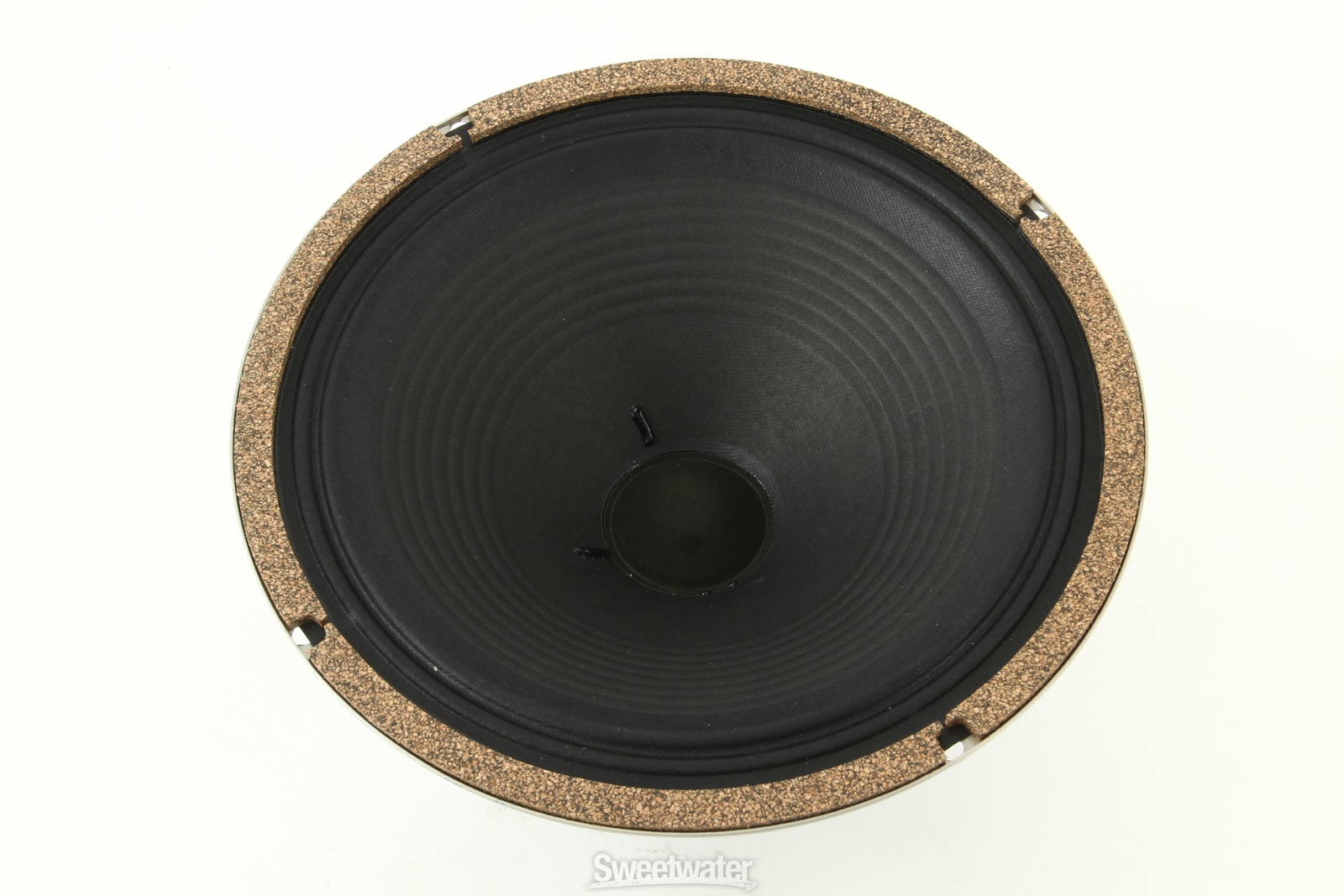

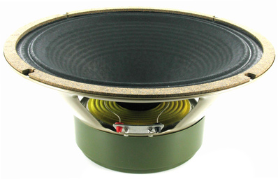

Celestion Heritage Series G12H(55) looks interesting.
Has resonance at 55 Hz which is lower than usual for 12" guitar driver.
High sensitivity, too.
Crossing below 2 kHz could potentially make a great midrange.

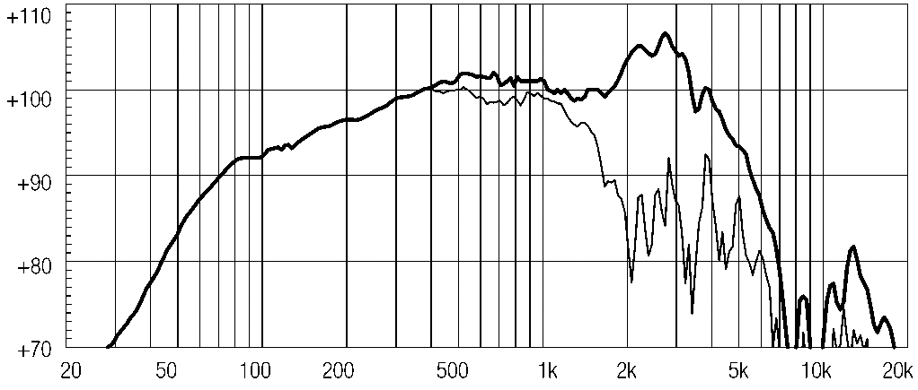

I just tried the 10" eminence ragin cajun as a mid between 400 and 1300hz. Sounds much more open and transparent than my high sensitivity low mass 12" PA driver in the same range...
Can someone shed some light as to why? The 10" has nasty looking csd's compared to the PA driver yet it sounds smoother and cleaner. I don't understand.

What is the model of the PA driver you compare with ?
Explanation... I would also like to find out. Maybe we can start out by comparing measurements of the two at first ?
The model is eighteen sound 12MB700 but I also have others laying around. I'll have to do some more comparisons but I know none of the PA drivers match the guitar driver in clarity.
I'll get some measurements up as soon as I can.
