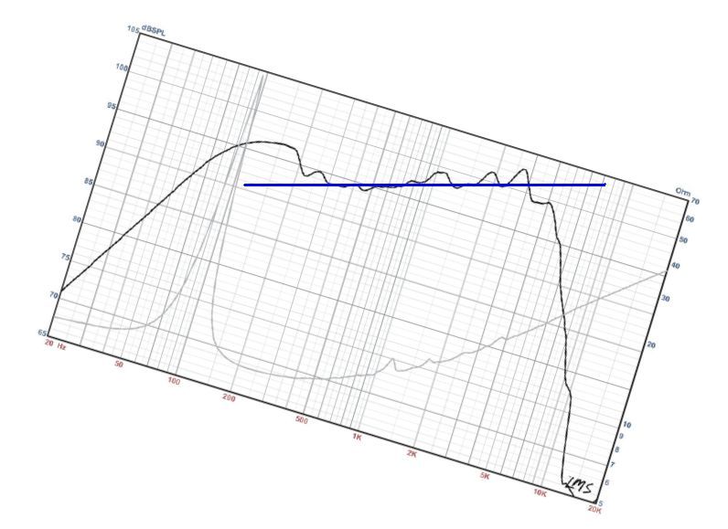

Elias said:An externally hosted image should be here but it was not working when we last tested it.
I just love that looks 🙂
http://www.eminence.com/pdf/legend-1028k.pdf
10dB mid peak is evil for HiFi though 🙁

The straight cone prolfile might be a double sided sword. I like its directness and dynamics. However the breakups must be controlled for hi-fi use. The corrugated press might help a little. And my later PVA glue treatment and phase plug give furthur improvement. (which can be proved by impedance scan and RTA measurement)
In my application, I don't worry about the Xmax at all. 12" midrange is just so loud with so little moves. With the help of 160Hz high pass, I think I won't have any chance to use up the 0.5mm Xmax.
By this I also found an interesting thing when I cut the dust cap -- I have to push the cone forward (from the back) by about 3~4mm to see the voice coil protruding the pole piece. From the thickness of top plate, it's impossible to be an under hung motor (and by that large of travel). I'm wondering whether the voice coil is un-aligned or the center pole piece is higher than the top plate. I can not disassemble the whole driver to examine this.
A similar condition appears on my 18" woofer of the same brand. The voice coil protrudes the pole piece by only about 1mm. And the published datasheet shows 6mm of Xmax. I can't tell whether it's bad alignment or the long pole.

Hi tinitus,
Thanks for the good tips. Will do.🙂
But I can't follow the 2 methods about dust cap. The caps on my drivers are removed anyway. And I inserted a phase plug in the hole, so it seems no space for that...
Hi gainphile,
It's actually not that bad. I often listen to them far off axis -- almost at the side. It seems not a good idea for a pair of OB speaker, but it's no problem maintaining very good tonal balance 😉 In such listing position, only the quantity of bass is slightly reduced, no big deal. The sound is always filling the room and evenly spread everywhere in the home -- no that kind of "boom in next room" effect thanks to dipole.
I guess 2 things help: 1 is the cone is far from ideal piston, so the 'effective' area would be far smaller (and the phase plug might help a little here). 2 is on the open baffle, the 'beamwidth' of mid to lower mid is also relatively narrow, so the beaming at higher frequency might not be so obvious.
Hi gainphile,
