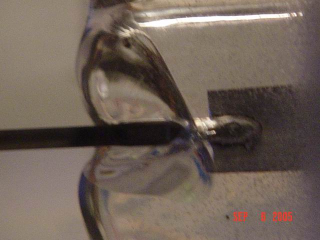

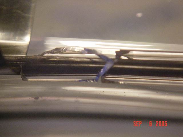

I receive Ushio 250w bulb but it is some broken piece glass inside and I loot around the bulb seems it is from the glass tube from the internal wire, I am wonder is that ok to keep use this bulb?

Yes I believe the beads(crack) in the lamp is from the arc tube but how come they put that weak glass tube on the arc wire"some of the bulb doesn't carry that glass tube" and I check all over the inside glass of outer glass envelope there is no damage but you are saying the the arc tube beads will vaporize after while? so what about the rest of arc glass tube?? are they going vaporize eventually? am I right?
post a picture
I'm sorry, but I don't understand what you mean by "some of the bulb doesn't carry that glass tube". I suggest you take a good picture (or two), and then post it here so we can see what your bulb looks like.
defective lamp
That lamp is defective. The part that gets the most thermal strain is where the wire passes through the arc tube glass. Every time you run that lamp, more glass will break off. Very soon, the seal between the wire and the glass will fail. Then the hot gas in the arc will leak out into the outer envelope, and the arc will stop working. This could happen in just a few minutes, or the whole thing could explode before it happens. Do not run that lamp!
