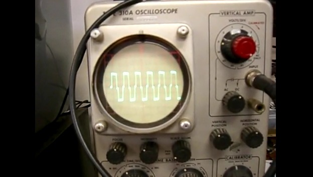

It is true. Five minutes with a tube amp and an oscilloscope will convince you that this is so. Not sure what SY was getting at, but if you clip a valve amp you will (nearly) always get a softer transition into the clip than a transistor amp will give. In other words, the edges will be rounded off where an SS amp gives sharp edges. NFB may make the clipping harder, but as far as 'fair' comparisons are possible, valve amps clip softer.
When a push-pull tube amp clips, it clips just as hard and just as symmetrically. The transitions are sharp and full of higher order harmonics. I'd post a scope picture, but I'm 1500 miles from home at the moment...
Now it IS true that single ended circuits can be designed to have their even order distortion rise faster than odd order (non-symmetrical). However, this is not specific to tubes- you can see the same effect in single ended solid state amps.

These (attachments) are from guitar amps that are usually designed for more softer clipping at expense of THD figures. The first is a tweed Fender, second a Satellite "boutique" amp. Still... rather hard clipping.
Few more...
Push-pull 2A3 amp, medium overdrive:
SS devices, extensive overdrive:
