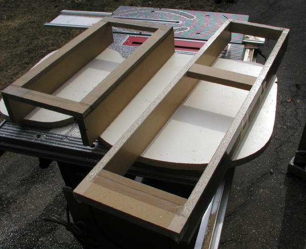

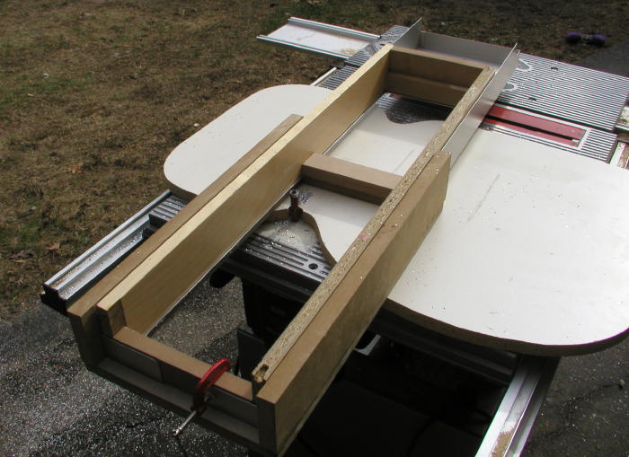

The objective is to cut the opening in an aluminum panel (8"x 36") to create a display unit. Aluminum thickness is 1/16". The cut out has to have perfectly straight edges, be very accurate and there are 12 units to be done. It has to be done using ready available tools at home, preferrably in one day. Any ideas how to go about it?😉

Tricky. Soft edges means "nibbling" tool will cause uneven edges.
Tools readily available at home? Depends on who's home we are talking about...
I would test by building two identical frames in hard steel with inner dimensions as the required whole. Clamp them hard with protection to each side of the plate (and properly aligned). Now use either through-hole saw or home-made sharp punch style hole-maker run along the edges of steel frame finsihing of edges for straightness and some smoothness before finishing without frame clamped. This COULD MAYBE give straight edges and an even plate without a potato chip flatness appearance.
You wanna do 12 in one day?
Whew... The only way I can think of to do this quickly and get nice edges is to toss them on the mill, but who has a milling machine at home?
I've often wondered if one could improvise a mill by putting a cutter onto a drill press, and setting that sucker up at it's highest speed... with thin material, it might actually work... ? I imagine you could plunge the cutter through (or pre-drill the corners), then run the part along a fence like you were using a router table. If you don't need to plunge through the material, a 4-flute cutter would probably do a nicer job than a 2-flute, and should work better at the lower speeds too. Just be careful to keep a firm grip on the thing! Additional safety fences and stops may be required.

jag said:
For when the God himself seeks help from mere mortals
Actually I was teasing you guys a bit to grow some interest before I post technique.
Chris, I believe you don't have any connection with the "company" what so ever, otherwise you wouldn't recommend the product. (just couldn't resist the joke)😉 While Rotozip might be good for some jobs, I grade it at the same level as Dremmel tools which means light hobby tasks.

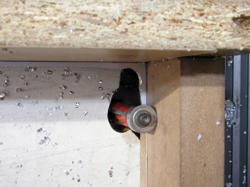

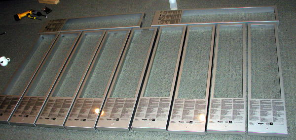

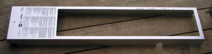

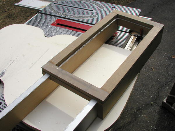

UrSv and hifiZen were on a right track because both forms and router were used. Here are all 11 of them, done in 6 hours.

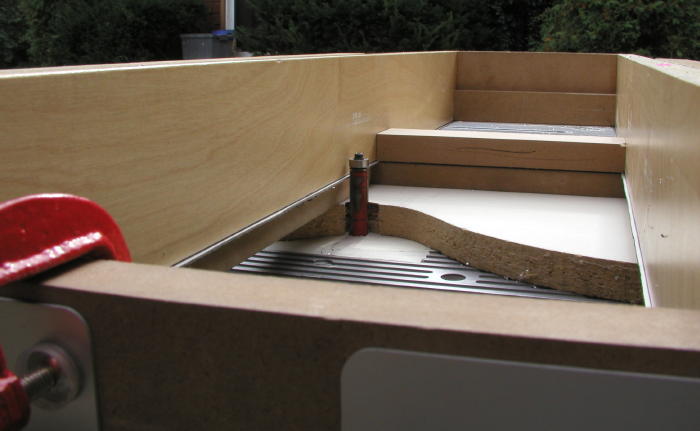

Because those covers suppose to be used in commercial display units (at the shows) so everything had to be done to the highest standards and material shouldn't get scratch in a meantime. I decided to make some forms out of particle board and MDF. The forms were used both to draw the cutout outline as well as the guide for the router bit. Also as a protection when cutting out the hole with a jigsaw and moving the piece on a table.

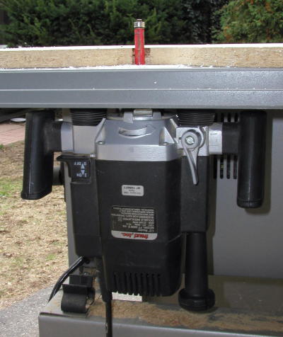

And here is my trusty router. I have it mounted permanently on Ryobi table saw. Comes handy any time.

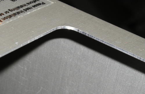

I was thinking about routing around the edge and knowing your feelings for the "edge trimmer" bit I should have guessed. As for the jig-saw I suspected it might have too much ripping action to actually produce a nice edge but when used at a distance from the finished edge and combined with the router it seemed to work out nicely.
