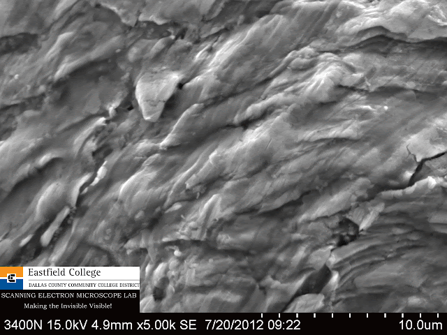

How do speaker cable companies determine the directionality of a 100m spool of cable?
By looking at the surface texture of the copper strands?
At 5,000x magnification, we can see the striations created when the wire was drawn through the sizing die.
So there's your directional difference.
The poor little electrons find it harder to clamber up those jagged striations than to slide down them!
There's something else that requires effort. Back to the really interesting bit, you say, as an engineering fact:I suppose in a pinch one could always listen. But of course that requires effort.
This is very interesting, since I've never measured any voltage drop with the wire 'in different directions' myself and to the best of my recollection, I've never seen this statement made before either -since the signal is AC the idea itself seems a bit peculiar. Either way though, I'm always willing to learn, so again, could you please point me (us) to the information showing this difference?There is slightly less voltage drop across the wire in the ”correct“ direction compared to the other direction.
