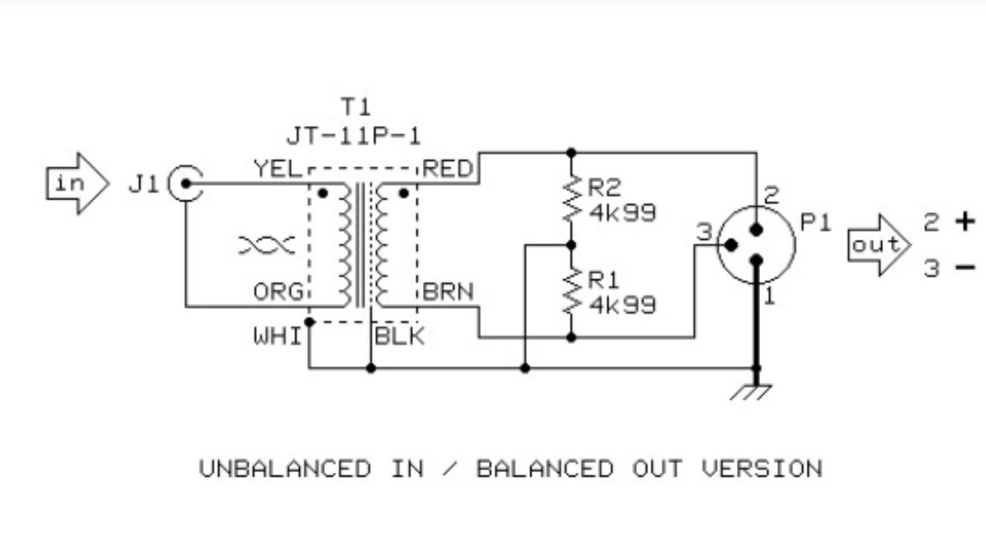

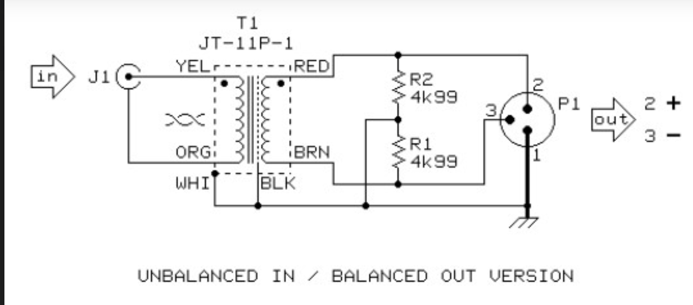

After extensive searching in Google images, I came across THIS schematic, which aI believe is THE ANSWER, using a voltage divider/splitter (two ~5k resistors) across the output and tying the center point to can/gnd & screen to get what appears to be an effectively balanced three lead loutput from the JT11-P1, being fed from a two wire unbalanced input: 😎
Any comments on this configuration? 🤔

It occurred to me that this symbiotic matching of the transformer to my amp might be upset by the use of the two ~5k resistors in the diagram. Together, don't they put another 10k ohms in parallel with the amplifier's 10k input impedance reducing the load on the transformer outputs to 5k ohms? If so, how might this affect the system (i.e. frequency response, etc.), and could larger value resistors be used in that place?🤔

With the centre tapped resistors the transformer secondary will be double terminated, seeing 5 k across it. Without them the secondary is still 'balanced to ground' by the amplifier input stage.The 200asc amp specs state that the input impedance is "10k ohms"

As rdf says and the DTI circuit confirms, this should work with or without the centre tapped resistor network.
You can experiment with those two scenarios and even with larger resistors. After all, that is the fun of diy! 😉
Presumably the amp has a 'regular' active balanced input rather than a Hypex style floating instrumentation approach. If that's correct you can visualize the amp's input electronics as two normal unbalanced inputs each with resistors to ground, one input inverting and one not. In that case adding external resistors just parallels resistors already in the amp without in any way altering the circuit topology. In decades of studio work the wiring shown in your first post typically worked fine.

I'm most attracted to the balanced nature of Jensen's "center-tapped" symmetrical voltage divider and keeping the specified values with the resultant net impedance of 5kohms, would that tend to result in a frequency rolloff, and if so within the audio band of 20hz-20khz? (Again the amp has a specified input impedance of 10kohms).

😎Okay. I think I figured it out. Did my homework, using Ohm's Law and RC filter theory.
With the specified 5k resistors for R1/R2 in the center-tapped voltage divider, and using my DSP unit (1Vrms max/10k output impedance) as the source, it would result in, worst-case, a signal voltage drop of 4.5dB, and a high frequency rolloff below 20kHz.
Changing R1/R2 to 50k ohms would give a net load of just over 9k ohms. The signal voltage drop is now closer to 3dB and the hf rolloff is pushed above 20kHz. Also, we can omit the damping network due to the load impedance.
Connecing the red & brown ransformer leads to my amp's "+" & "-" balanced inputs, respectively, then the black & white transformer leads to the center tap as well as audio ground. Done. (?)
Unless I may have missed something, by substituting the 50k resistors, I should be "good to go" (provided the 3dB signal loss is found to be acceptable).

10k source impedanse before the transformer? The Jensen spec says <600 ohm. Page 10With the specified 5k resistors for R1/R2 in the center-tapped voltage divider, and using my DSP unit (1Vrms max/10k output impedance) as the source, it would result
