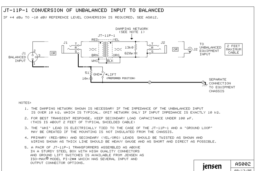

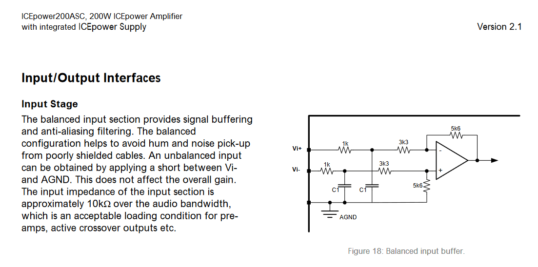

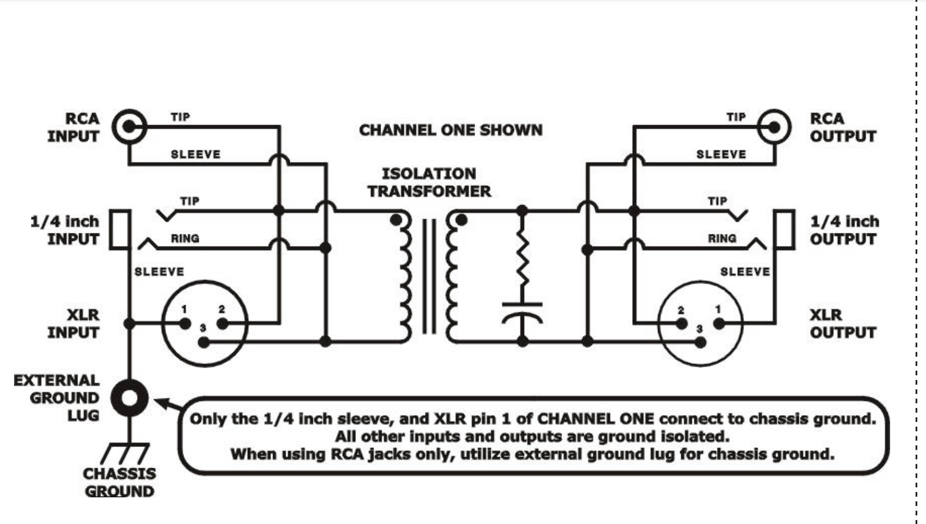

Use of transformer for unbalanced RCA to Icepower balanced input

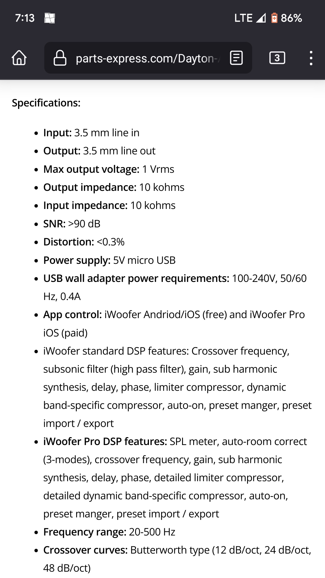

The DSP is very unlikely to have 10k output impedance. Which one is it?
Thanks for the responses.
I 'm using this for my woofer amp below 500Hz Dayton Audio DSP-LF :
But Strange. Maybe a misprint?
I would not worry to much on HF roll off at 20k either as the target is sub under 500 Hz.
