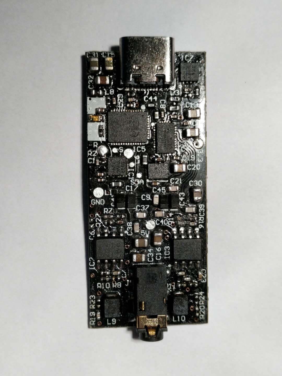

The SAM D21 and PIC32MX270F256D both come in fairly compact yet hand solderable packages and have i2s modules that are probably capable of USB audio. I believe the dragonfly USB dacs use the PIC but I don't know of any projects that use the SAM as a USB audio bridge. I am inclined to try the SAM with the arduino ide but I don't know if the two are suitable for the task.

nofun, you are right. I also saw pic32mx as USB/I2S here: https://www.cyrusaudio.com/wp-content/uploads/2017/11/Clean_Top_view_soundKey-2000x1335.jpg It is compact and super-cheap(if not to say extremely cheap, 1$ pic32, $1 PCM5102, $0.5 TPA6130A2RTJR, and even 3.5mm jack isn't gold-plated!). However, it is only 24/96 and probably has awful jitter because the device specs are way worse than Ti's DAC used there.
PS: Oops, dragonfly red looks quite similar Review and Measurements of DACPort HD and Dragonfly Red | Audio Science Review (ASR) Forum
So, perhaps PIC32 without any clock makes a really bad job. BTW, I measured with AP2702 my old $300 chinese android Nubia Z11 with AK4376 3.5mm output with 1kHz 16/44.1THD+N .0015%(16bit theoretical limit!) SNR -118dbA, power the same as dragonfly/soundkey and similar. I really believe that any old iPhone with 3.5mm or Apple's USB/3.5 adaptor will outperform these DACs in an effortless manner.

I tried PIC32 for USB/I2S and I failed. I didn't get even to the USB initializing ... it just didn't want to communicate, to compile and upload the code went smoothly, sadly there it ended.

IVX it looks like the PIC might only be capable of generating its mclk by pll. The samd21 can operate as i2s slave so jitter could be much better. UAC1 should be possible with the sam but i doubt uac2 is. If there was some functional code around i think the pic or sam would make a fun diy platform despite the limited performance. I'll give the samd21 a try but I'm not expecting anything soon if ever.
That soundkey dac looks impressively cheap, from its measurements the tpa6130 and ceramic coupling caps at its inputs might limit the performance more than the pic. It also looks like the tps either shares the ldo with the dac or it just runs straight off the usb supply. I don't see any chokes either.
To make BOM cheap and keep performance great is the kind of art but make cheap junk, not a big deal )) When I chose 2.5mm jack and saw gold-plated one for 5 cents, I didn't check how much nickel-plated one - no reason. How many units need to sell to get a serious profit from 5 vs 4 cents BOM difference? I think it is ridiculous, if not to say shameful economy ))
