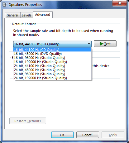

The first one will give you only 16/44.1. The second will do somewhat better. For about ten bucks more, you can get a USB to spdif converter that will give you 24/96. That will cover most of the available software, but if you have any 24/192 files, you'll have to spend more. The Ebay cheapies work as well as anything else for the application. Pano and I have checked out several of these and only found one poor performer so far.
This is the one I'm using (price has gone up a bit since I bought it, but still pretty cheap):
USB Port Mini Converter SPDIF Coaxial Output DAC | eBay
They're sparse with the specs, but I routinely use it for 24/96.
Quite sure the PCM2906 it uses can't do 24/96.
Try outputting using KS to confirm.
Or, for Windows Vista and 7, check this screen for the available choices.
